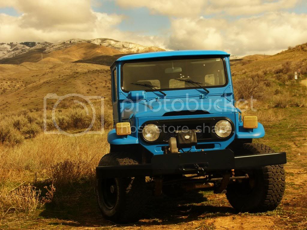

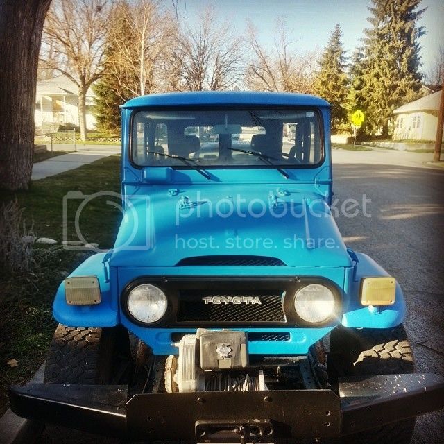

There isn't a lot of talk of Plastidip on these forums. I've been researching it for awhile, and thought it would be a pretty good solution for my situation.

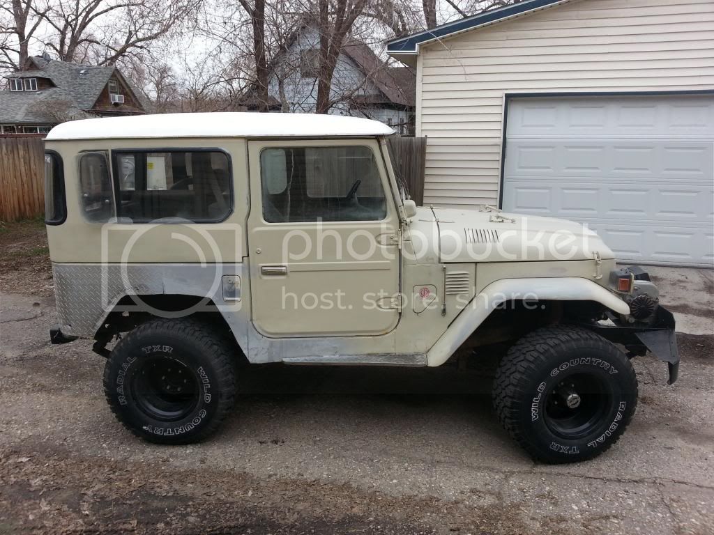

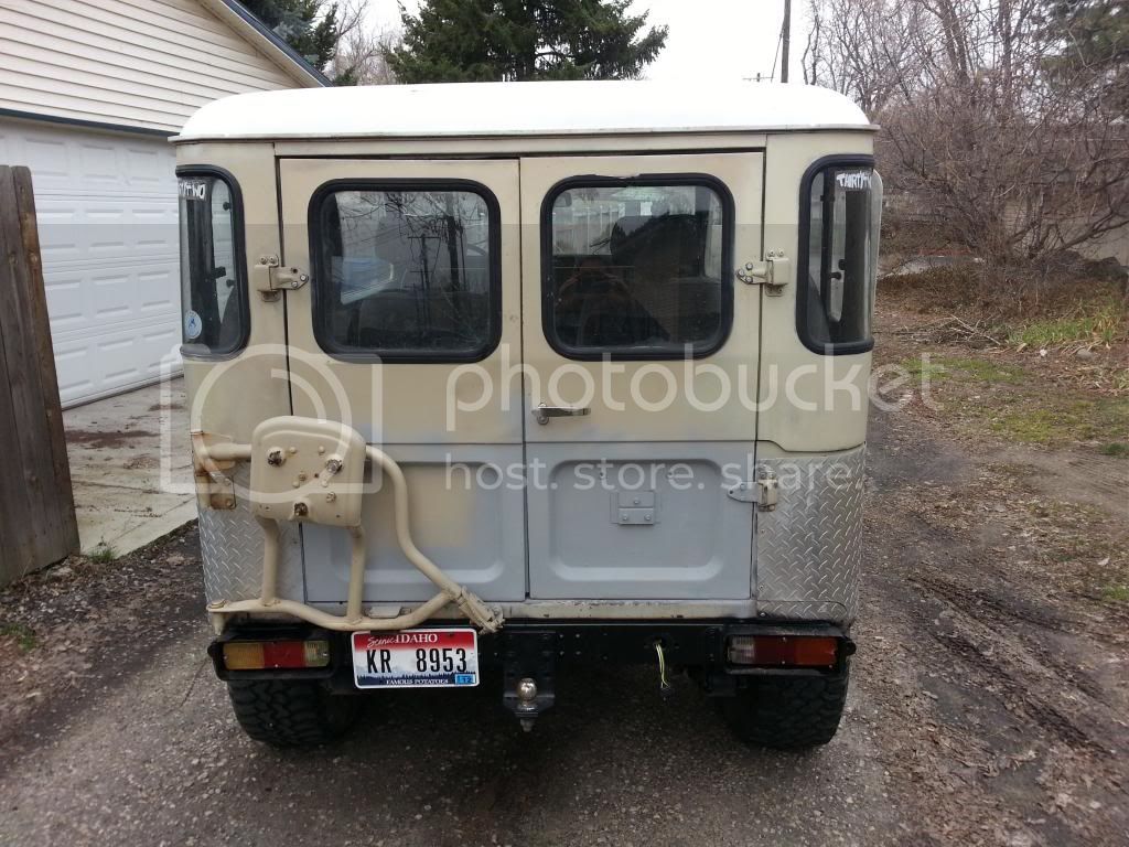

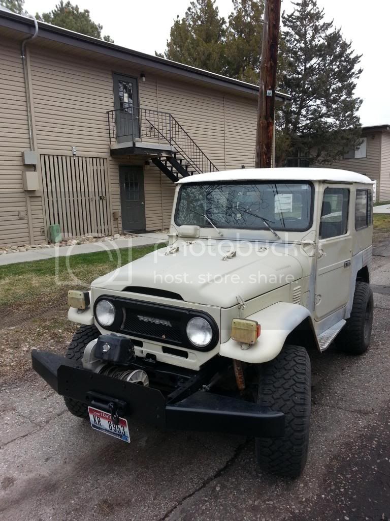

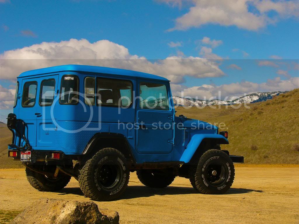

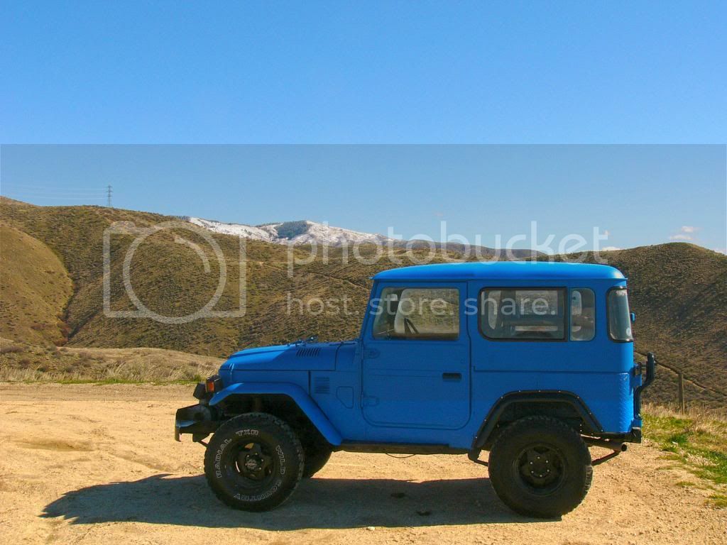

Some ungrateful clown PO before me decided to rattle can paint the car and couldn't be bothered masking off anything. It looked like ****. There's overspray paint on the glass, rubber window trim, everywhere. I'm looking at a 2.5 - 4k price tag on a paint job, and that's just not realistic for me right now. With the way it looked, there wasn't a ton of satisfaction driving this vehicle and showing it off at all (see the before pictures below). The aesthetic gain has been huge. Absolutely worth a $300 investment into plastidip, and a very nice bridge to a paintjob down the road.

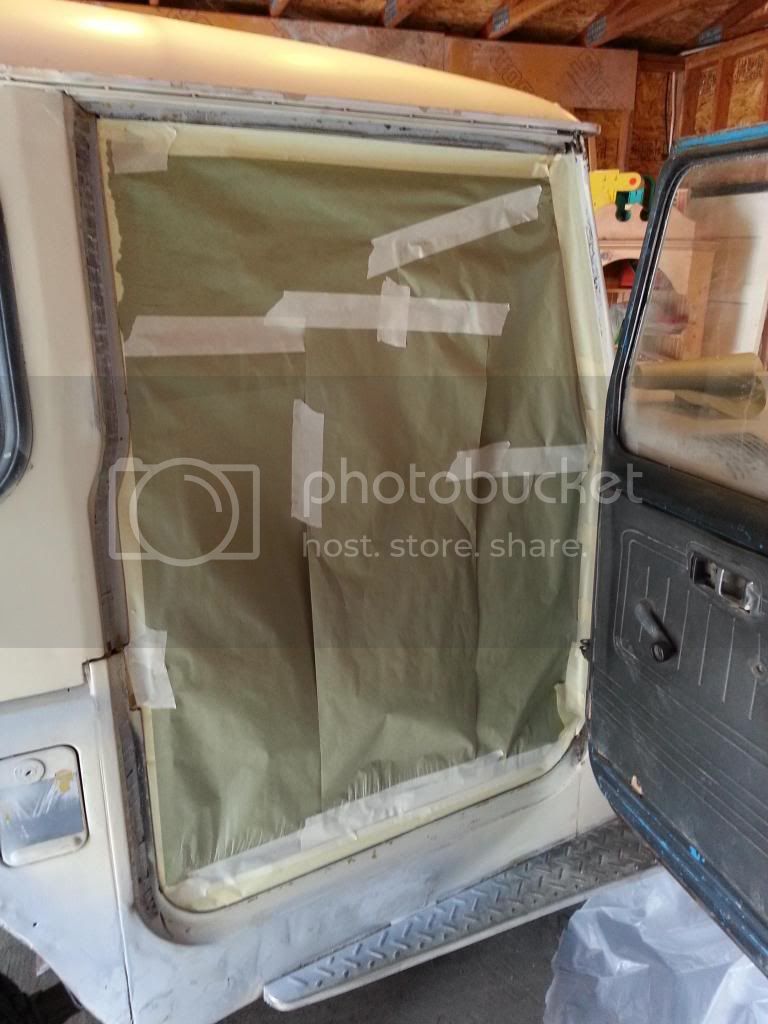

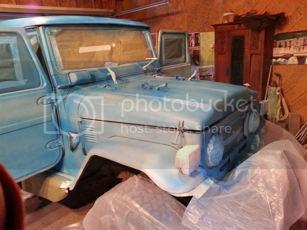

What did you do around your trim?
If you mean the rubber window trim, I taped it off. I gave this subject some thought and asked around some forums as well. There are a few ways to do it that work, but taping's the way I went. Very time consuming. Also, due to the overspray paint all over the window trim from the PO, I did the whole process all over again, taping around the tape after the Plastidip cured so that I could color the rubber trim to take it back to black again..

I spent around $275 for 5 gallons of dip. I only used 3 and 2/3 gallons. So I could have ordered 4. If anybody is reading this and considering dipping and FJ40, 4 gallons is plenty. I could have saved about $60 there. I think with shipping included, I paid $315. And again, that was with a gallon I didn't need. One thing to note, a sprayer is needed. Some people have access to sprayers so it's not a big deal. I actually went in with 2 other friends and shared the cost of a sprayer last year during DYC's Black Friday Sale. We all had plans to dip our cars, so it worked out well. A standard sprayer works well with plastidip, and the one DYC sells (that we bought) is highly regarded.
Did you do cans or did you buy the kit?
As mentioned above, I used a sprayer. Using cans to dip a whole vehicle would be a nightmare with poor results. All I bought from them was the sprayer and plastidip. No kit. They included a paint filter with the dip, as well as stir sticks. And the sprayer came with a mixer for a drill. None of those items were expected, but all put to use. You don't really need the other things that come in the kit like the microfiber towel or the pre dip spray. I prepped my FJ with a 50/50 mix of alcohol and water, which is common for these projects.

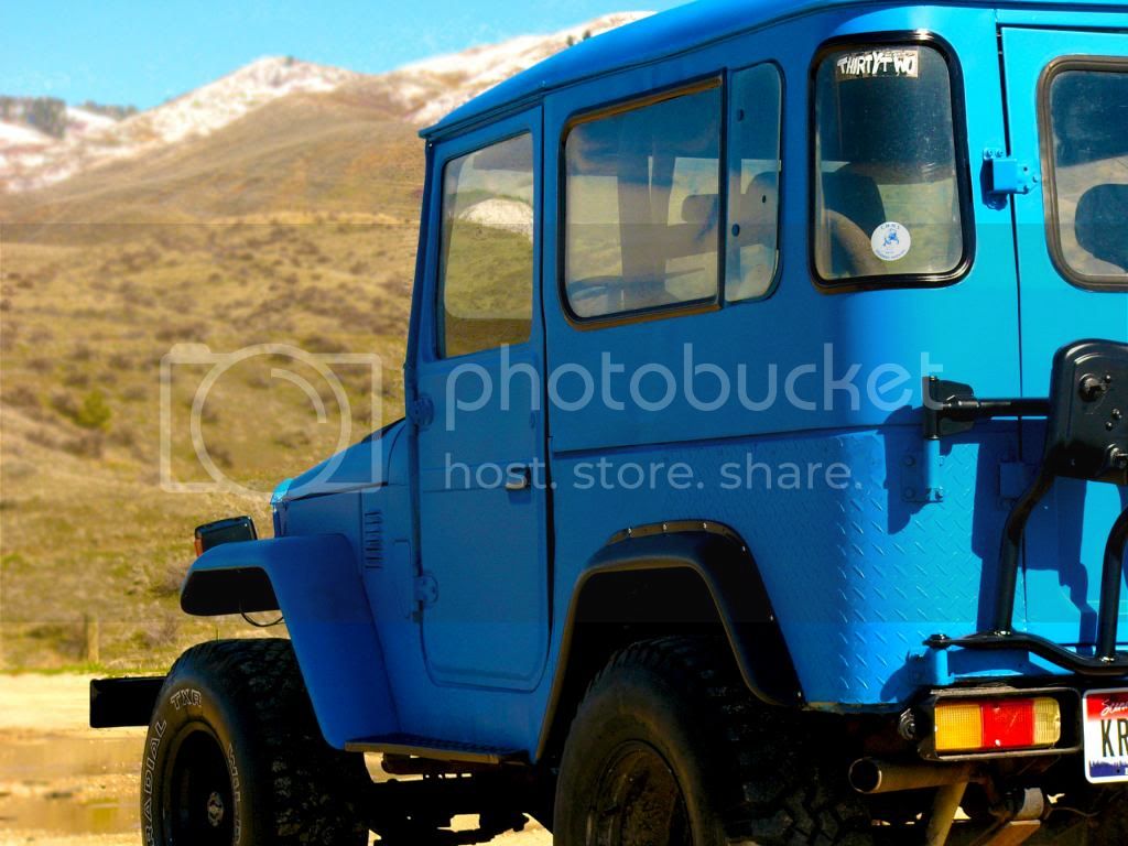

I did 7 coats. The last 2 were arguably unnecessary. The first coat should be light, but the rest should be heavy. You will get a feel for it once you start doing the coats. I was going too light on coats 2 and 3 before I realized it works well to really lay it on. You want to go as heavy as you can without runs. I never came even close to runs, while going quite heavy.
It's really pretty interesting stuff. The body of my FJ was pretty F'd up. The plastidip has a really nice self leveling quality that smoothed out a lot of issues that were much more visible before. It also re-liquefies previous layers on each coat, so it's a nice smooth, even finish. One thing I've had problems with in the past using other paints is getting texture. With the plastidip, you spray close and lay it heavy and it comes out nice.
A couple other comments on this stuff. I think people assume it's going to feel rubbery. It doesn't. It took about a week, but now it feels like a standard paint job. People also expect it to be temporary or fragile, or expect it to peel. There are people that have shown pictures of cars that have been in pretty serious car accidents, and it has held up surprisingly well. Yes, you can peel it off at any time, but once it cures, it doesn't come off unless you make it come off. Also, it's ability to be touched up is pretty unique. I've had a few problem spots that I just reliquified using thinner to fix. You can do this with dings, bubbles, texture, runs, etc.
