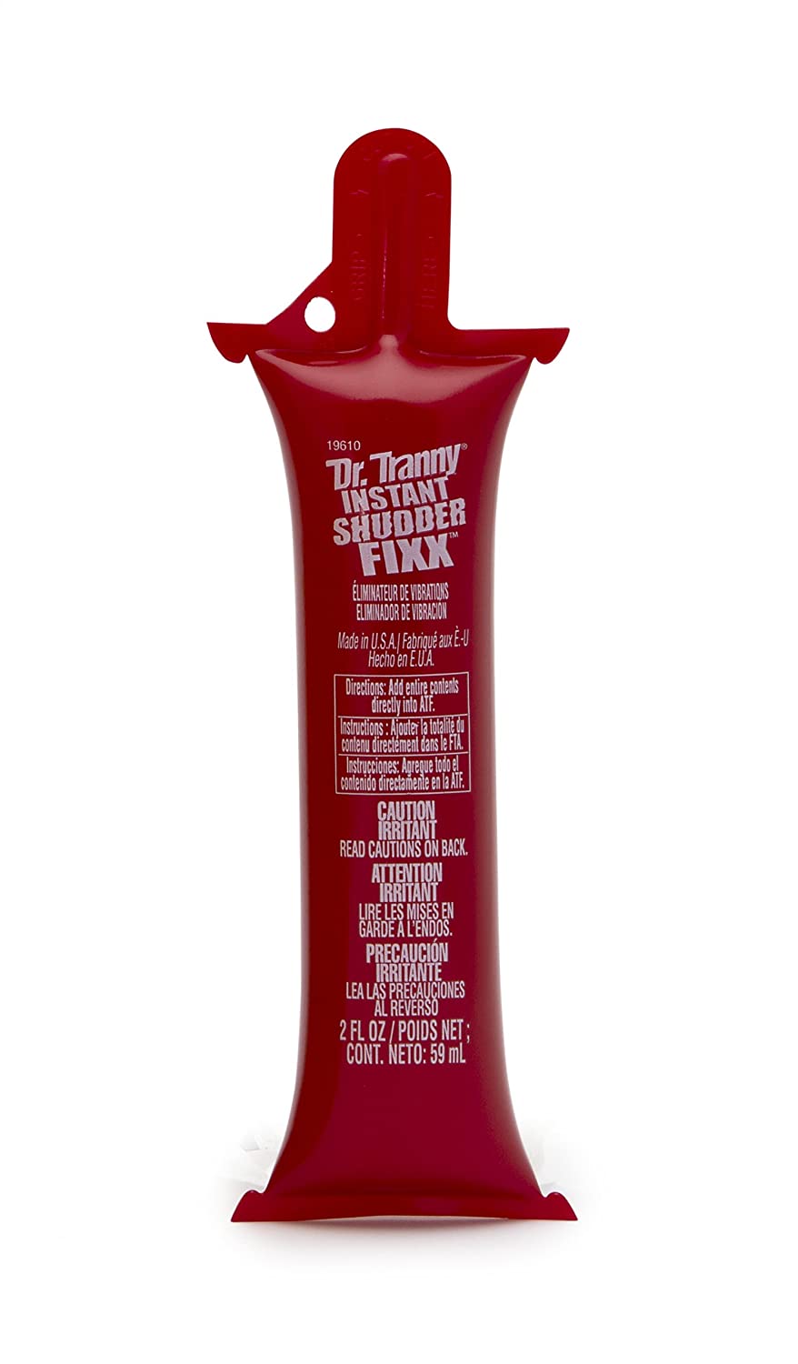

Interesting, thanks for the heads up!There is a fix for shudder other than a new transmission.
Amazon.com: Lubegard 19610 Dr. Tranny Instant Shudder Fixx, 2 oz.: Automotive
I thought that dr tranny shudder fix picture was a joke?
