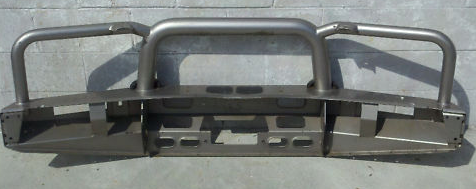

A few months ago I purchased an incomplete TJM T-15 (steel) bumper for an IFS 100 Series. I got it from a Mudder that goes to AU on business and sources parts. Ever since that time, I have been trying to source the correct parts to make it complete. I currently have Tacoma bumper ends on it that I have rigged to almost fit using washer stacks to open up the spread on the ends so that they clear the fenders (Ghetto, I know). This is my dream bumper and the only thing left on the list are the turn signals, bumper ends and rubber spacers that go in between the bumper and the bumper ends....and perhaps frame to bumper mounting brackets (one of mine is a little mangled).
I'd be ecstatic just to get the correct bumper ends
Can anyone help me out? If you have access to these parts or can connect me to a source that can get me these parts I will definitely make it worth your while (plus I'll throw in a V.I.P. LED light kit with full interior, parking lights, license plate lights, and rear backup, turn signal and brakes)
I am including some pictures of the bumper that I own for your reference. You can also distribute this link if you feel like lending me a hand: https://picasaweb.google.com/pfran42/FindPartsForTJM?feat=directlink
Thanks for helping.

Please note that it is this model (with the cutout "T"s in the front and the extra wide signal lights)

I would just mock up the ends in cardboard, and get someone to cut/fold them up and weld them on, if your having that much trouble. They were only about 1/8" thick from memory. Then while your welding, you could put in some reinforcing gussets. To remove the bumperetts, pick out the TJM logo and undo the 1 tecscrew underneeth for repainting. Use this opportunity to cut a slot in those antenna tabs so when you want to remove the bar in the future, the co-ax slips thru the slot.
After a minor bump, I had to fab up 1 new chassis mount and straighten the other, and straightened the bar with a 2lb dead blow hammer. Yes - it was steel.
I have since sold that bar and replaced it with a heavier ARB bar that would not bend with hand tools.
