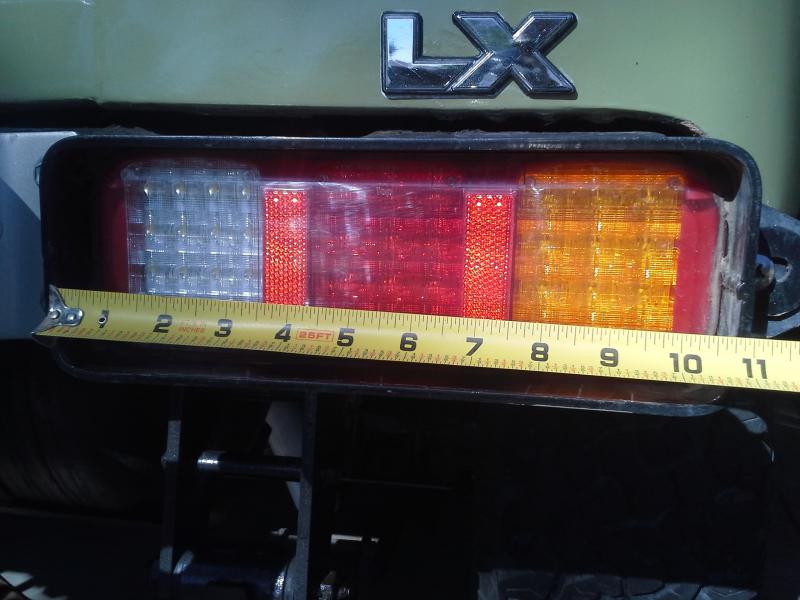

I'm not sure why my phone is not letting me download pics but I will try to to sort it out tonight. In the mean time, here is a snap of them from behind. They have two 1/2" strips of reflective material on either side of each brake light, so legally you no longer need to have the round rear reflectors (at least in Oz where they are required, I'm not sure they are here in the US and am certain they are not in NM).
Once I sort out this camera issue, I will get some snaps of the lights in situ with a tape measure. They are about 1/4" wider top and bottom and perhaps 3/8" longer on each side. Thus they can be mounted flush to the holes which exist and the old light guards can be used to house the resistor for the indicator. As mentioned, they fit PERFECTLY inside the Specter light guards (which is how I have them, given they are a bit expensive to leave hanging out in the breeze for the next rock to hit). Then the three bolts from the Specter guards hold them in.

Thanks for the info Chamba... very helpful. I was only hesitant because the lights had pinkish color in the reflectors in the other pictures. I know this happens with some photos though, because it made my brand new OEM lights look pink in this picture, and they are bright red in person.
These were just pics I had on my computer, will put more soon. They are definitely not pink but almost the exact colour of factory lights. Here is one of the reflector at night. Tonight I'll get snaps of the measurements.
My front turn signals are new Toyota assemblies with LED globes in them. The parking lights are so bright that they actually light the road a bit. I was going to get the factory rear lights as well, but these were cheaper and I like them a lot better (hard for me to say as I am a purist at heart... for some things). I had new factory tail light assemblies for my troopy and I always wanted a factory version of them in LED, but these are close enough that very few would notice.
