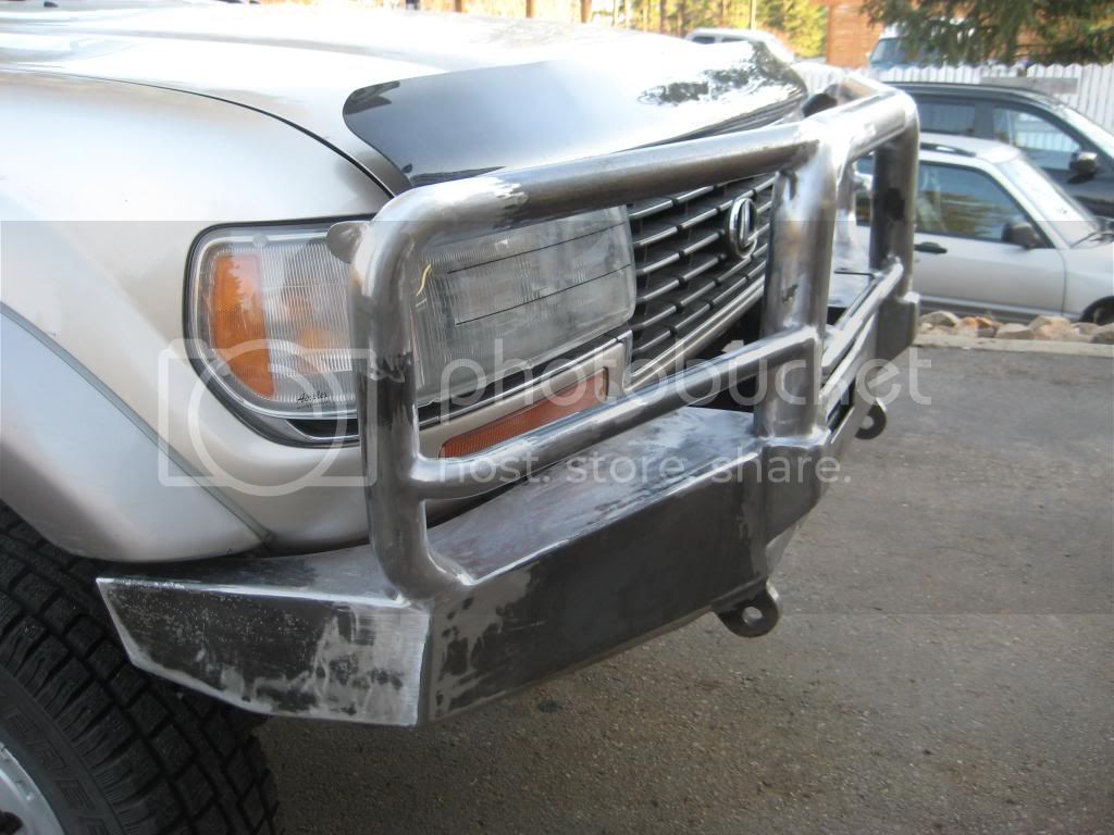

My Home built:
I'm a intermediate welder - I have to grind if I want it to look okay. Great penetration, but ... I don't weld enough. Think I'll be going thinner wire so my welds don't pile so high. My welder does not have variable heat but presets.
I used a 3/8 inch belt sander for a lot of it. Unbelievable tool.
