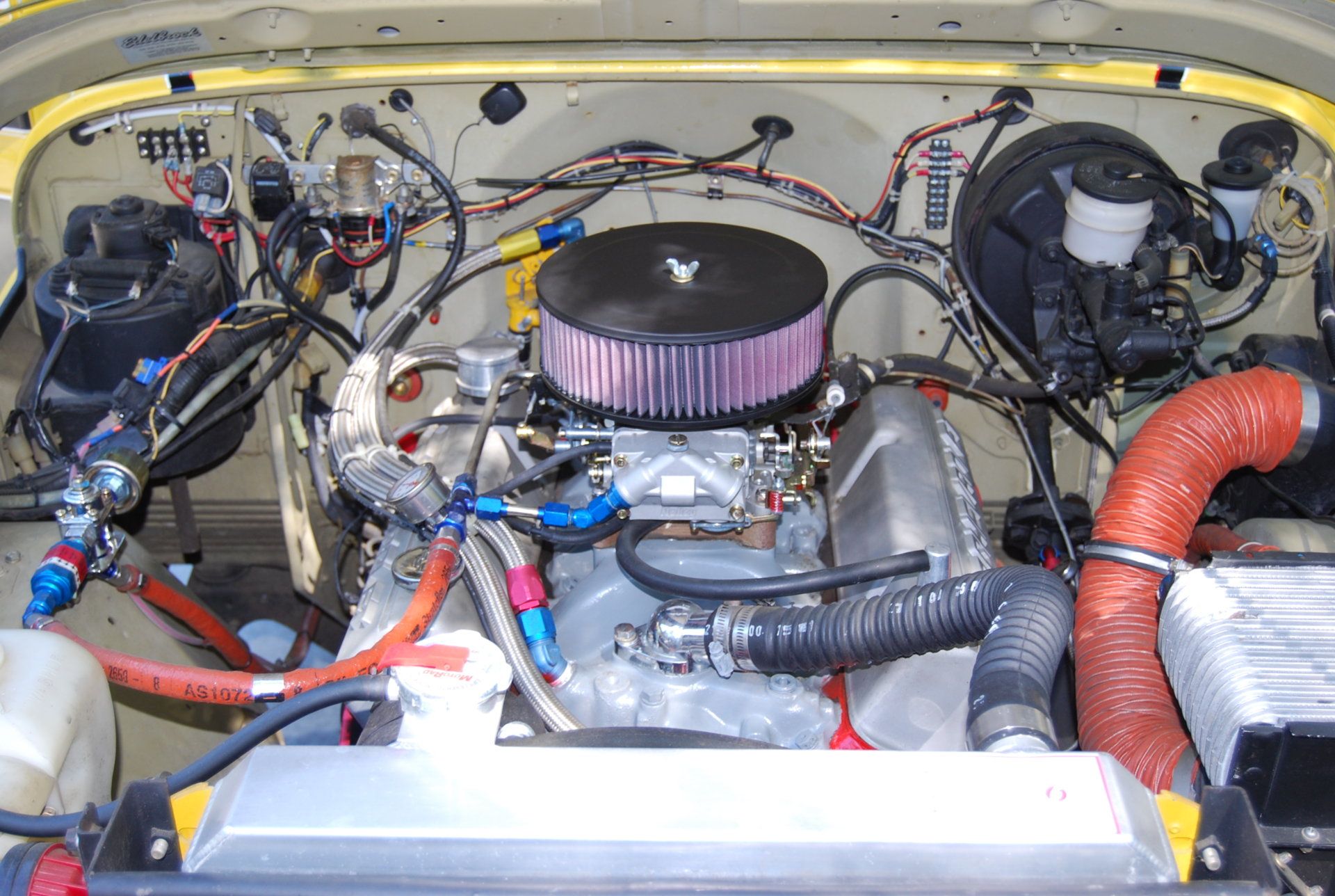

There are numerous speed equip. parts that are legal in Calif. My Edelbrock cam is Calif. legal and came with documentation for the smog Nazis. Not saying everything is, but it would be possible to do a upgrade. My engine was a universal replacement for '70's thru '80's chevys.
I admit that the 2F would be the easiest, but that is why we are into 'cruisers because we don't like anything easy. :steer:
