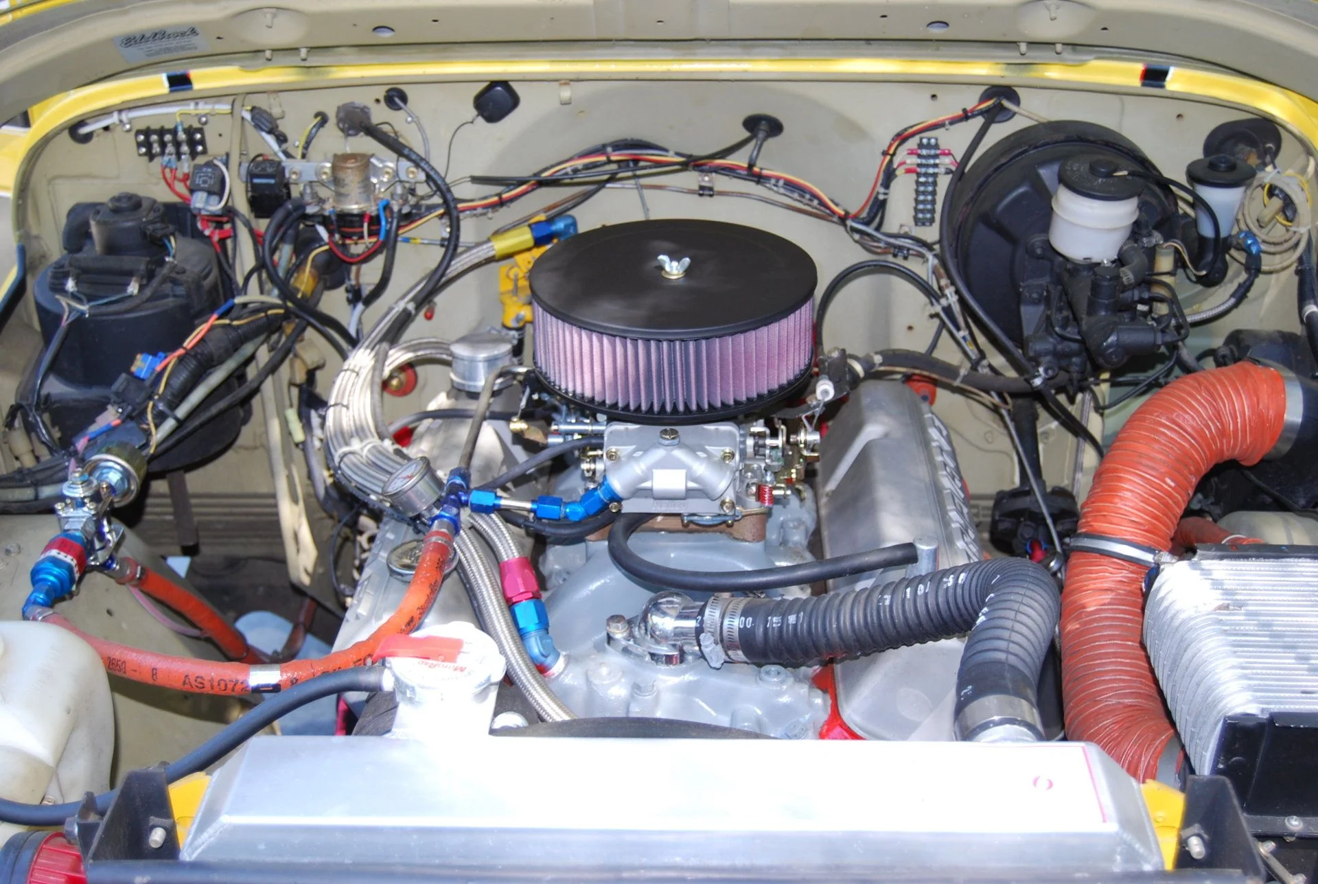

Holley 650 cfm

350 Chevy goodwrench replacement engine w/ Edelbrock manifold and cam. It drives a NV4500 5 speed trans w/ overdrive. I don't drive like I have something to prove and I get better gas mileage than I did with the old 2F. If you drive hard or offroad your mileage will go down. I don't.
