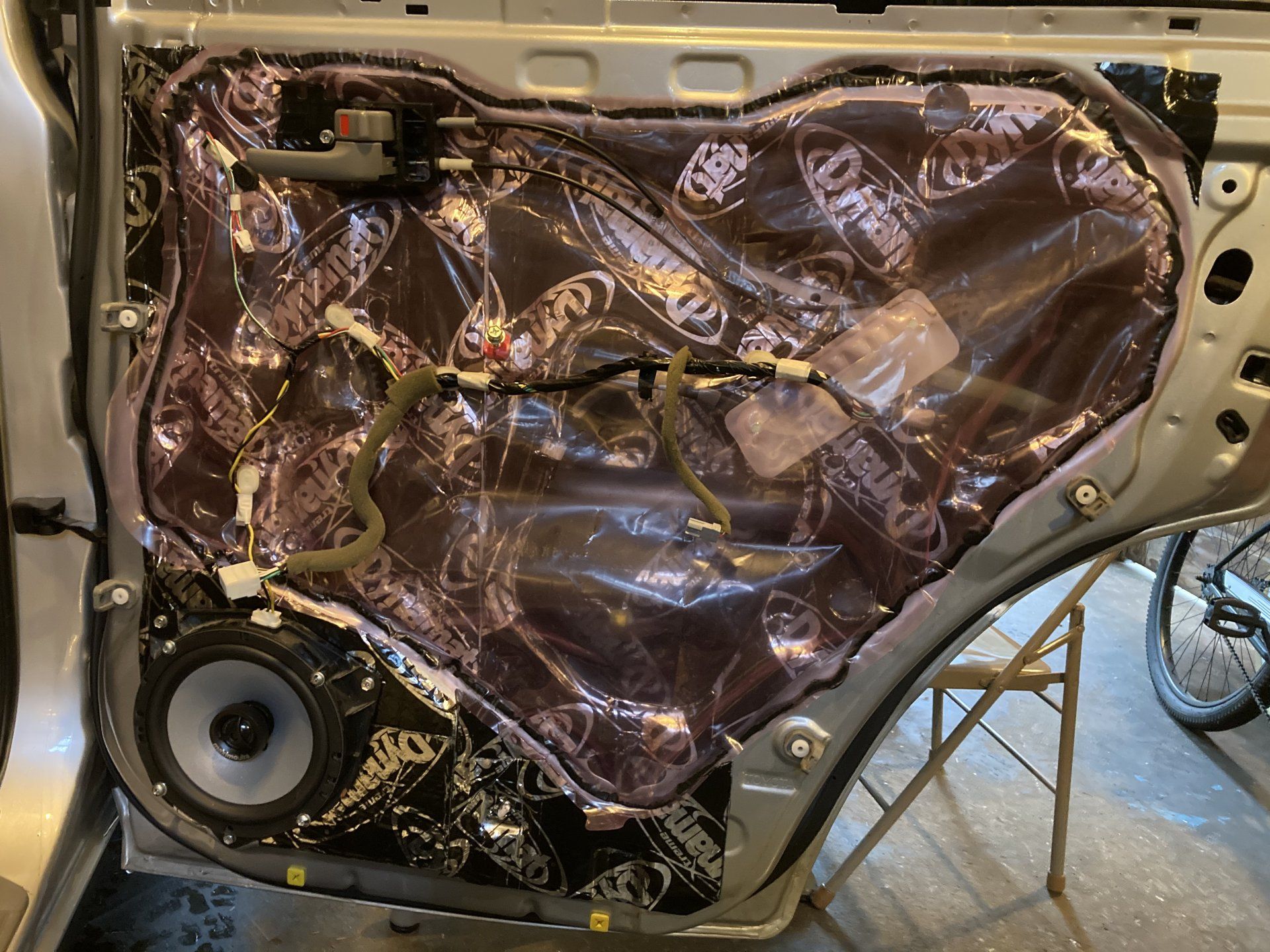

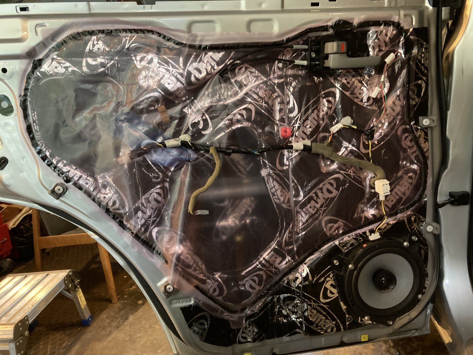

Rear doors have been Dynamat-ed and speakers are installed. I didn’t do what I was told and wasted a few extra bucks on the Maximo Ultra 602’s. I got a decent Black Friday deal on them and I’m a matchy matchy sort of guy. The front speakers came with a Metra 72-9301 wiring "harness" that easily adapts the Morel speakers to the factory speaker mount. The rears did not come with them for some reason but it was obvious that they would also work. Best Buy had the adapters in stock and made installation a breeze.

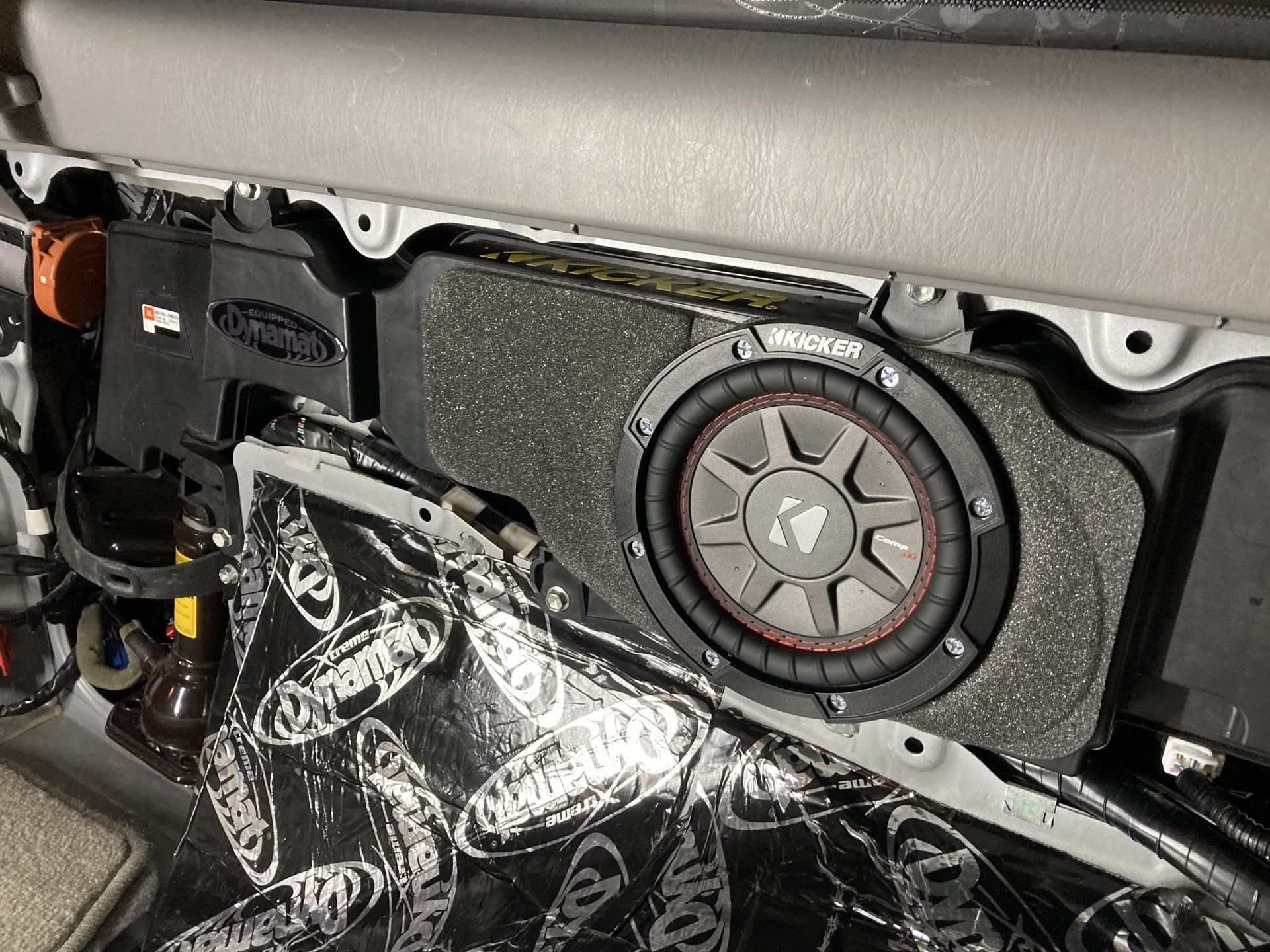

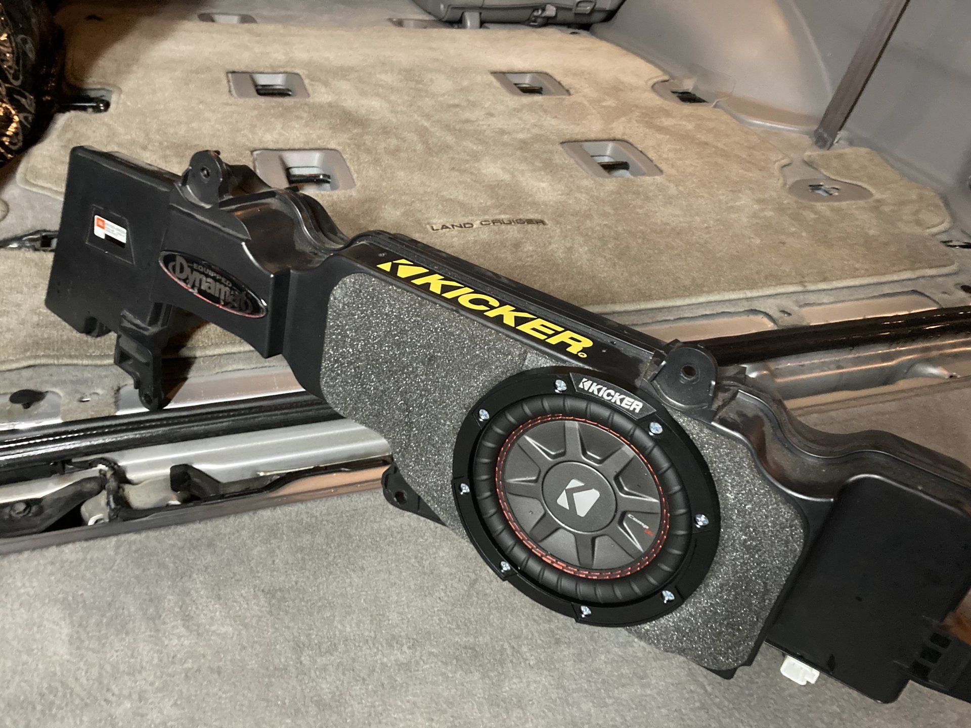

The new Kicker sub has arrived, waiting on another shipment of Dynamat for the rear.
View attachment 2525573View attachment 2525574
where does the sub mount at?? Im working on my LC HJ61...radio, all speakers.....reading up on this thread..
Behind the left rear trim panel.
Update: I thought I could get away with my simple solution to mounting the Kicker sub but it seems to be contacting the inside of the trim panel and causing vibrations. I’ll have to sink it into the box like others have.
