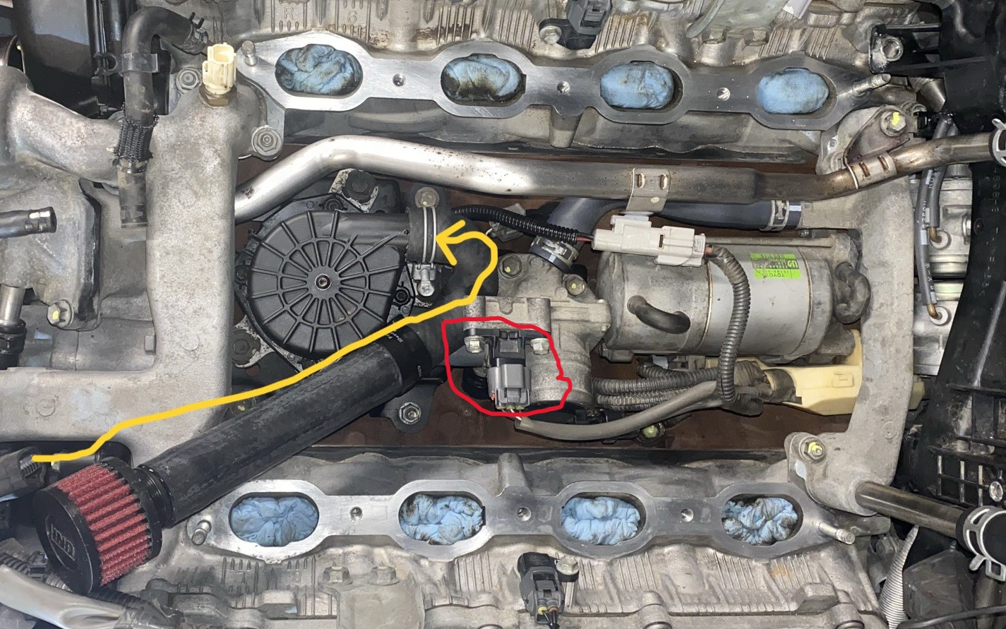

Yes.
Black plastic sensor with two 10mm bolts holding it on A.I. #1 SW. The three wire housing block connect to it.
I was going replace just the pressure sensor as a test, to confirm it was the culprit. But looking into the 1# SW, I could see staining/dirty valve. Which was due to no filter in A.I pump. Not wanting to pull intake manifold again. I just replace the #1 SW w/PS sensor, with a used one I had. As I recall: I was getting P1445 & P1442. I had found nuts on stud of to exhaust manifold the air pipe from the #2 SW, was damage and loose (air leak). Found one of the #2 SW to be aftermarket (NAPA). Many air leaks before, at and after CAT (aftermarket). I had to work through alot. After all worked through/fixed and my filter mod installed. The last was replacing #1 SW w/pressure sensor. I've not had any issue since (~5 years)
Pressure sensor circled in red.

If filter is in place, within the SAI pump (BLOWER). You can just remove the filter from it, and add the replaceable filter mod. 9 out of 10 times, we don't get any DTC after the filter mod. The 1 in 10 we do. Usually ends up needing, main SW replaced. Due to dust dust entering system. So replacing main SW cost extra, but save pulling intake manifold again in that 1 out of 10.
The filter mod, reduces long term maintenance cost. If filter mod not done, pump will need replacing periodically. Sinice all SAI pump filters, will fail. ALL!
