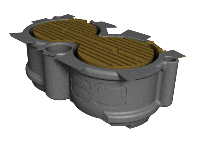

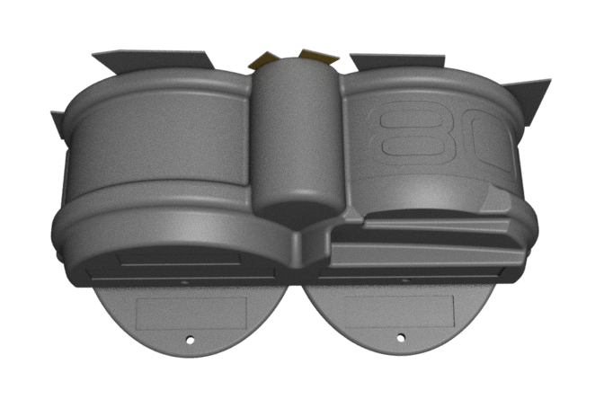

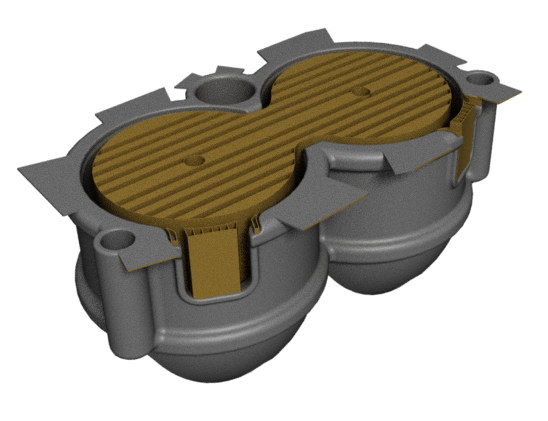

Is it possible to do a front double WITH the larger flashlight holder, like you have on the rears? Either towards the driver, towards passenger, OR both?
I have a vacation starting Saturday. I have 17 days off. I can look into a flash light holder for the front double cup holder to match the rear. I just have to make sure it doesn't interfere with anything like the shifter or "pwr" or "2nd" buttons. Give me a week and I will have some answers.

So I had a slow lunch break so I decided to crank out the "flash light holder" request. Here's what I came up with. It does not interfere with the buttons. I'm pretty sure it should not interfere with anything but I will have to print one out and test fit to be sure. These pics may seem very confusing. the Tan color is the custom supports I had to make for the print. The print is printed upside down. Those squarish tabs are 3D printing custom "feet" that help the 20hour+ print stick to the flatform during printing. Once the print is finished and removed from the platform; those feet are then snapped off as well as the supports. some sanding and acetone remove any remainder of there existence.
I realized those pics may be a tad confusing so here is a print set up digitally so you can see how this prints in the machine.
