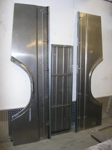

I can make LPB box sides

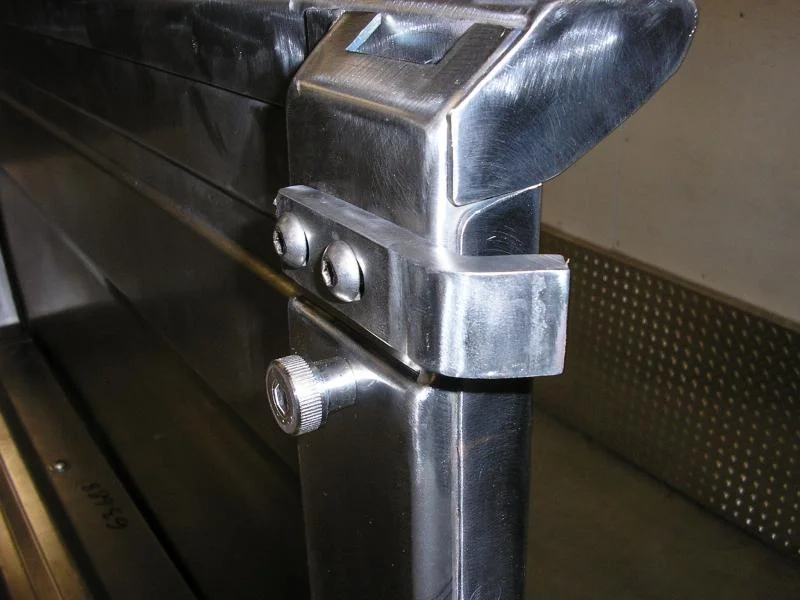

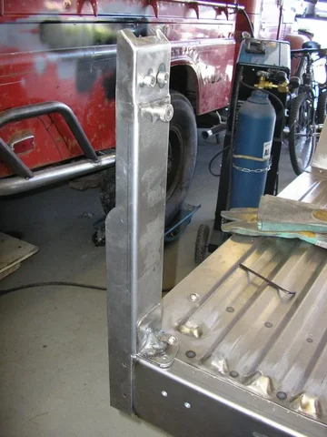

front and rear corner posts

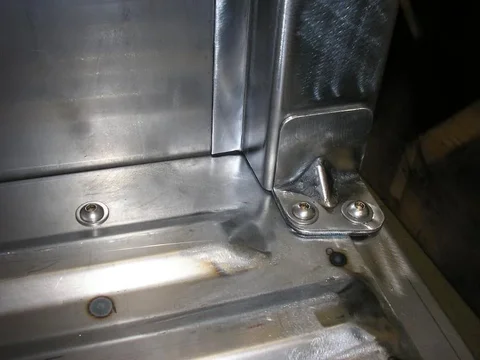

rear post with brace bracket attached and tail gate chain shoulder bolt - also latch hook bolts

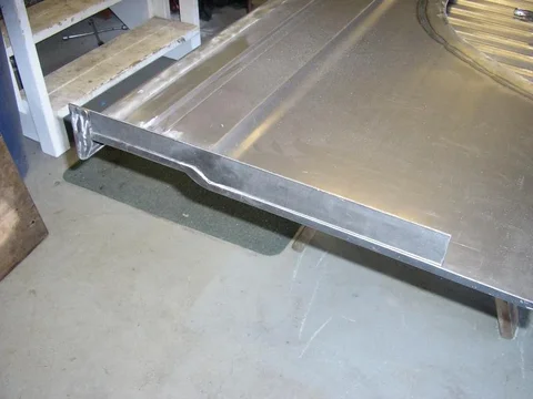

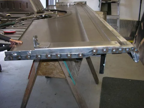

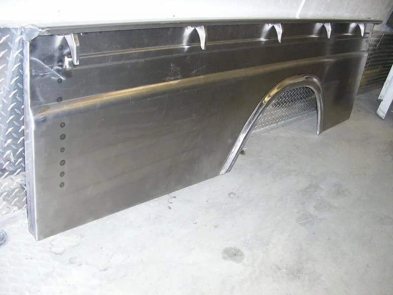

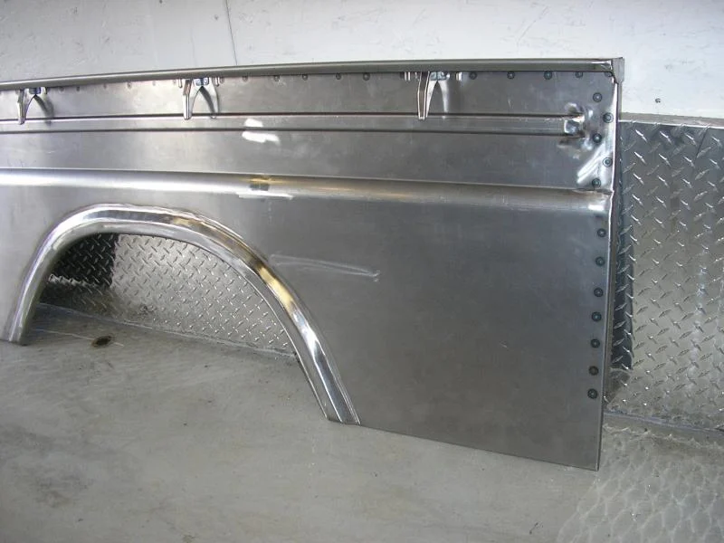

front wall and sides w/o corner posts

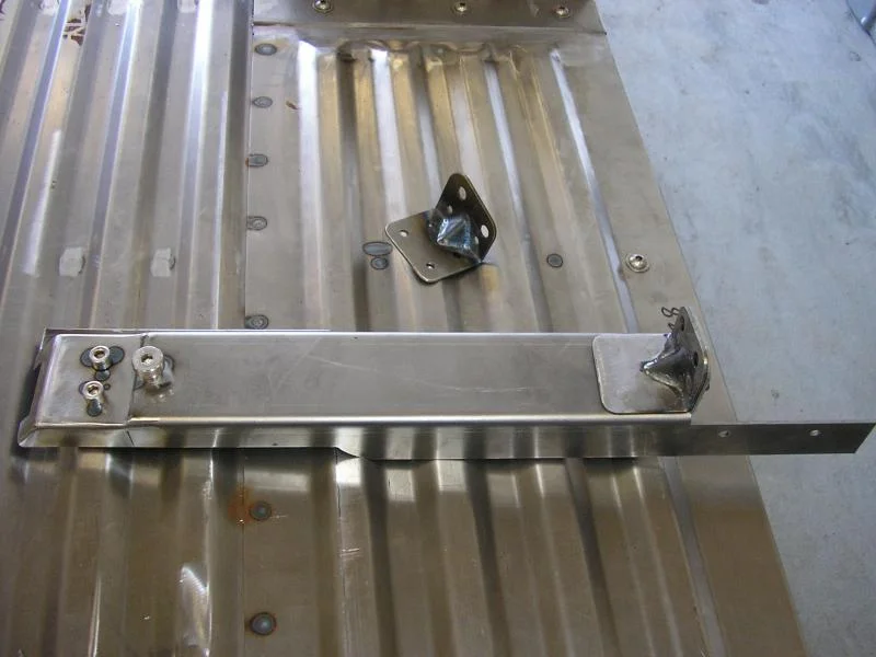

rear post test fitted

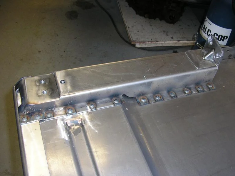

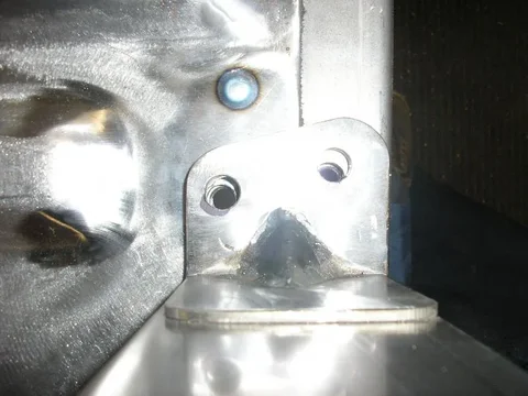

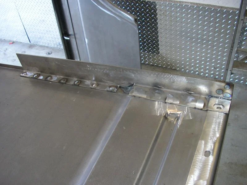

added a small shim ...
because the post overlaps the end of the floor. Also the holes were a bit off but rather than elongate them I welded them shut and match drilled them so as not to have any sort of weakness at this joint

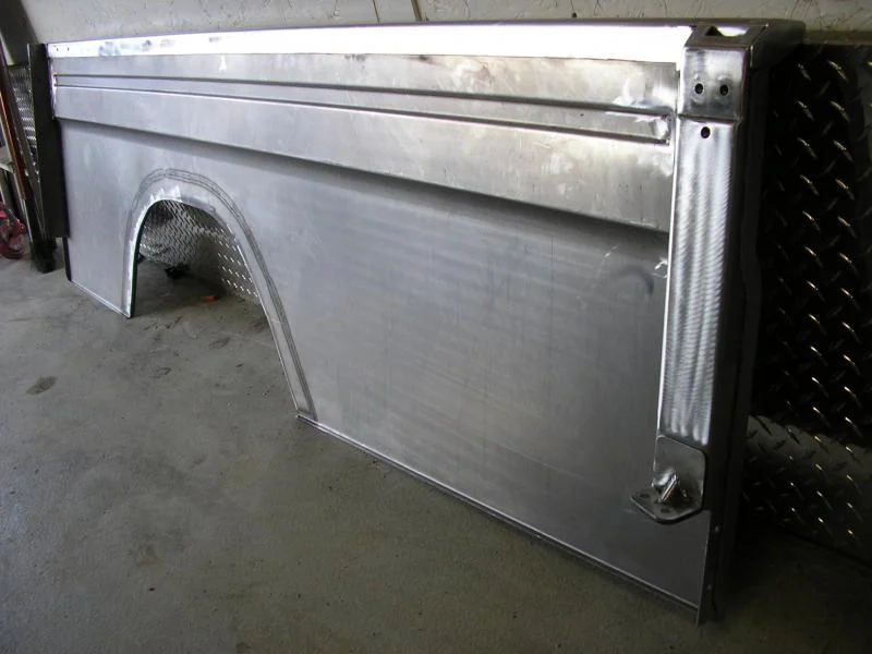

another post on posts
welded in place

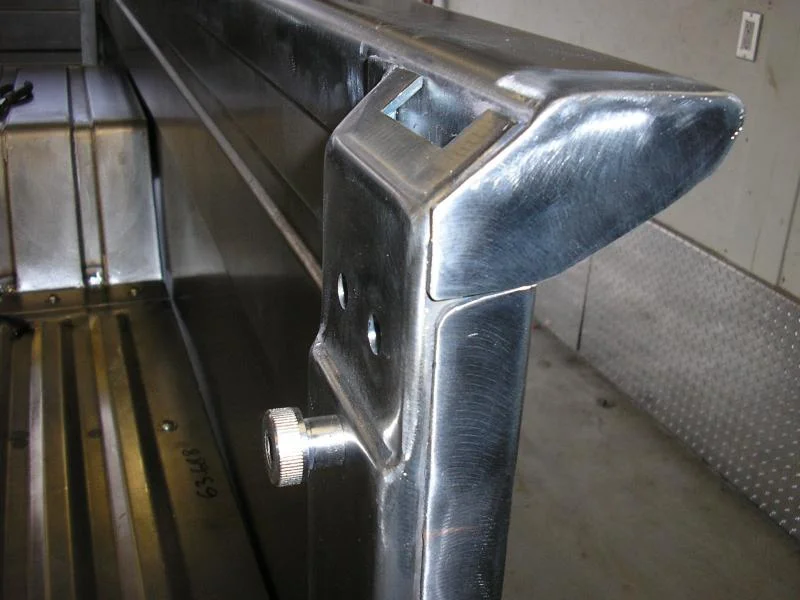

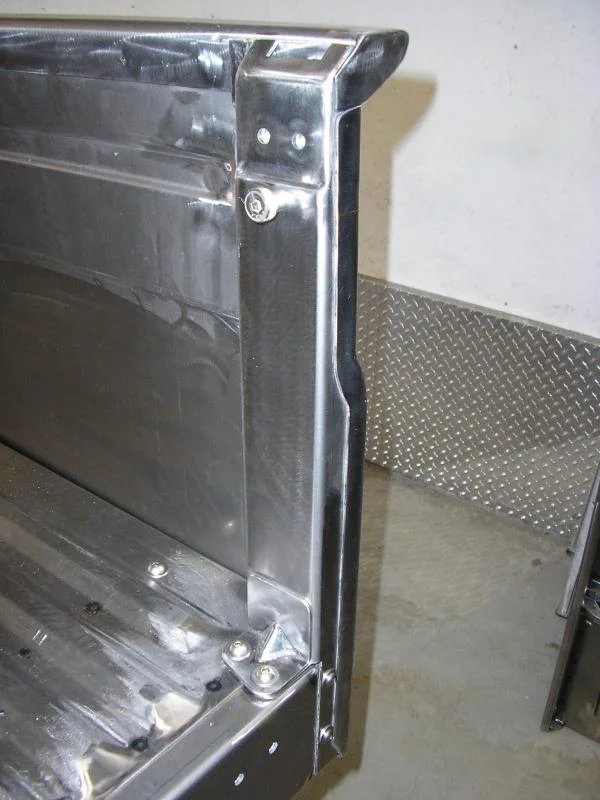

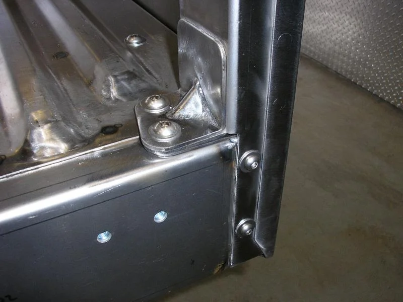

Front post - more of an angle really, but when installed it wraps around the end channel of the front wall and gives a lot of strength
front and rear installed - lots of fitting and removing of the side on the floor assembly to ensure a good fit before welding. FYI - the bed is exactly 16.5" deep from the top of the top rail to the bottom of the floor ribs
Though not welded in place the side assembly is very stiff with just the bolts holding it :cool:

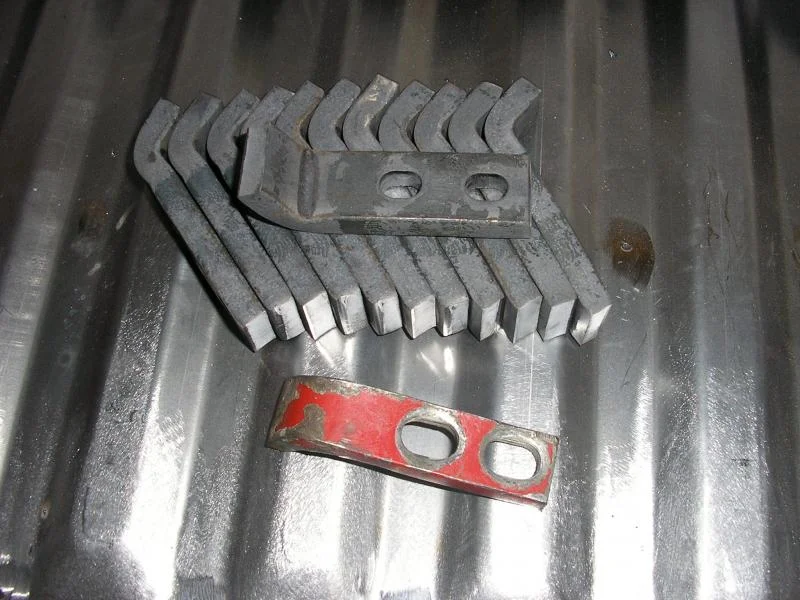

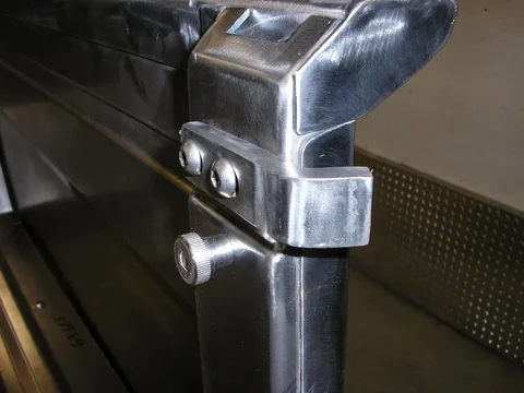

I made some latch hooks at work using 3/8" x 1" HR bar. The original is more like 5/16" x 7/8' but we didn't have that oddball size so I was hoping it wasn't too wide for the latch. After taking it home and test fitting it on my original bed I found that it wasn't too wide for the latch but it was for the opening through the tail gate. So I took a set back to work and warmed up my hands on the 6" belt sander. Now at 7/8" width they fit good.

When I put my bed together I was amazed at what a key role these couple of welds (where you have bolts now) play in the whole assembly. They seem to give the side panels all of their strength and determine if your tailgate lines up properly.

Rhino - yes, with those bolts and the extra stiffening bracket that corner is rock solid. I will be adding a bit of hidden weld there as well just for insurance.
