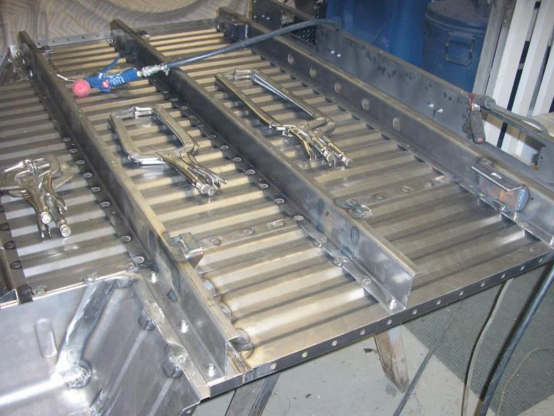

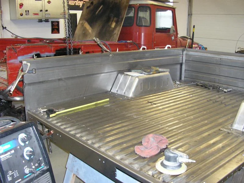

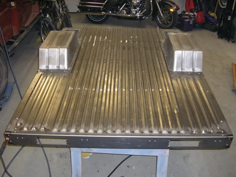

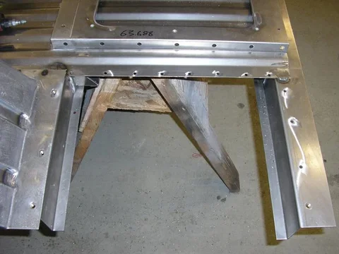

I've been going slower lately but still working on the bed. Last week I spent some time finishing details and checking measurements. Today I completed the floor sub assembly. I have shown a few pics of the floor but it was not actually welded till now. Welding together means lots of measuring and test fitting to ensure I don't have to cut it apart for some reason.

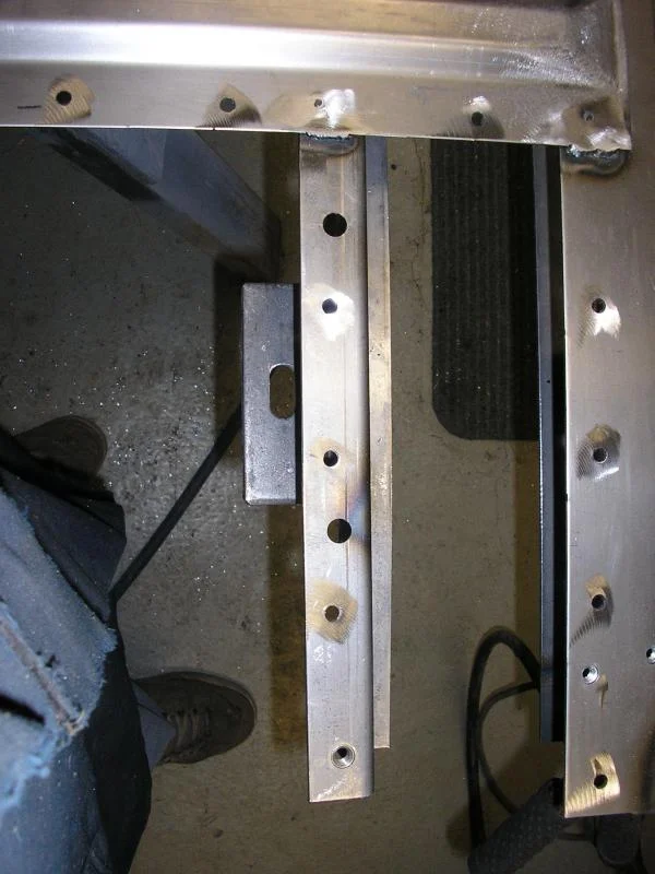

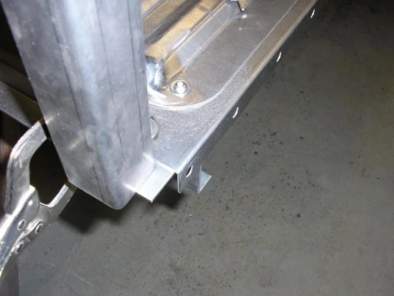

So I started with the wheel humps because they sit under the front and rear floor sections and must be done first. I sanded and smoothed the welds (easier now than later) and elongated the bolt holes due to my aforementioned oversight. :o I drilled a few holes along the overlapping section of the main floor to plug weld. I bolted the humps in place and clamped the overlap section tight. After checking that the humps were standing square to the floor (the better to later attach the side panels) and they were the right distance apart I plug welded the holes I drilled. I did not take a pic of this action but this shot shows the hump welded in.

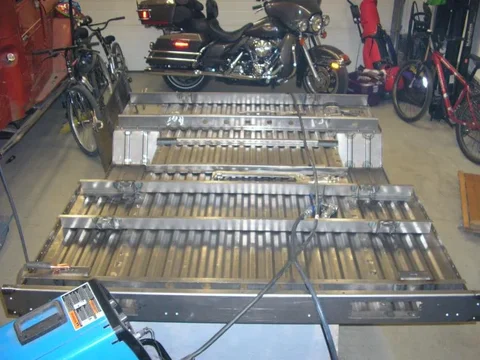

After admiring the humps for a minute, I marked out and drilled plug weld holes for the rear floor section. Basically, everywhere the floor touches a cross member or overlaps the main floor there is a weld hole drilled. In future I will punch these holes in on the turret because whether I assemble it or one of my preferred customers ;) does they are needed.
I bolted all four corners in place at just the right width...
Flipped it over - interesting by yourself :banana:
Plug welded all the holes I drilled (yeah, I drilled holes to weld them shut :doh:)

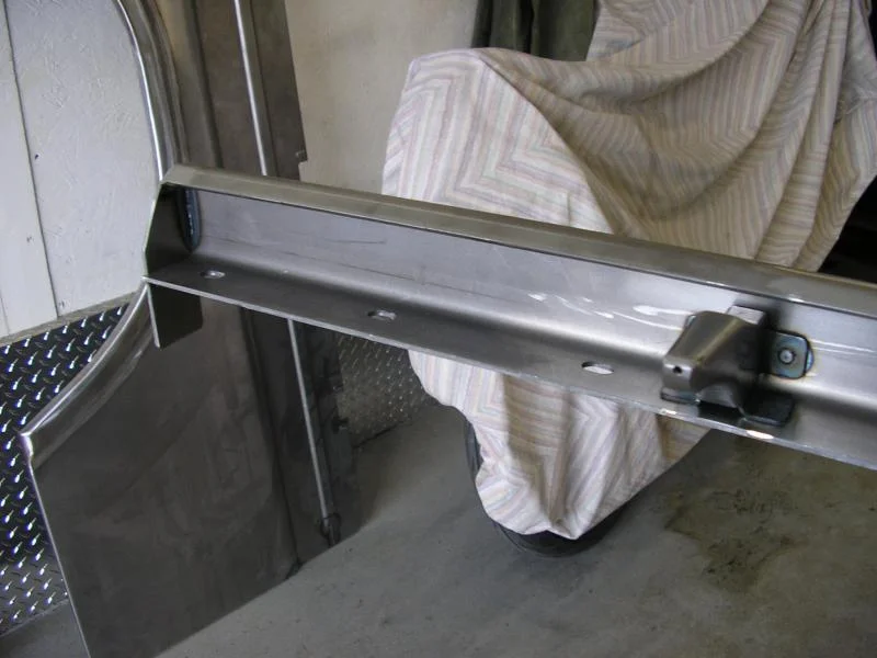

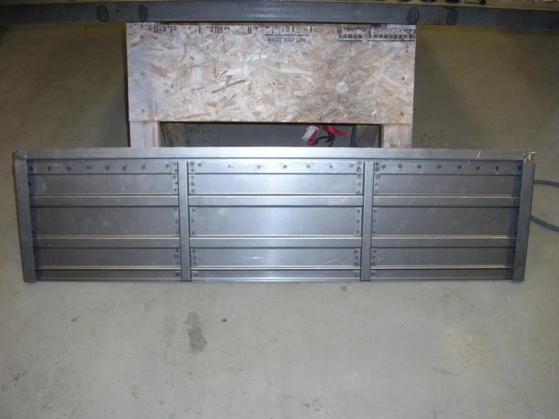

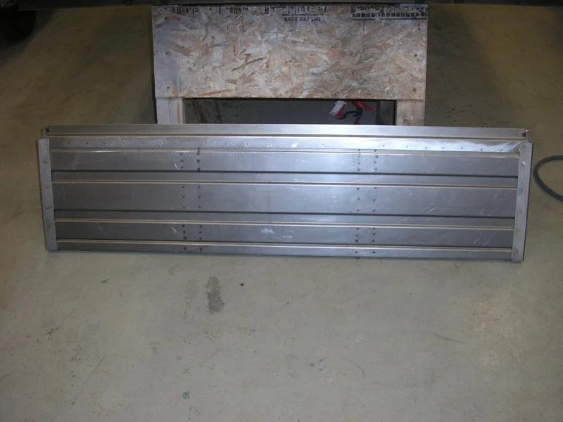

With the floor assembly complete I moved on to the front wall. As seen in an earlier post I had already spot welded on the top 'Z' channel and the stiffeners. So all that is left for the front wall is the end channels and I have now welded them on. These three pics show a completed front wall sub assembly.

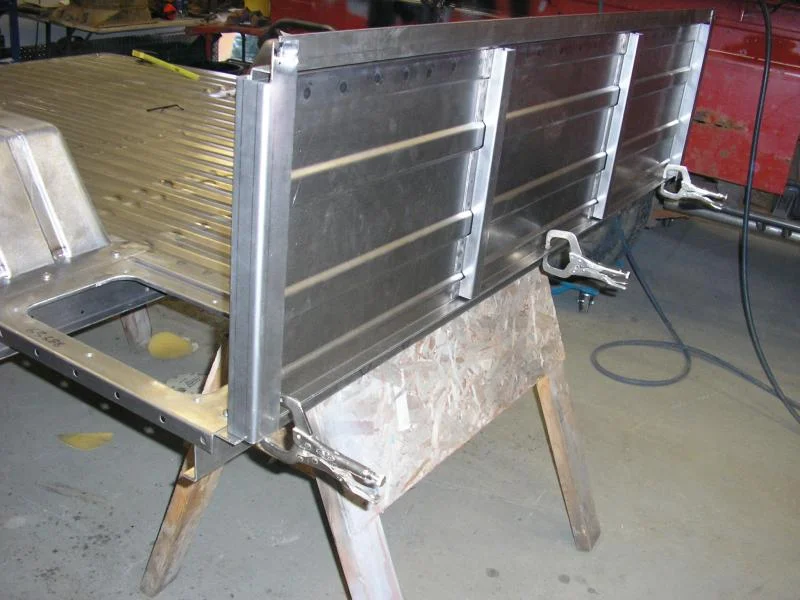

Front wall clamped on
Evened out left to right

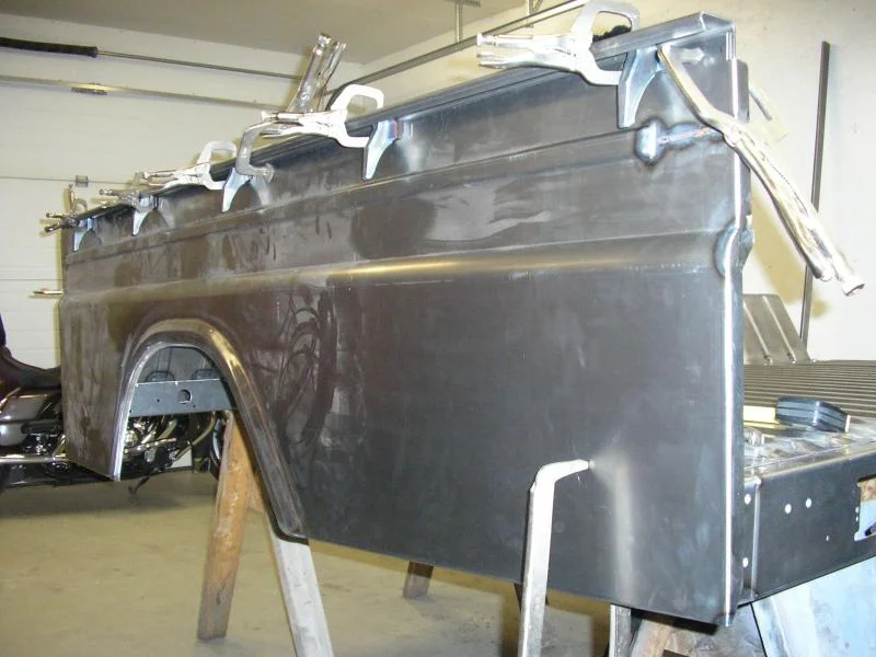

I couldn't resist slapping on a side panel, top rail and hooks to see what it looks like.
A couple of more angles. I would have kept going but I got called in for supper. This week I will make the rear corner posts and get the sides on next weekend.

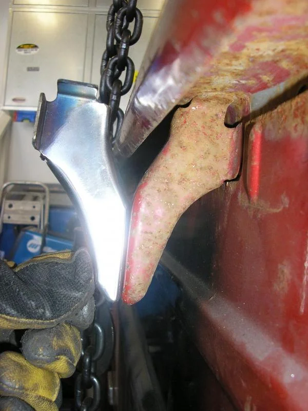

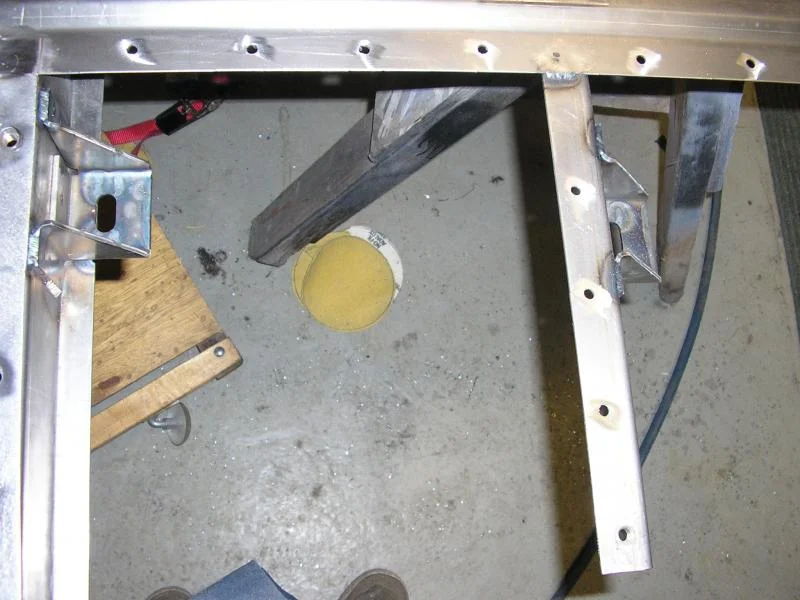

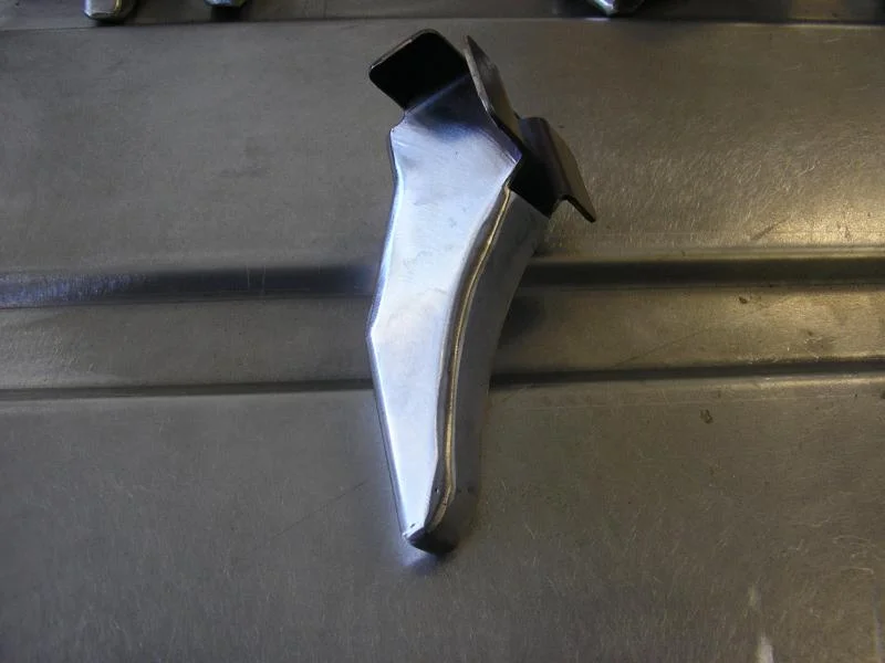

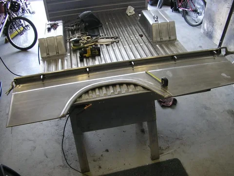

I welded up a set of thirteen bed hooks buy welding the seams and adding a backer piece to finish the backside and strengthen it. I drilled a small hole in the tip to let moisture out.
Now they look much closer to the originals. I shortened them as well.
I plug welded them to the top rail and ground the weld smooth. I have also added the end caps to the rails.
The other end
A view of the side panel and hook relationship.
The side panel and top rail welded
