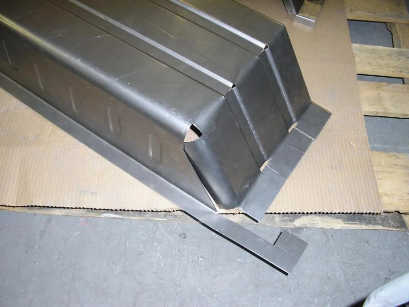

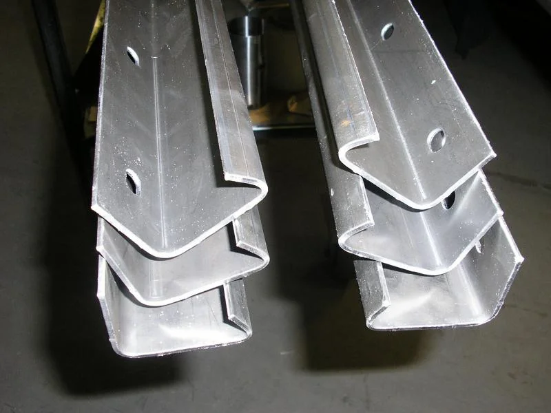

I can make LPB box sides

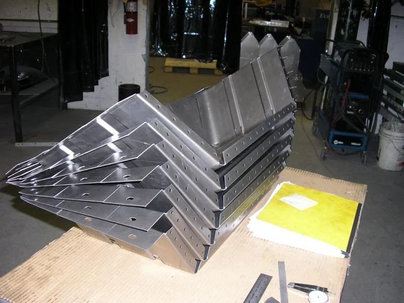

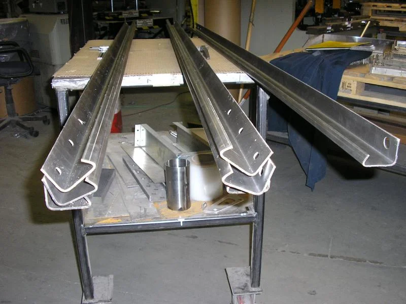

I also had time to form the bed rails

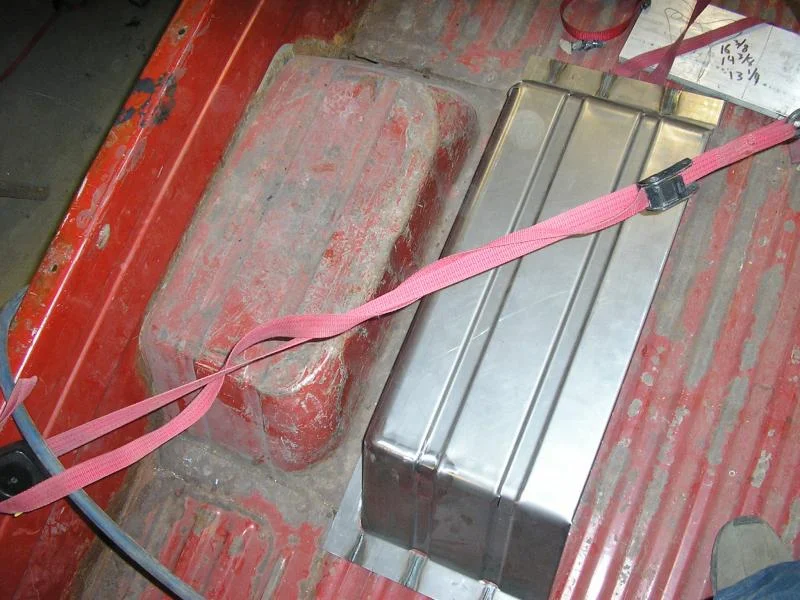

My first try - kind of ugly - destined for the scrap bin
Wow, your bed design is looking awesome. I bet that some folks would love to have those wheel wells if you are just going to throw them away.

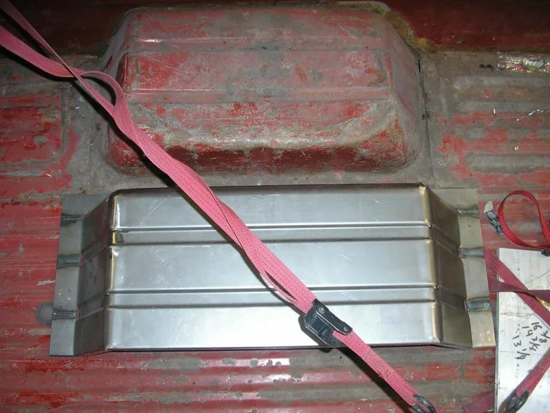

Nah Rhino, they were like three inches too long. Not sure how I did that but oh well. They don't land on the cross members and really wouldn't work well. It was just a prototype to prove to myself the layout was good and then make fine tuning changes from as a baseline. Good thing I only made one or I'd have six that were 3" too long. :hillbilly: Any way it was still useful - I made a half dozen changes and learned what not to do when setting up the break tooling.
Besides, I already made more :D - 7 more - one extra in case I screwed up something in the bending process. Turns out I still have a mistake in the layout - when I placed the holes in the flat pattern I forgot to compensate for the shrinkage in width caused by forming the two ribs so the holes don't quite line up. A relatively minor problem given the fact the front and rear floor panels overlap the hump and will cover my fix (elongating the one hole 1/8").

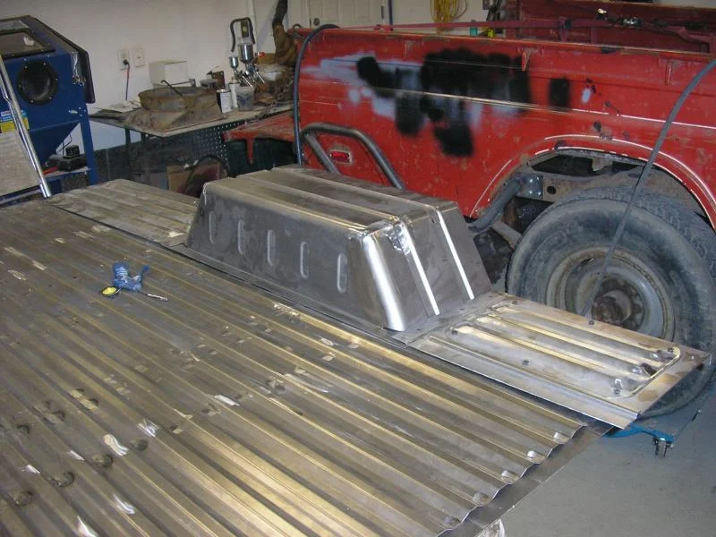

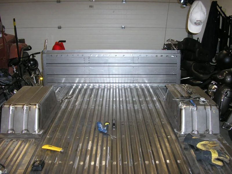

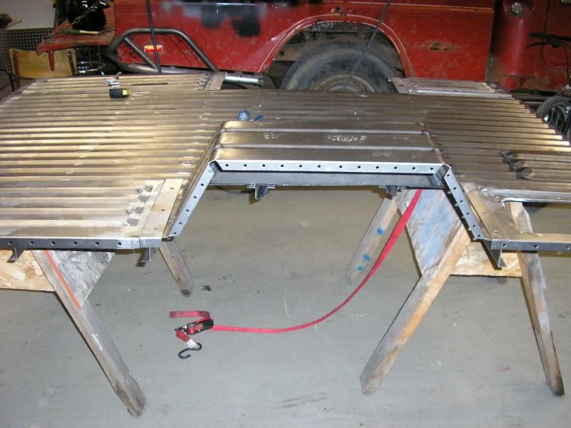

I welded one up and took it home to see how it fit. Other than the one hole it fits pretty good. Definitely a keeper:clap:

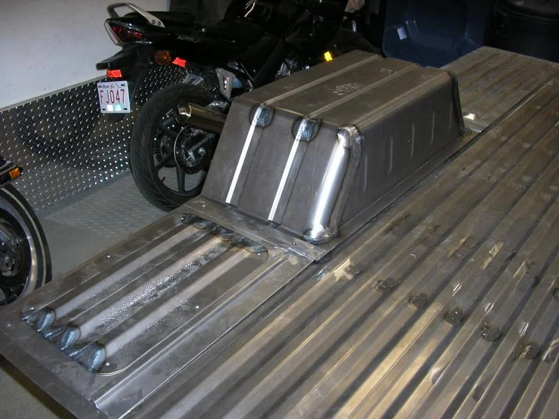

A couple more... you can see my boot print on top - I set it on the floor and stood on it - no flex, pretty solid with 200 Lbs on it. Even without being bolted into the assembly or spot welded to the side panels.
Well I'm trying to stay faithful to the original as much as possible so that my parts could be used for restoring a bed. Ideally, my stuff would be a straight bolt on (weld on) replacement part. Only minor grinding and fitting due to production variances on Toyota's assembly line should be required before touch up with spot filler and primer. At least thats the goal :D.

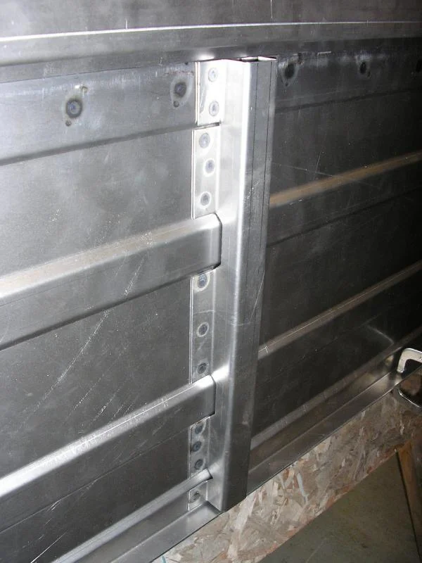

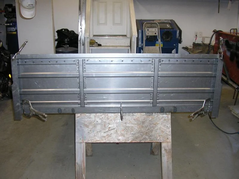

During last week I had time to build the front wall with stiffeners and spot weld them to the top rail.
A couple more:
The vise-grips on the top corners are holding what I refer to as the front corner post. Its really just an angle with two different flange lengths and an offset in it for the top rail on the bed sides. The side panels and rails weld directly to that angle and then all down the sides along the floor line to the rear corner post (the only major part I have yet to make)
