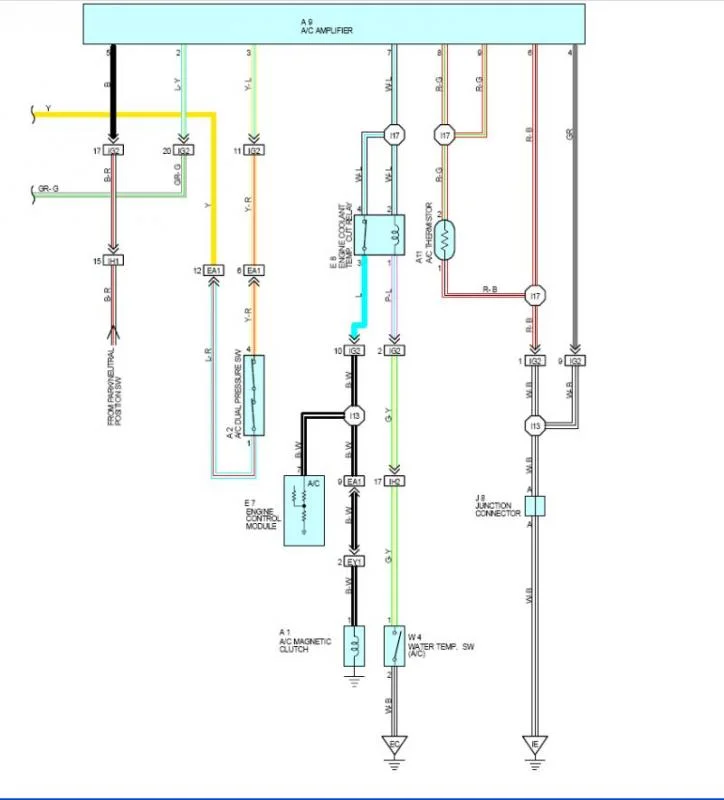

If you have a flaky water temp switch then this could cause the AC to cut out when the temperature is hot. (Note that there are 3 water temp switches in the engine block.) You may also want to test that thermistor and the engine coolant temp relay.
A11 A/C THERMISTOR
2-1 : APPROX. 1.5 K 25°C (77°F)
11. AIR CONDITIOIN OPERATION
WHEN THE IGNITION SW IS TURNED ON, THE CURRENT FROM THE GAUGE FUSE FLOWS THROUGH THE THE A/C DAUL
PRESSURE SW TO TERMINAL 3 OF THE A/C AMPLIFIER. IF THE HEATER CONTROL SW IS TURNED ON, THE CURRENT FLOWS
FROM THE FL HEATER FUSE THROUGH THE A.C FUSE TO TERMINAL (B)17 OF THE HEATER CONTROL SW. WHEN THE A/C IS
TURNED ON, THE CURRENT FLOWS FROM TERMINAL (B)17 OF THE HEATER CONTROL SW TO TERMINAL (B)6 TERMINAL 2 OF
THE A/C AMPLIFIER, ACTIVATING THE A/C AMPLIFIER. THE CURRENT THEN FLOWS FROM TERMINAL 7 OF THE A/C AMPLIFIER TO
TERMINAL 4 OF THE ENGINE COOLANT TEMP. RELAY TERMINAL 3 TERMINAL 1 OF A/C MAGNETIC CLUTCH GROUND.
THIS CAUSES THE COMPRESSOR TO START. WHEN THE ENGINE COOLANT TEMPERTURE IS APPROX. 108C (226F), THE
WATER TEMP. SW (A/C) IS TURNED ON AND THE A/C CUT RELAY IS ACTIVATED. THIS TURNS THE COMPRESSOR OFF AND STOPS
THE AIR CONDITIONING. THE AIR CONDITIONING ALSO TURNS OFF, IF A SIGNAL IS INPUT TO THE A/C AMPLIFIER THAT THE AIR
OUTLET TEMPERTURE IS LOW (BELOW APPROX. 3C) OR THE REFRIGERANT PRESSURE IS ABNORMALLY LOW.

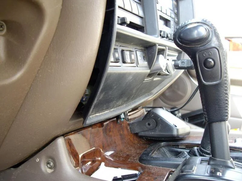

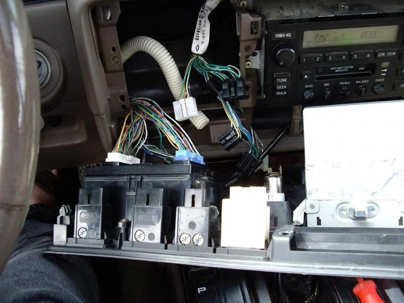

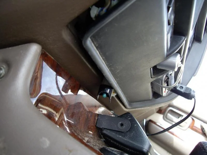

Had some time to look at it again. Did a nice little video clip of opening up the dash and finding all the parts that weren't plugged in, and pictures of the ashtray light stuck inbetween the panels keeping them from fitting. They should make my case for why they owe me for fixing what they screwed up. If not, it's gonna look really nice on utube!

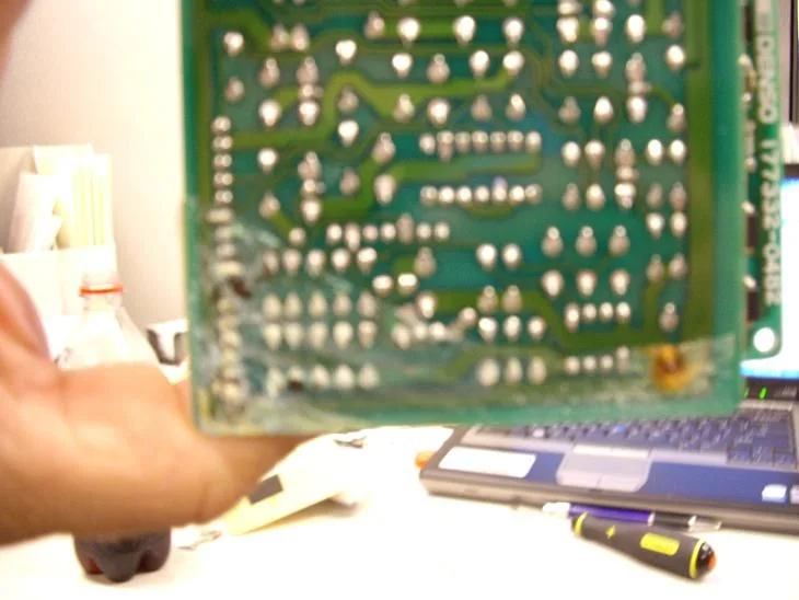

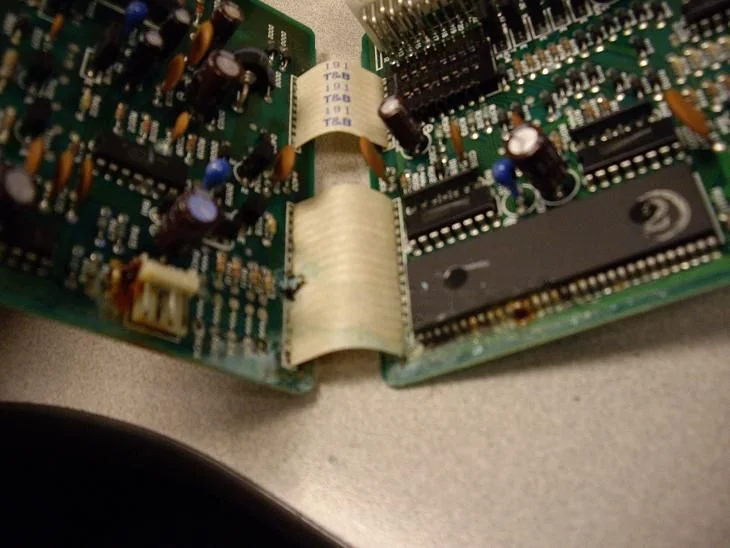

I pulled the AC amplifier out PN88650-60212. Opened up the case to look at the PCB. It's had water in the case. The connections are all corroded and such - have photos, will attach when I get a chance to load from the camera. Went to get one from a local junkyard, and it was full of water. Don't know where the water is coming from in my truck, the yard one had the windows out. It's not designed to be very water tollerate that's for sure. The top is open, and the bottom is closed, so there is really no place for it to escape if it does get condensation or what not in it. Ordering another used one today. So hopefully will be resolved by the weekend????

Here's what the PCB looks like once removed from the housing.

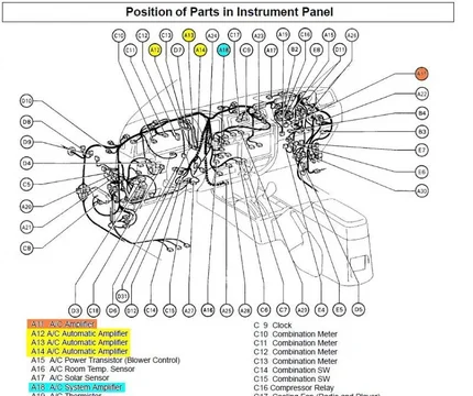

The AC amplifier is behind the glovebox on the right side. There is another part called the AC System amplifier that is behind the AC controls in the center dash...
...I pulled the AC amplifier out PN88650-60212...

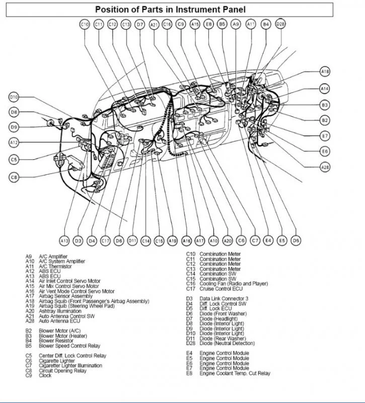

I think you guys are talking are talking about different things. The A/C amplifier, as Beowulf says, is behind the glove box. It's p/n 88650-60060. It's a black box with a single 9-pin connector on the top. There's a circuit board inside, but it doesn't look anything like the photos that Walking Eagle posted.
Walking Eagle, could you be talking about the A/C SYSTEM amplifier? Where was it located? I suspect, but don't have the necessary documentation, that the system amplifier is different on a standard '97 versus a 40th anniversary edition '97. My 1997 EWD does not include the schematics for the 40th AE climate control. Does any know if there was a separate EWD for this rig?

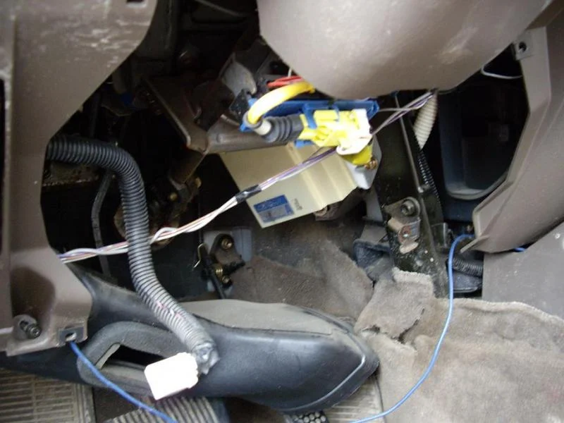

But where in the truck does p/n 88650-60212 reside?
it's under the dash, drivers side, to the right of the steering wheel - First take off lower dash panel, then the big metal guard, then the duct, then you can get to it. The three pugs that go into the top are a bit of a pain. snapped a couple shots taking it out, plan on doing better putting it together.
Got it. I poked my head under the dash of my non-anniversary edition '97 and couldn't find a white box like yours. Of course it's hard to see up there with the dash guard and heat vent in place, but I'm pretty sure it's not present. So I'm betting that this part is unique to LX450's and AE versions of the the FZJ80. Also, from your photos of the circuit boards it looks like there is a microprocessor on one of the boards. So a better name for p/n 88650-60212 would be "climate control computer" if you ask me.
At any rate, I sure hope this fixes your problem. Any idea on how water got into yours? If not you should consider spending a little time trying to figure that out so that you don't have a repeat of the problem in the future. A common problem with 80's are leaks around the windshield on older vehicles and vehicles that have had the windshield replaced and a non-OEM rubber gasket was used. So at a minimum you should spray the windshield with a garden hose and make sure there's no water intrusion.
If you have water in that part of your vehicle then you have a serious windshield leak or a serious moon roof leak. This leak needs to get fixed. Hugh had bad corrosion from water in the driver side kick panel and darn near burned up his truck.
This one is an LX450. On the LC, the only difference I see in the EWD is between automatic & manual A/C.

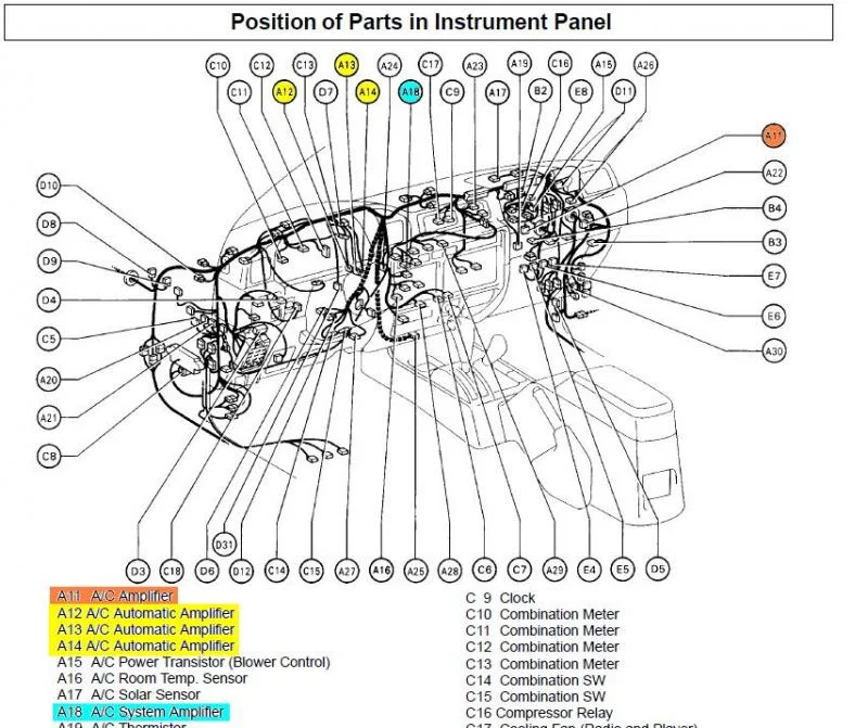

I stand corrected on the location as noted earlier. Here's the picure:
You are looking at the right part (A/C Automatic Amplifier) as per my earlier long-distance diag.
Once again this confirms that there are wiring differences between the LC and the LX. This has been discussed many times and those without the EWD for their specific year and model are counting on help from those of us with good intentions but the wrong manual. It takes time to post JPG snippets of PDF documents.
Thanks Donal. I believe I will let you and WE wrap this up. The problem is definitely in one of those "A/C amplifiers"... which one is the issue and starting with the one with obvious water damage is the smart thing to do.
