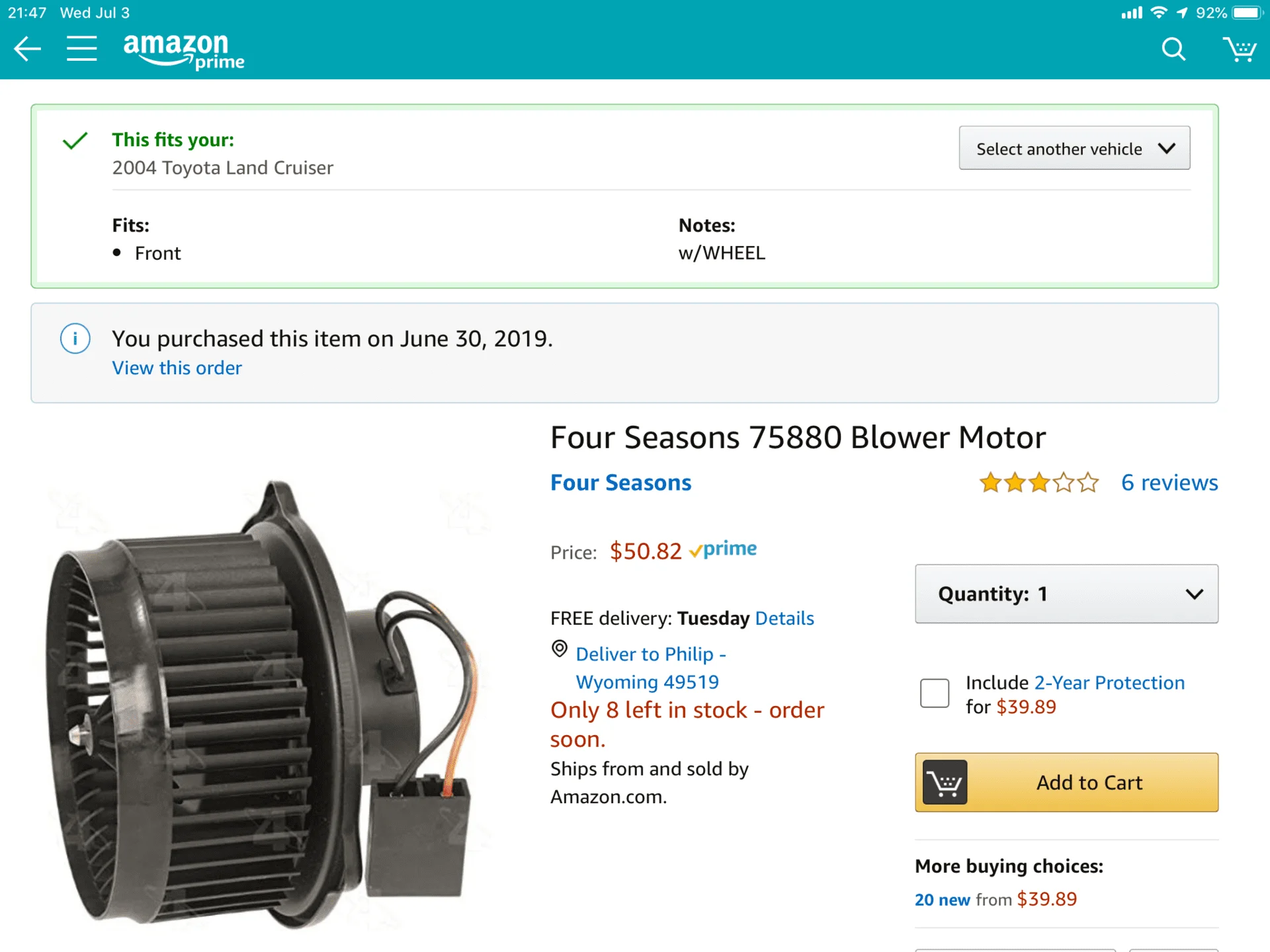

For anyone else with this problem, I installed this unit and it is now fixed.
