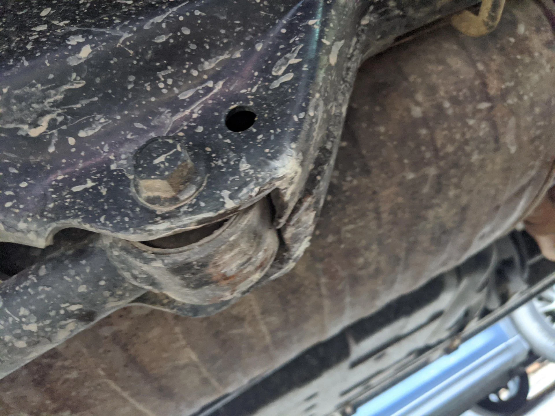

Had a little woops going up lower Engineer. The Asfir Front Skid did its job as well. Time for some Trail Tailor LCA skids.

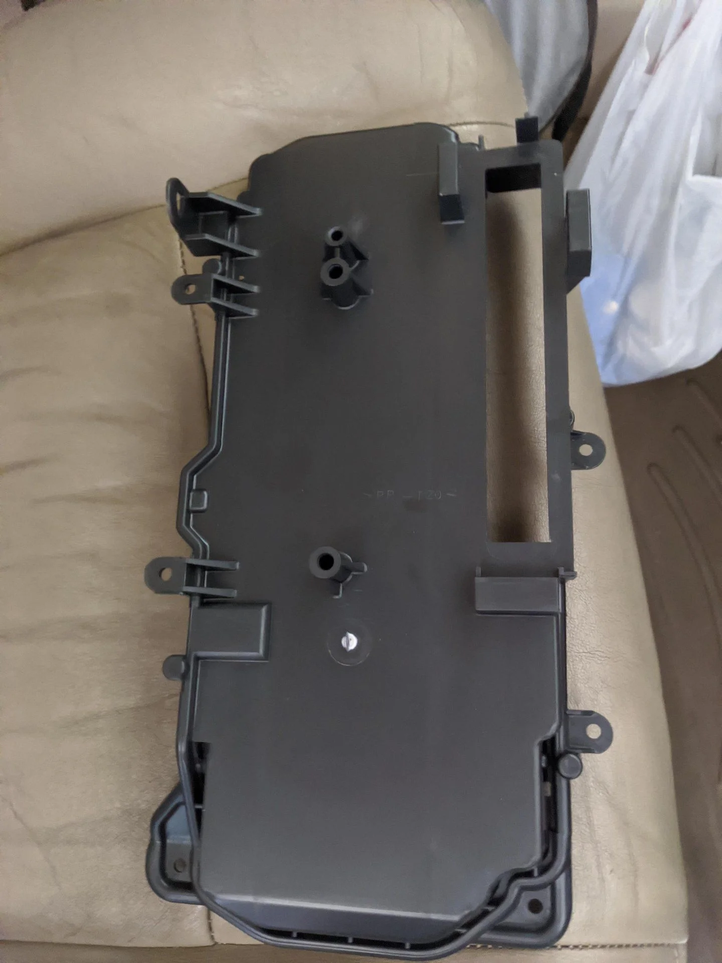

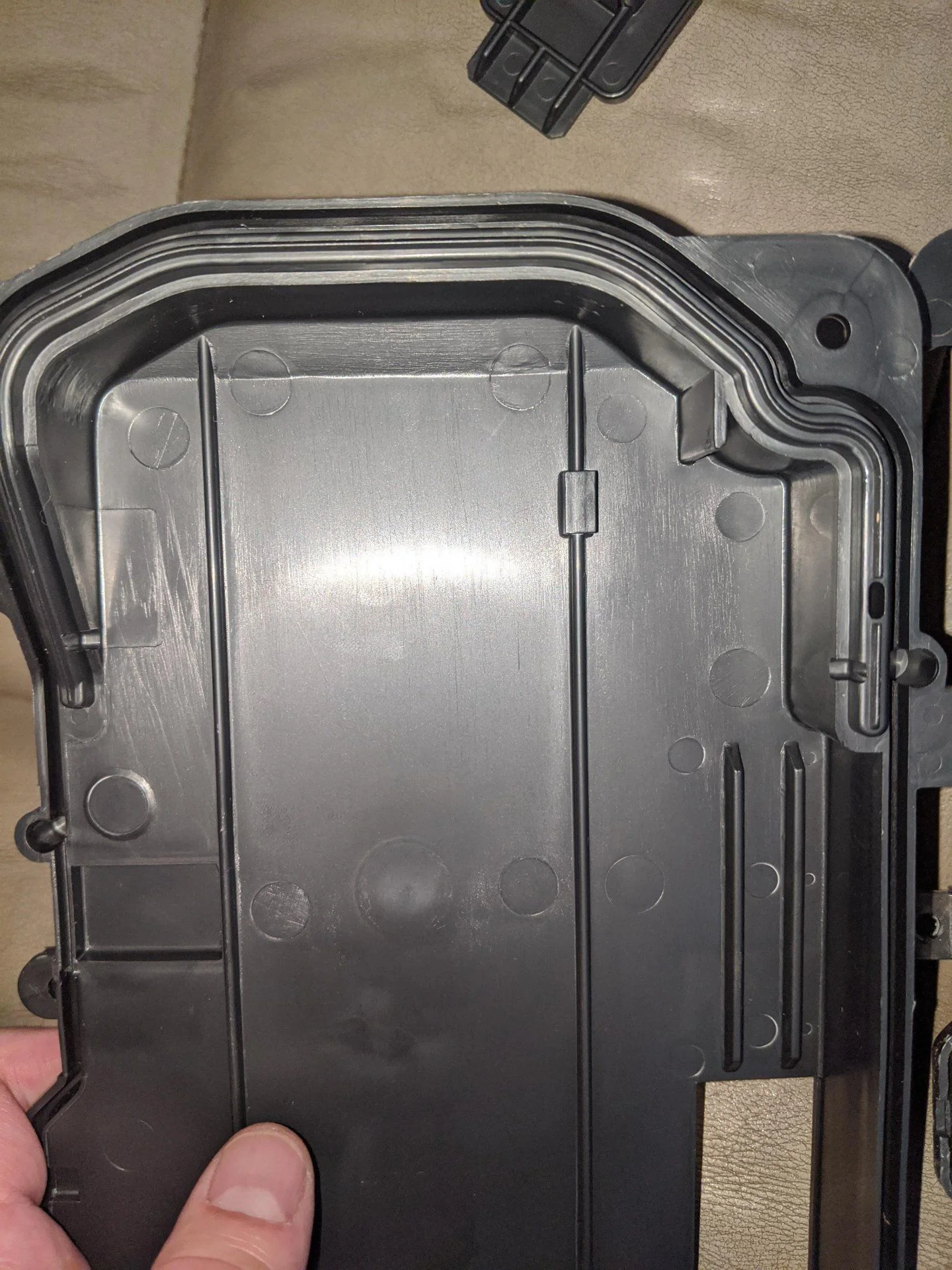

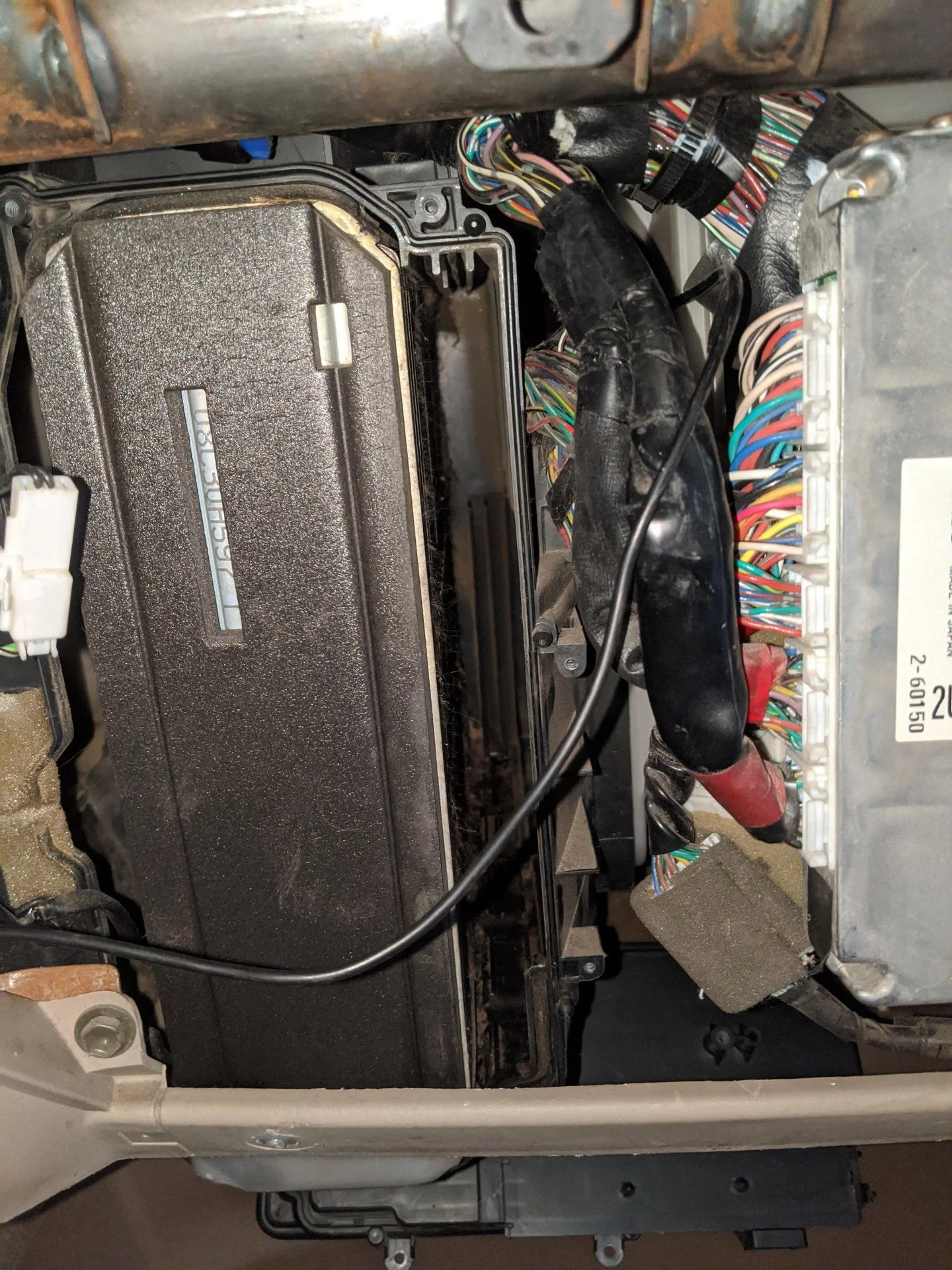

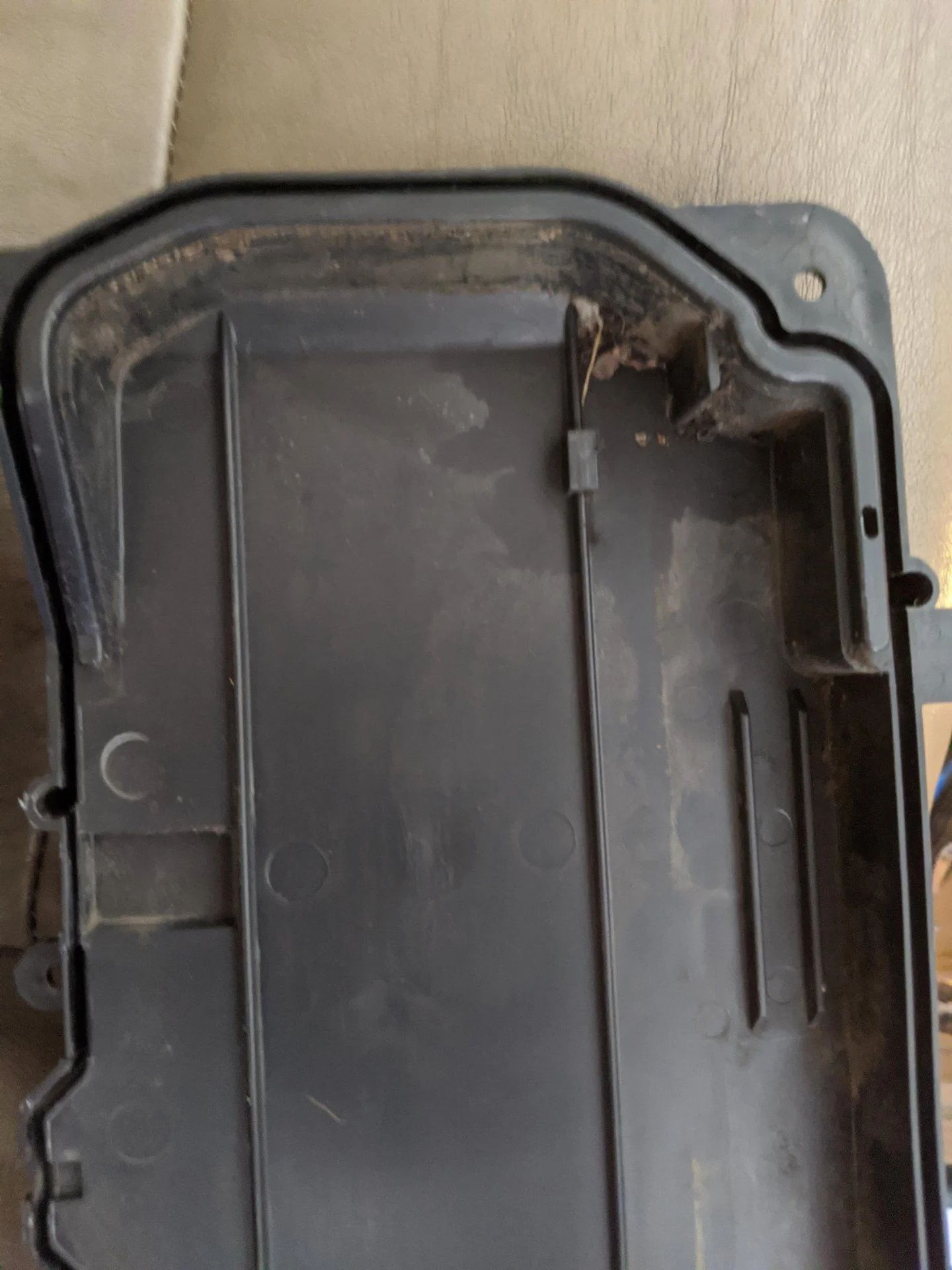

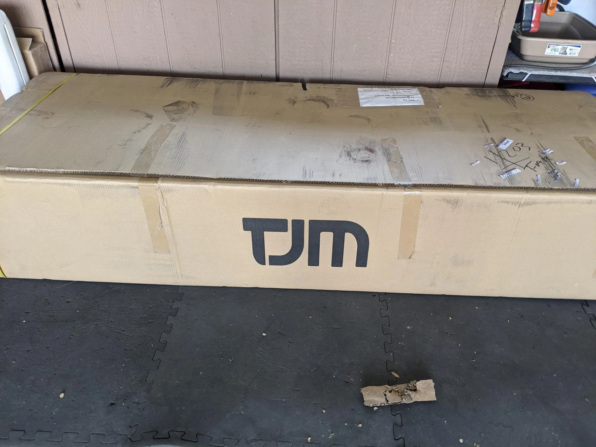

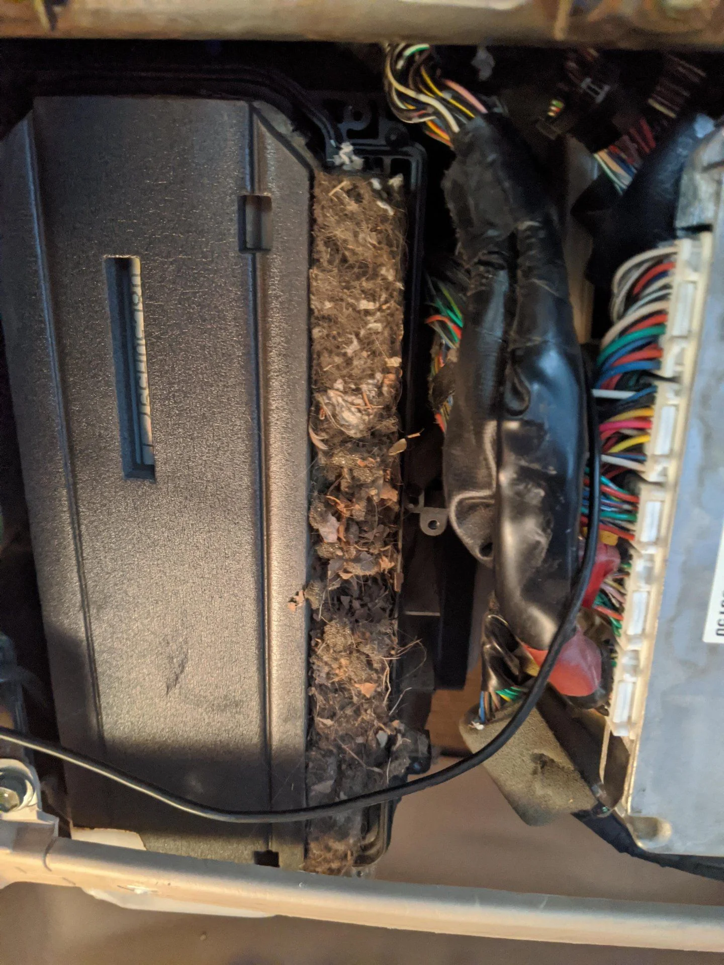

Replaced the blower motor as there was a crack in the housing of the OEM one, and it made an obnoxious sound on high. Also unboxed the TJM T17 bumper getting it ready for install. Seemed like it was very well packaged. I was curious what the welds on the bumper were going to look like and was a little surprised at how good they looked. Not the same quality as Trail Tailor or I would imagine Slee or Dissent, but consistent and even.
Installation parts

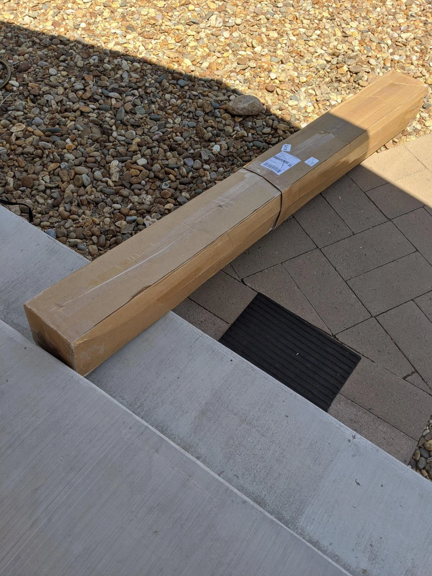

The bumper was packed well and with some huge styrafoam blocks 1.5' cubed probably.

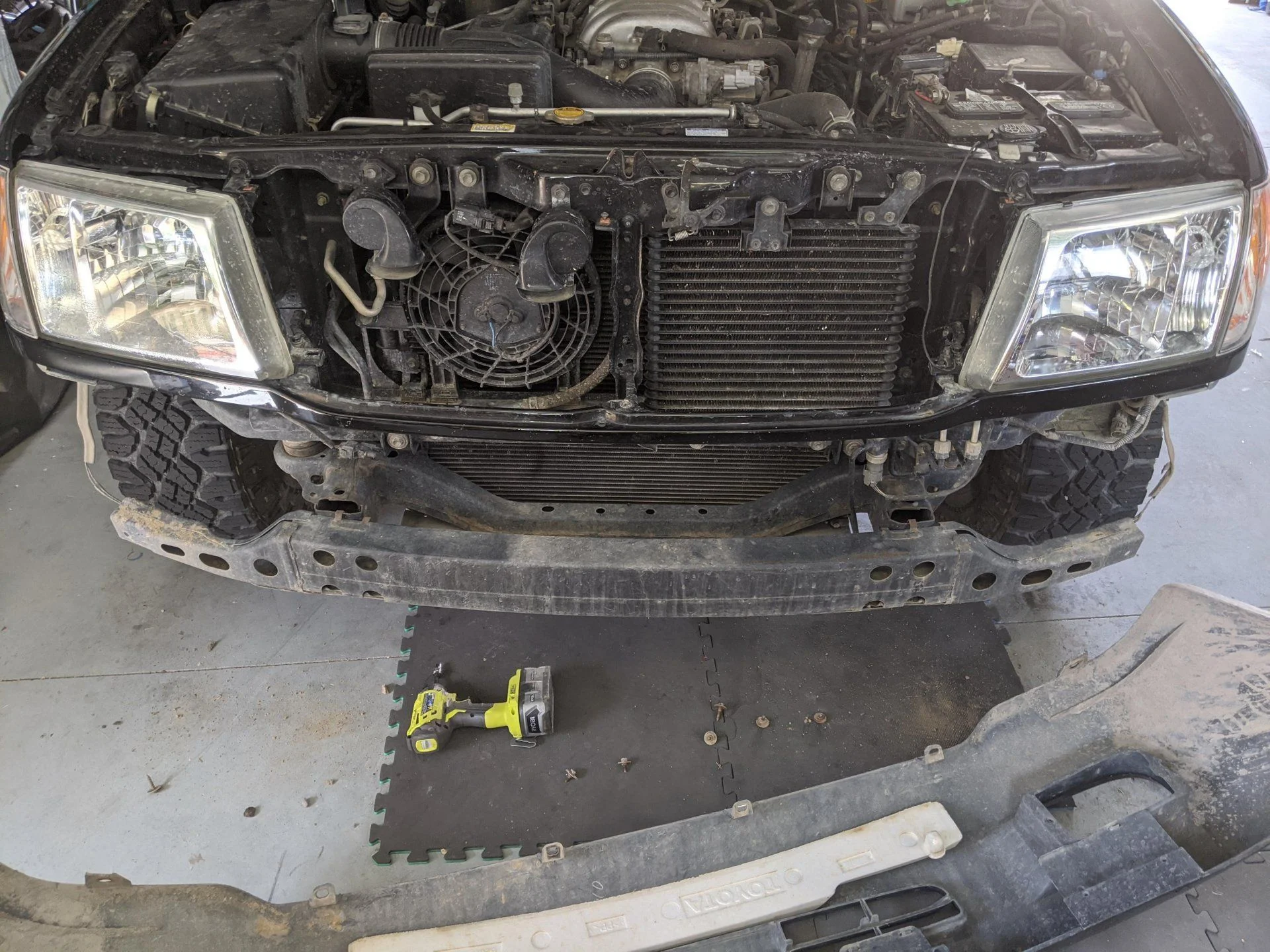

Removing the winch plate, my wife walked in while I was doing this and sighed then said "modifying it ALREADY?"
Touched it up with a bit of sand paper and some brushed on paint.
OEM bumper removed and winch plate install.

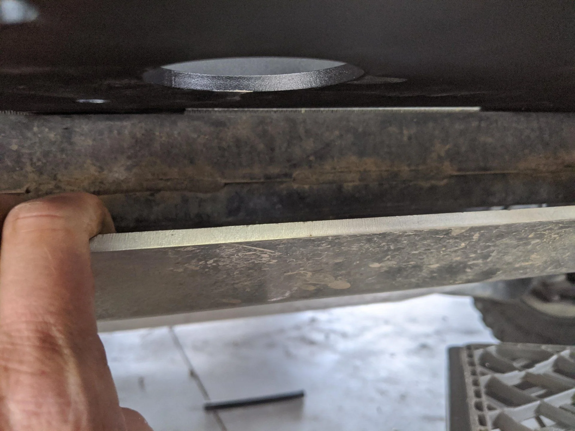

I did have to drop the front of the skid plate to install and it is going to have to sit about a 1/3 of an inch lower. I also installed the bolts for the back of the winch plat upside down to help with fitment and the Asfir skid.

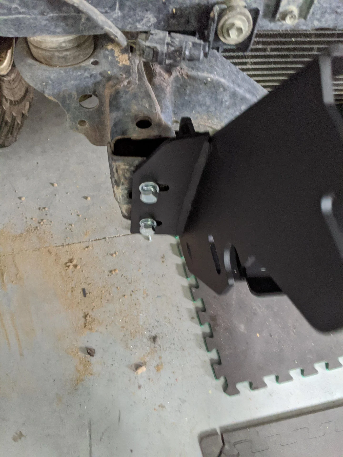

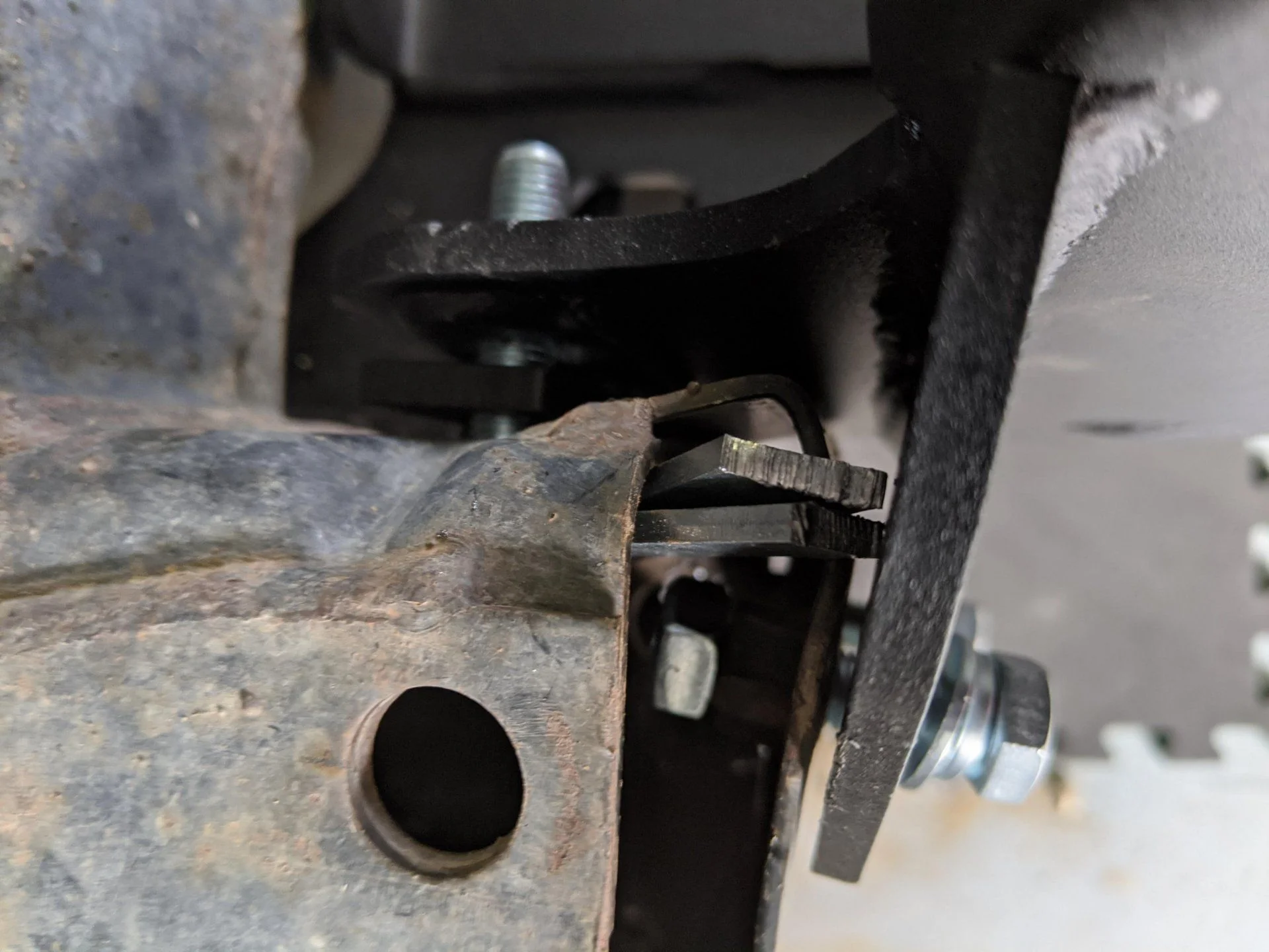

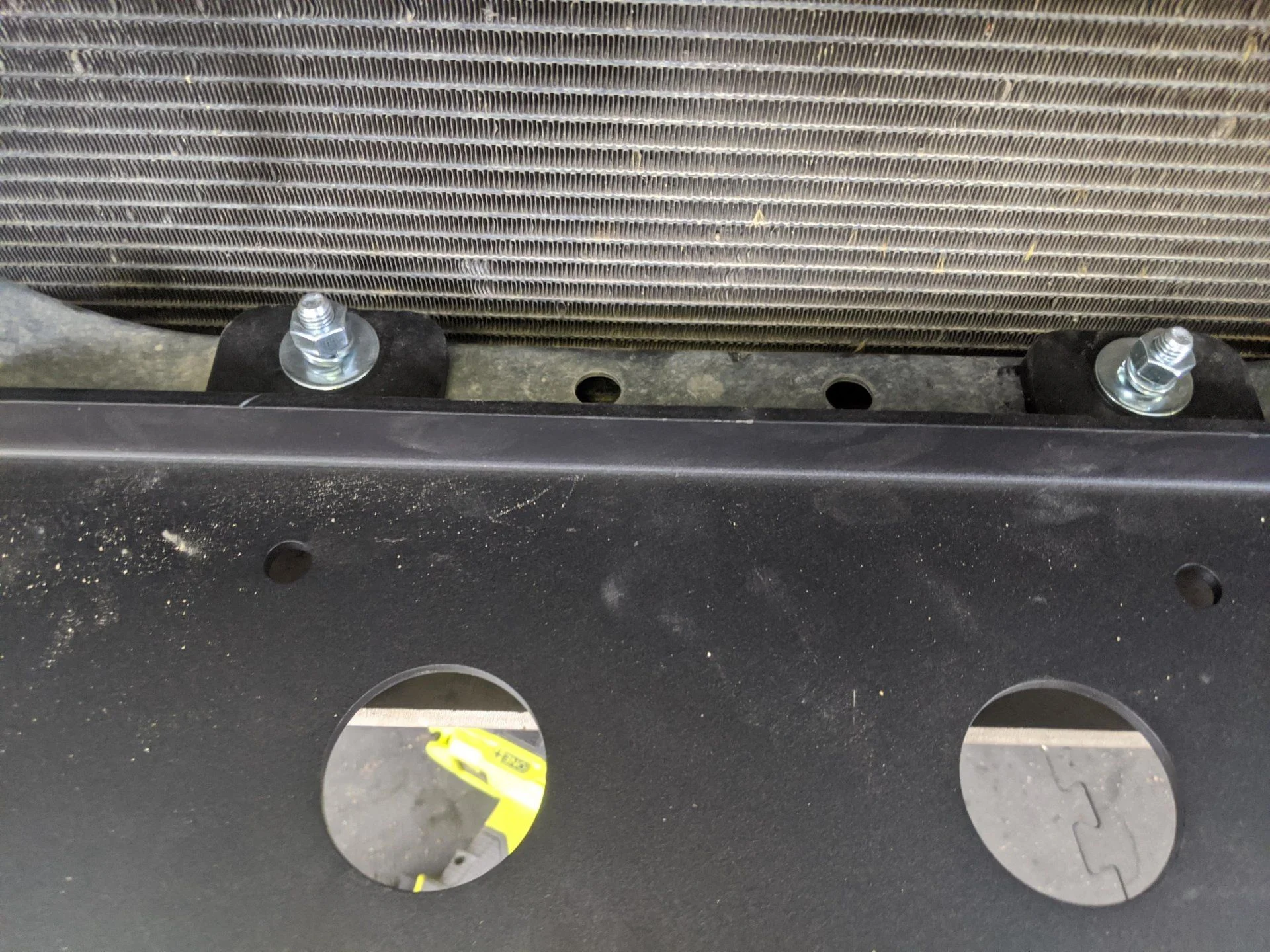

Mounting horns for the bumper on. I had to drill out two of the capture nuts on the front of the frame and get some longer bolts and nuts. Broke my stretch of not going to the hardware store. First time in 4 months.

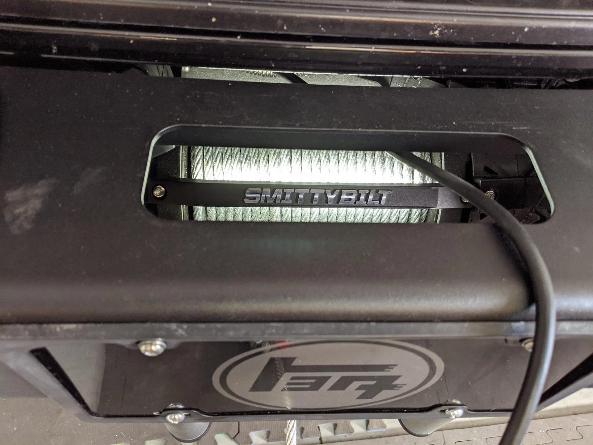

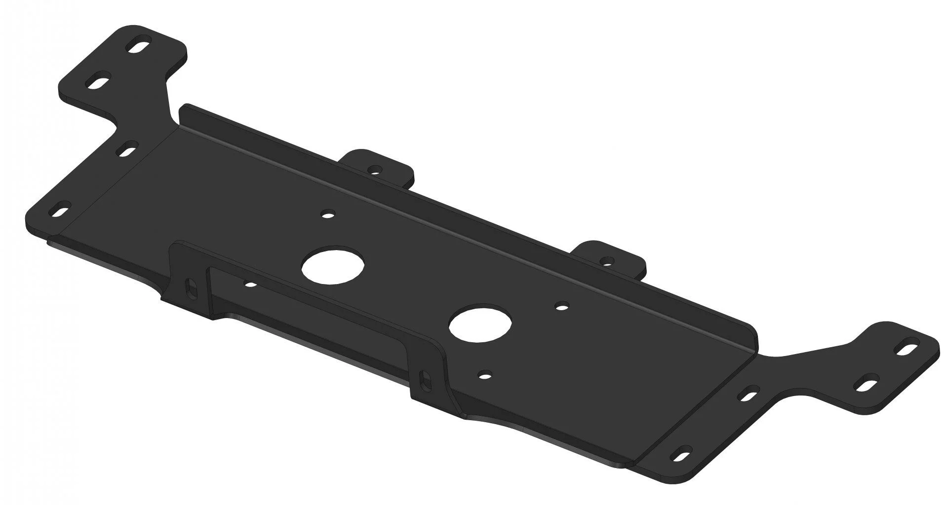

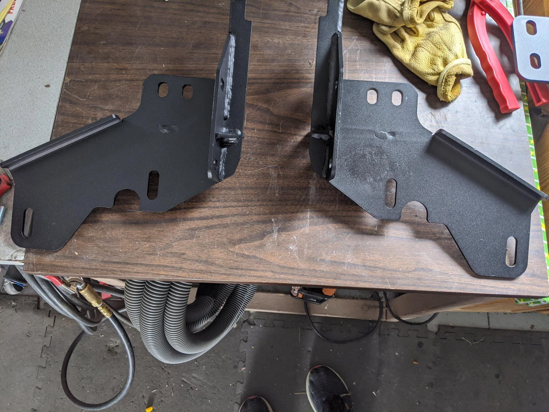

This is what the winch plate looks like.

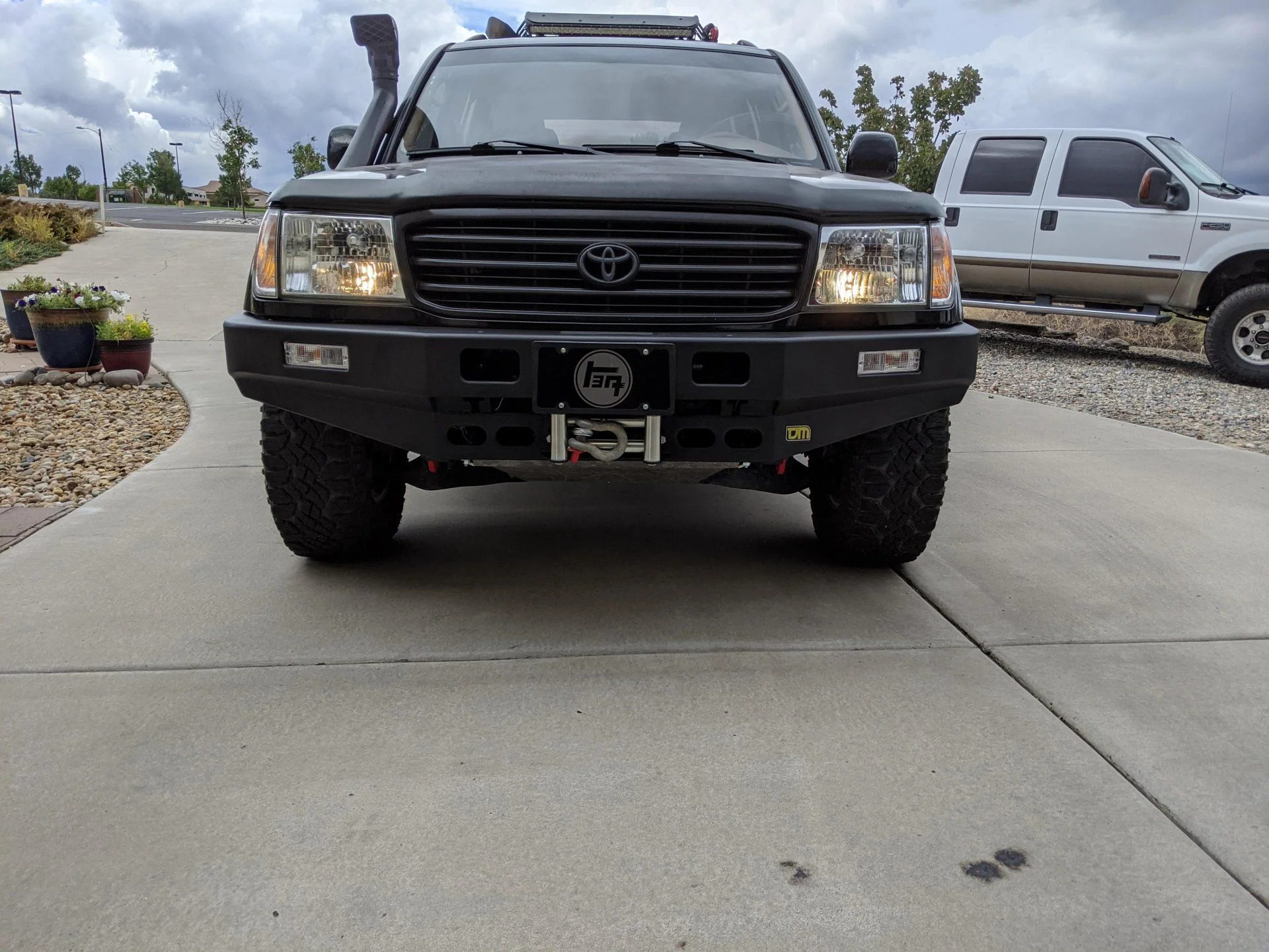

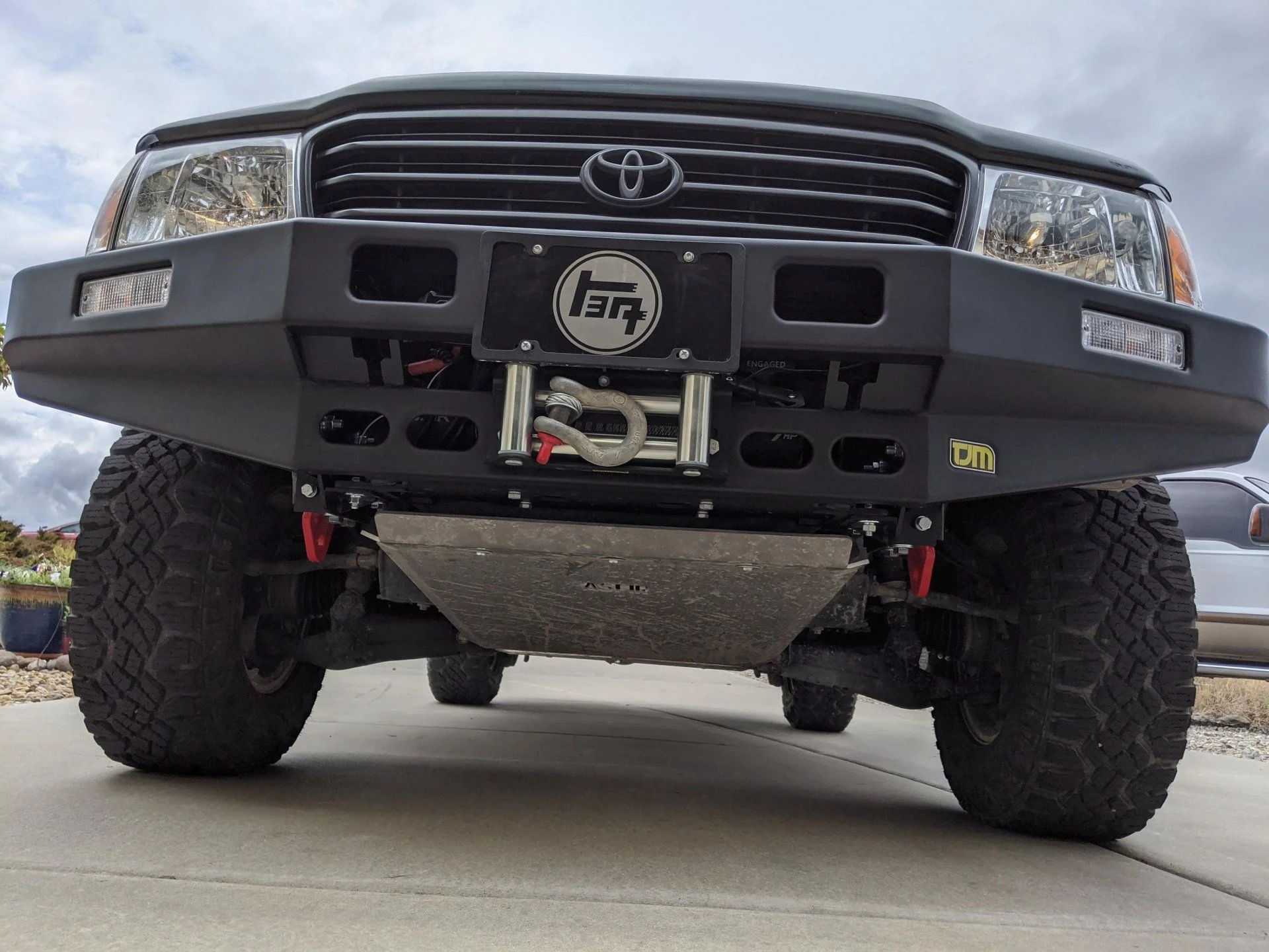

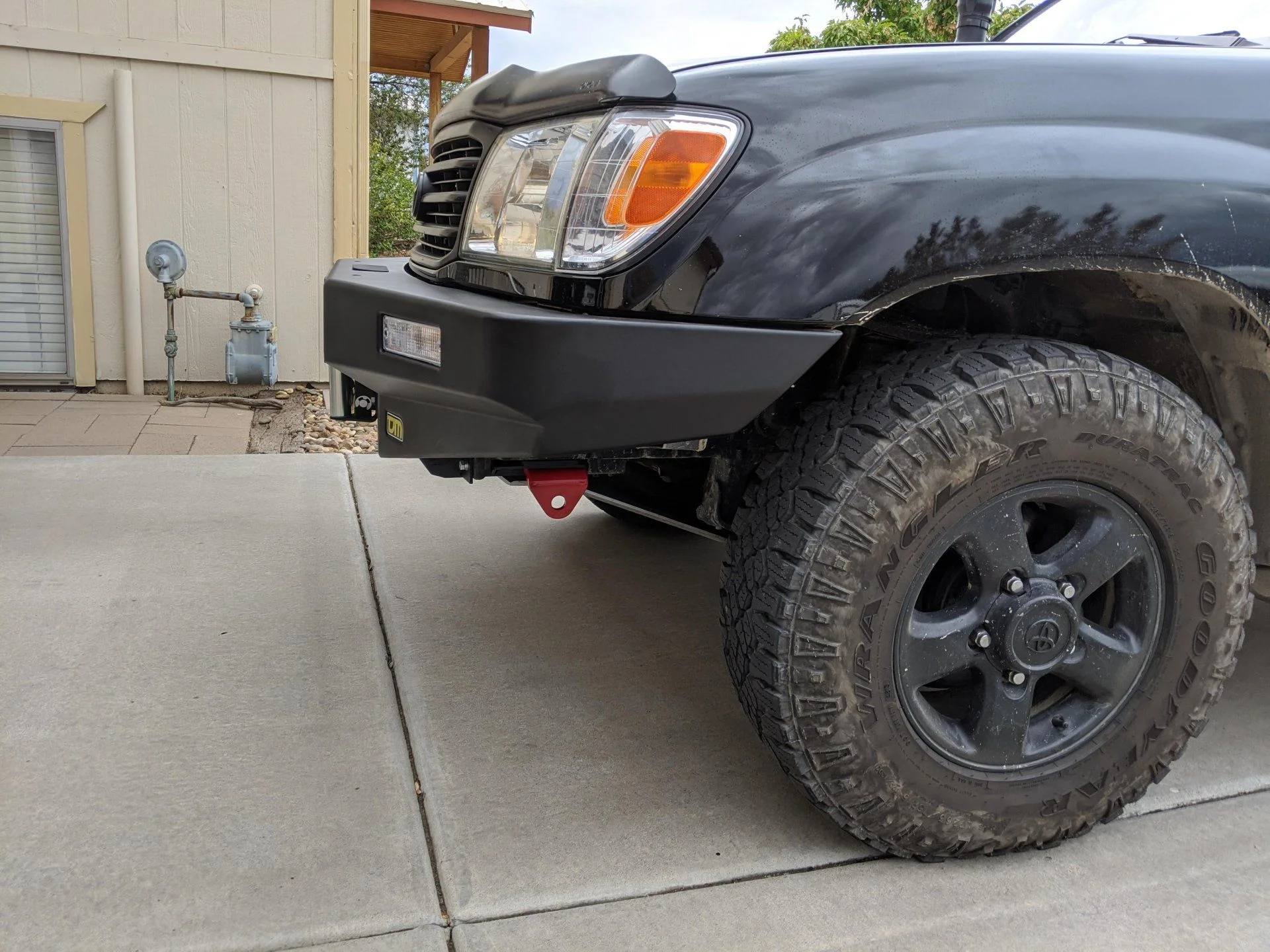

Couple more install pics of the TJM T17 front bumper.

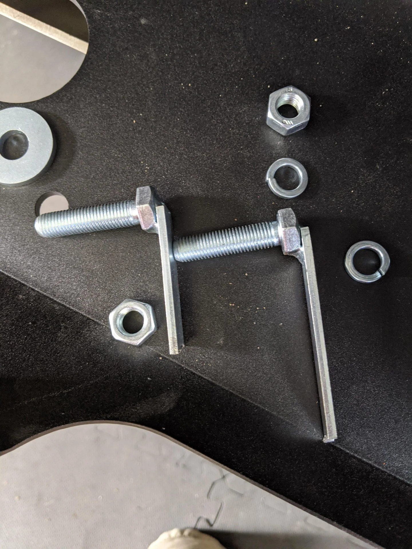

I found it necessary to cut these bolts with tabs down to get them in the ends of the frame.
Had to mount the winch relay box above the motor and backwards in order to be able to plug in the controller from the access point.

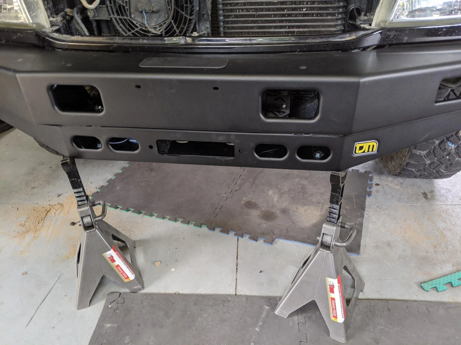

The last time I will be using these jack-stands. 😏
