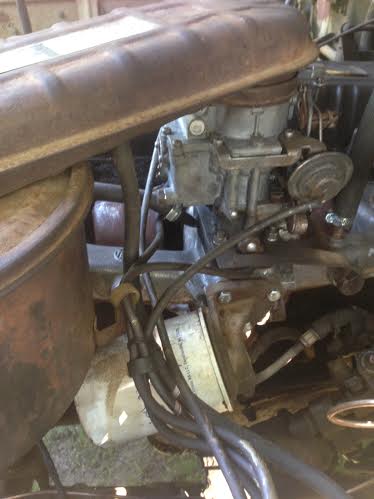

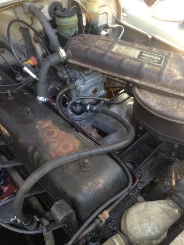

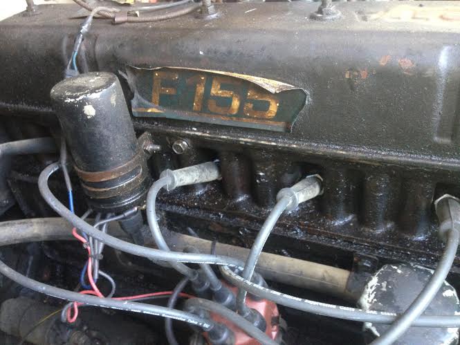

Just picked up this 40, Nov 1969 build date. Was shocked to see the F155 sticker on the side because I had assumed it would be a F145 as it was before the domed pistons. Is this correct or did a PO swap something? The guy I bought it off only had it for two years and couldnt tell me much. Thanks!
View attachment 1289806 View attachment 1289807 View attachment 1289808
I see the valve cover didn't have a oil fill cap on top at the front. Once the side oil fill tube went away the fill was on the valve cover. Seen the F155 sticker on valve covers without the fill cap.

@ryanwk628 this would be a F155
