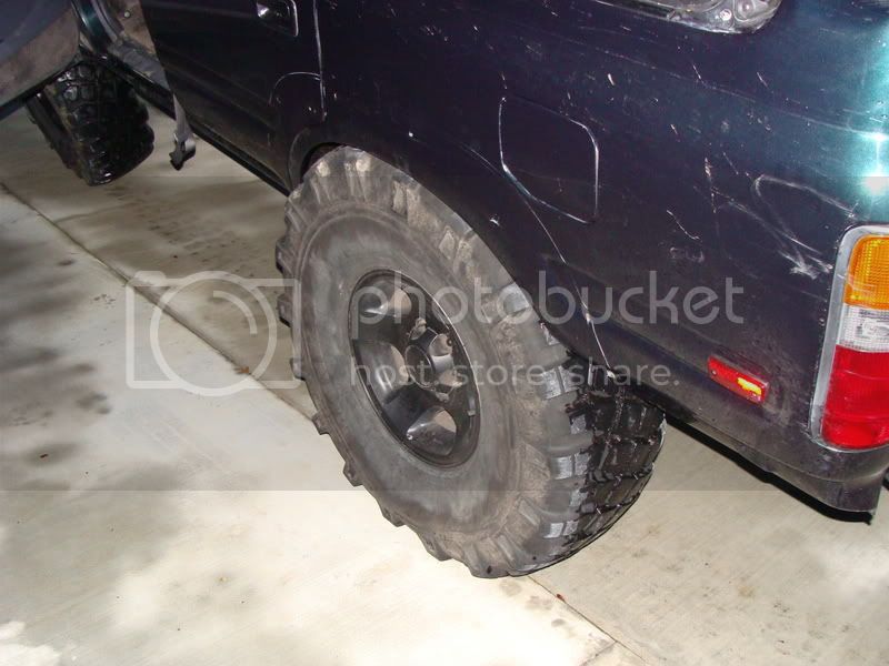

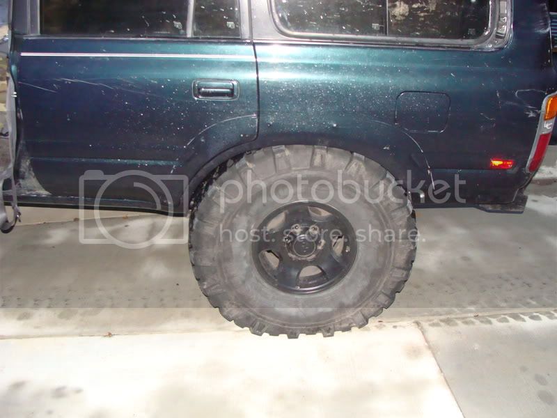

I dont have the slee arms yet so did some sheetmetal work to clear the tires at full stuff ill have to get some pics

:whoops: My bad....the tires I'm getting are just like these in the pics...the XML 325/85/16's not the XL 11.00r16.
Same 38.7" tall but about an inch or so wider!
I think they will actually be 2 inches wider. The XML's are 13" and the XL is almost 11" wide. Same height, like you said. The thing with these military michelin's is they actually sit and measure 38.7" with the LC weight. That's because they are rated so high (weight wise) as opposed to Super Swampers.

Well I got my 325/85r16 XML's today!
