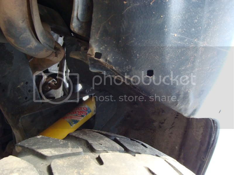

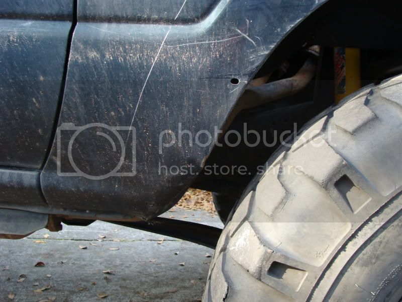

I'm running a 2" suspension & 1" body lift.
Bump stops are 1" front & 2" in rear.

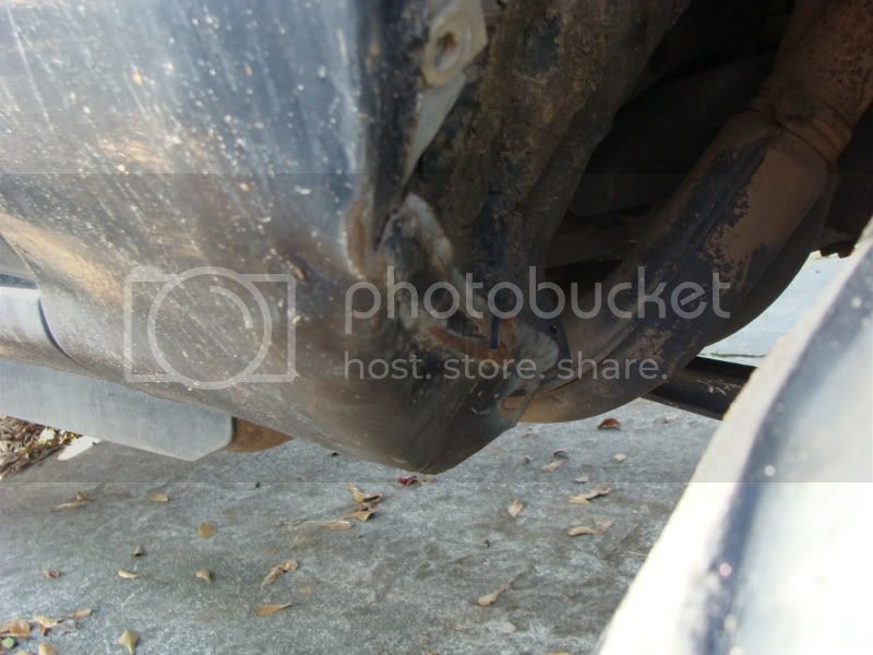

The front fender have been trimmed 2" & moved axle forward 1".
The rear fenders have been pie cut only in the aft section.
Caster corrected via eimkeith weld on drop brackets. 50mm down 30mm forward.
Tires are 38x13.5r17 MileStar Patagonia MT on 17x9 3.5" BS wheels.
I guess with that sand paper traction rock you could get those things to grip pretty well out there, but I would still cut them up as much as possible.
