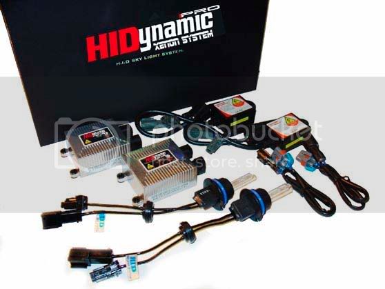

The aftermarket HID/Zenons i use on my LX are by Hidynamics. I like this system because it is just basic plug and play type install. The Pro kits includes 2 ballast, 2 ignitors, 2 bulbs. In our case it is the H1 bulb for driving and H3 bulbs for the fog lamps.
The install in an LX for driving lights is approx 25mins. Just remove your old bulbs, replace it with the HID bulbs, find a nice mounting spot for the ballast/ignitor (both of which are pretty small in size) and plug everything in. Simple as that. The fog lamps are even easier. You could mount the ballast just about anywhere because its water proof.
The Hidynamics Pro kit comes in 3 differnt color temps.
6000k-bright white
8000k- crystal blue
12000k- brilliant purple
I can get the kit at a resonable price. 320 shipped just about anywhere.

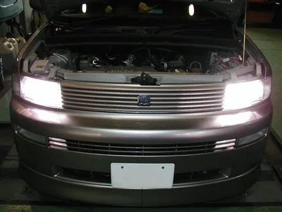

Oh, btw, I've posted this info. before, but those with 35w HID's should "upgrade:rolleyes: " to 55w like the pics below:
Pic 1: 35w/4500k
Pic 2: 55w/6000k
Pic 3: Kit
Some stats: 35w/4500k gives out 3200lm, but the 55w/6000k puts out 6000lm! :eek:
Pic 1: 35w/4500k
Pic 2: 55w/6000k
Pic 3: Another comparison
They have been tested for the same durability standard that is applied to the 35watters, 2000 hours.
They are made in Japan, too. Not that it means that much anymore. ;)
