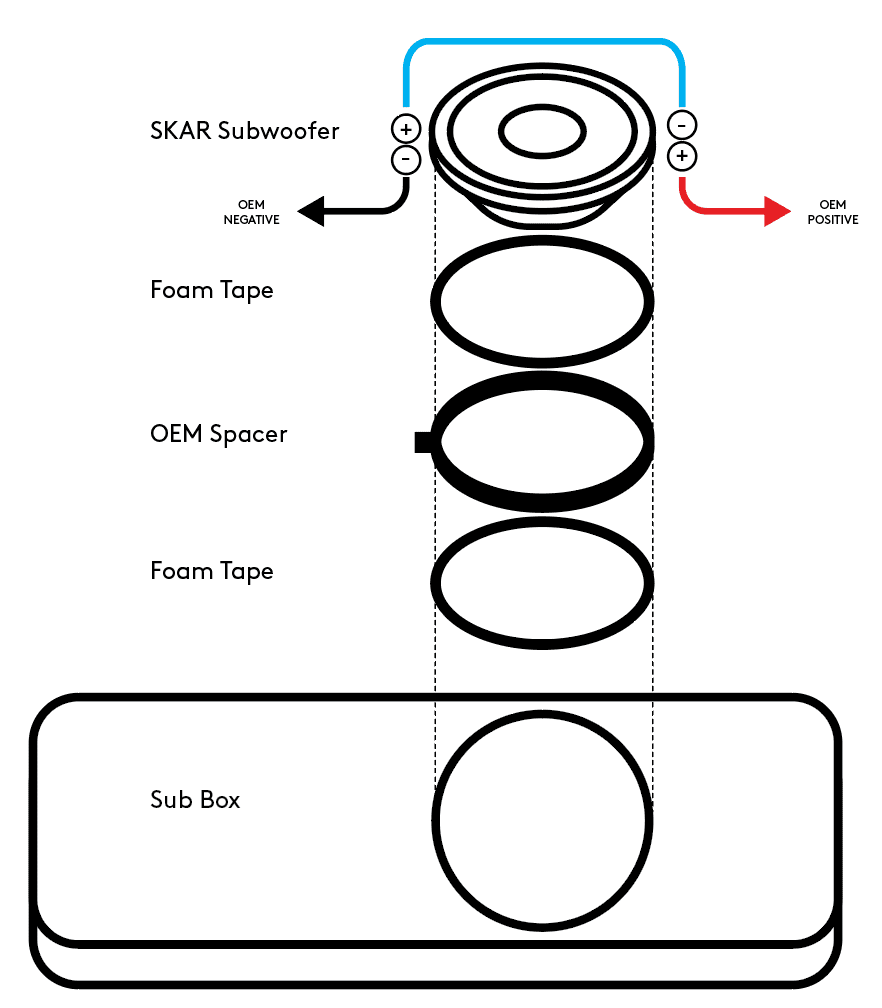

I just did this weekend and wired it in the 8 ohm configuration. I had a refoamed ML sub before in my 2002 LX and it was great until the voice coil blew, and this new SKAR sub is a great replacement! It hits really hard. You do not need a soldering iron, you only need one wire and four female spade connecters to wire the sub to the existing wires and to wire in the 8ohm configuration. Remember to wire to the opposite sides and not the same side when wiring in a series like I did. I used a dremel to cut away inside the sub box to fit the SKAR and then reused the spacer from the ML sub to avoid using silicone. It sealed up great. Below is a quick diagram of how I reinstalled using foam tape in between the spacer and the sub and there are no leaks.
