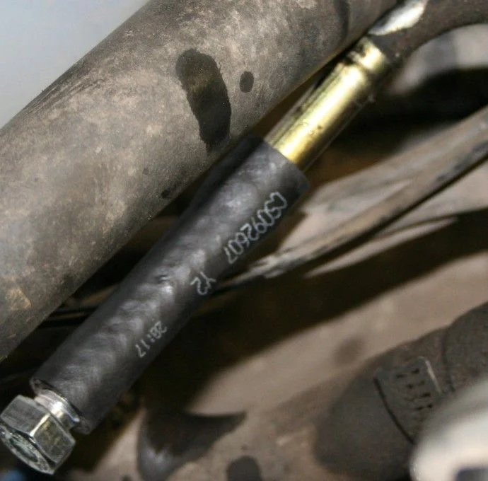

Find the return line to your reservoir. It will NOT be a hard line, threaded connection. Just a nipple with a soft line and a clamp (first picture).

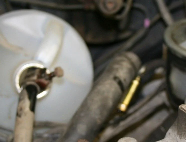

Undo the clamp, slip the line off, and put it into a jug that will fit down by your manifold and steering shaft (second picture; kind of blurry, sorry).

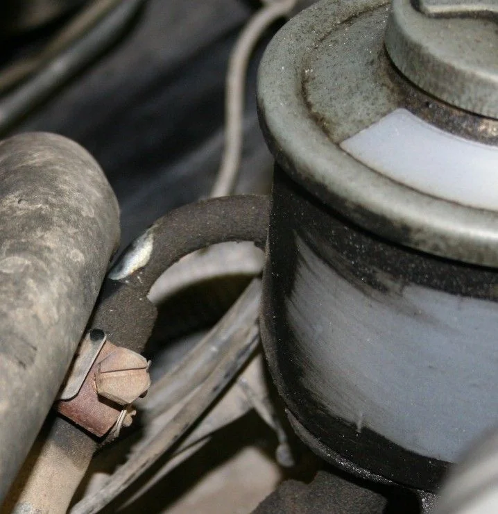

Get a piece of tube that you can seal the other end of (third picture) and put it on the nipple of the reservoir.
