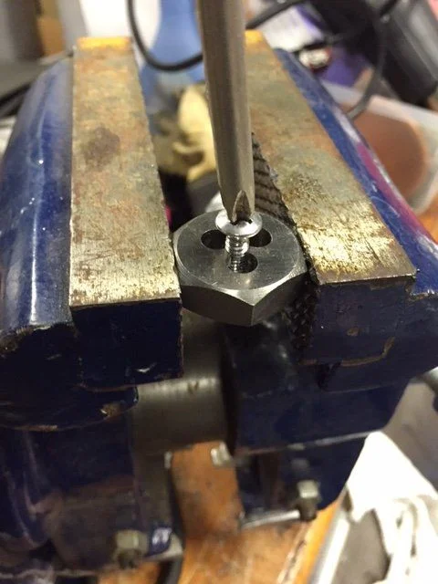

-Put the die in a vise upside down and clamp it down fairly tight. You need it upside down to completely re-thread the screw.
-Use cutting oil with the standard screws and start working in and backing it out until you finish. Take your time.
-It will not take much force but you will need to push down fairly hard

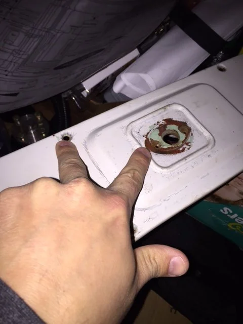

Mine were located here....

Here is another look at the rear hatch. You need 8 screws for the cover and 2 for the handle...

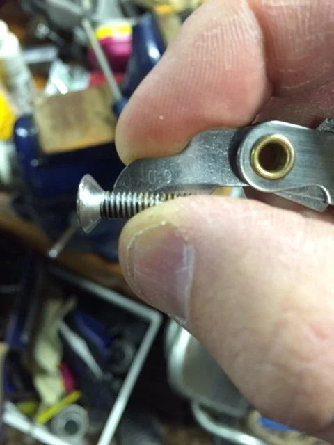

Here is one of the old screws and my thread checker...

Note the die upside down. I am working the 10-24 screw into the M5x.9 die...

Here is the finished screw. The screw on the top is the one I made. It works flawlessly. I would recommend doing this for finish pieces and nothing substantial (i.e. engine parts, etc)...
