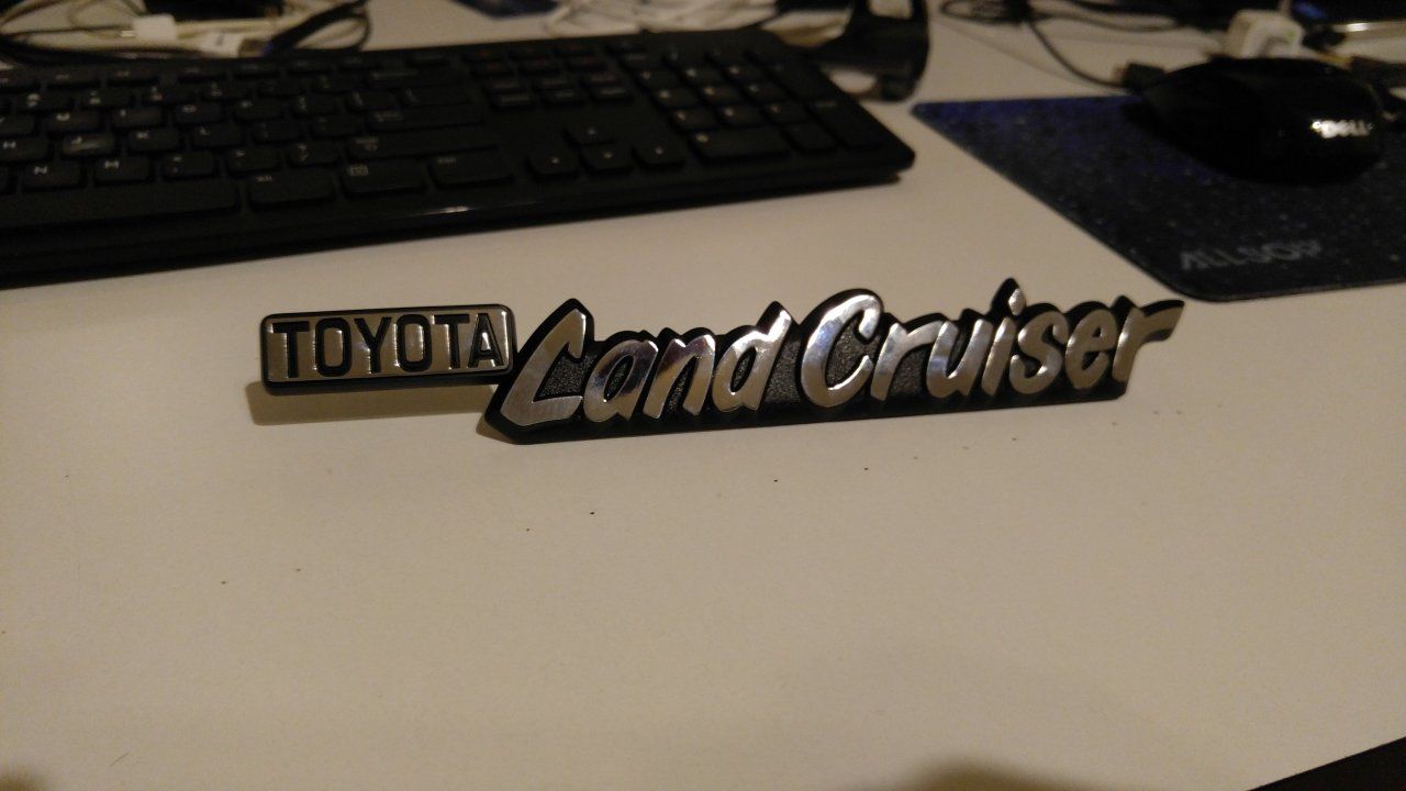

This may be a dumb question, but I just bought these new OEM side apron emblems to put on the FJ40, I'm not exactly sure how. Or maybe I am but am just worried to break the emblem. Do I need to widen the wholes so that these little black grommets will fit in there? The previous OEM ones had some metal grommets holding the emblems in but broke off; but those were quite a bit thinner.
I think the solution is probably drill baby drill but I just wanted to make sure before I did it.

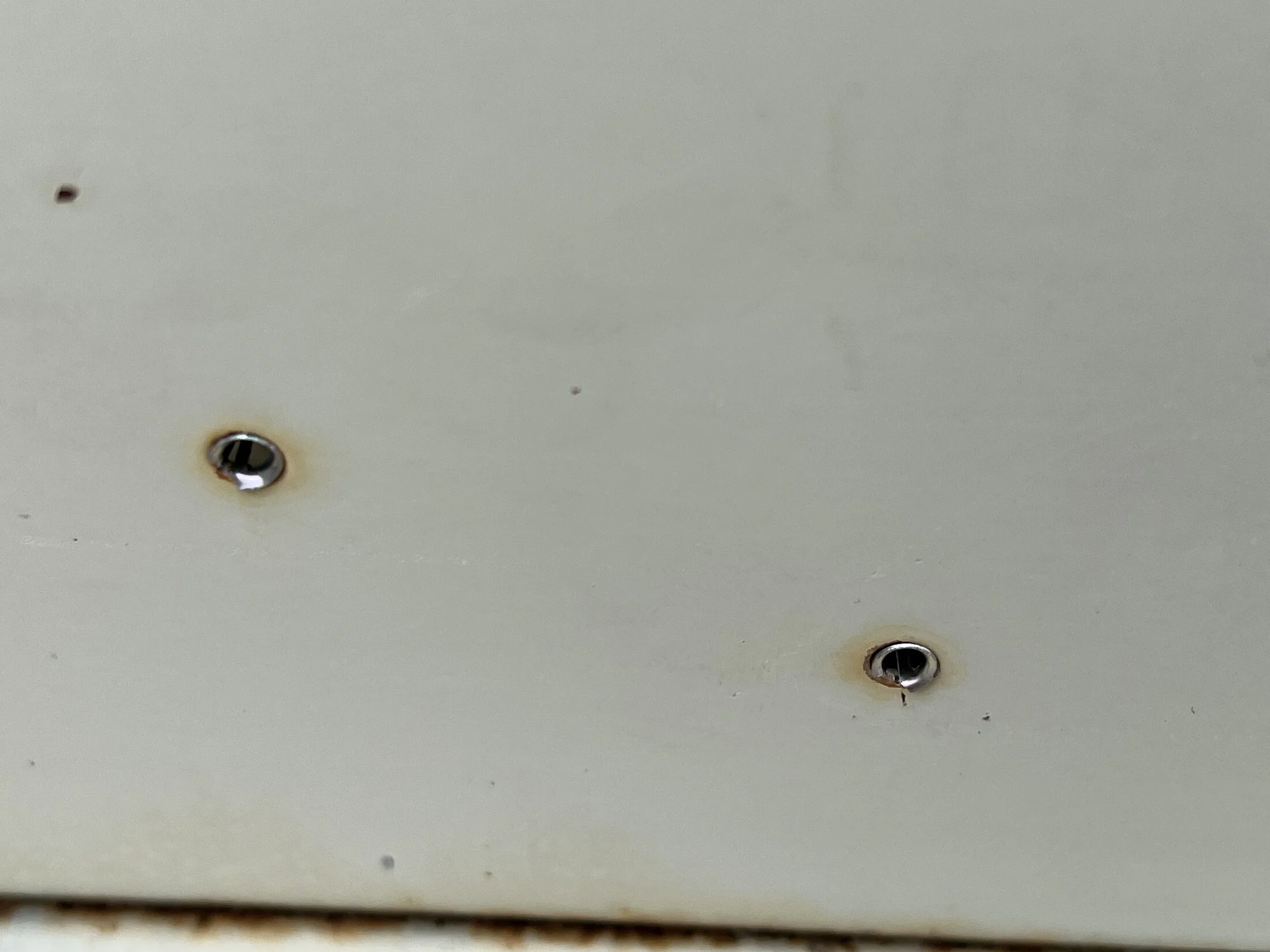

I strongly recommend you exchange the part instead of drilling holes into the body. It's better to have no emblem!

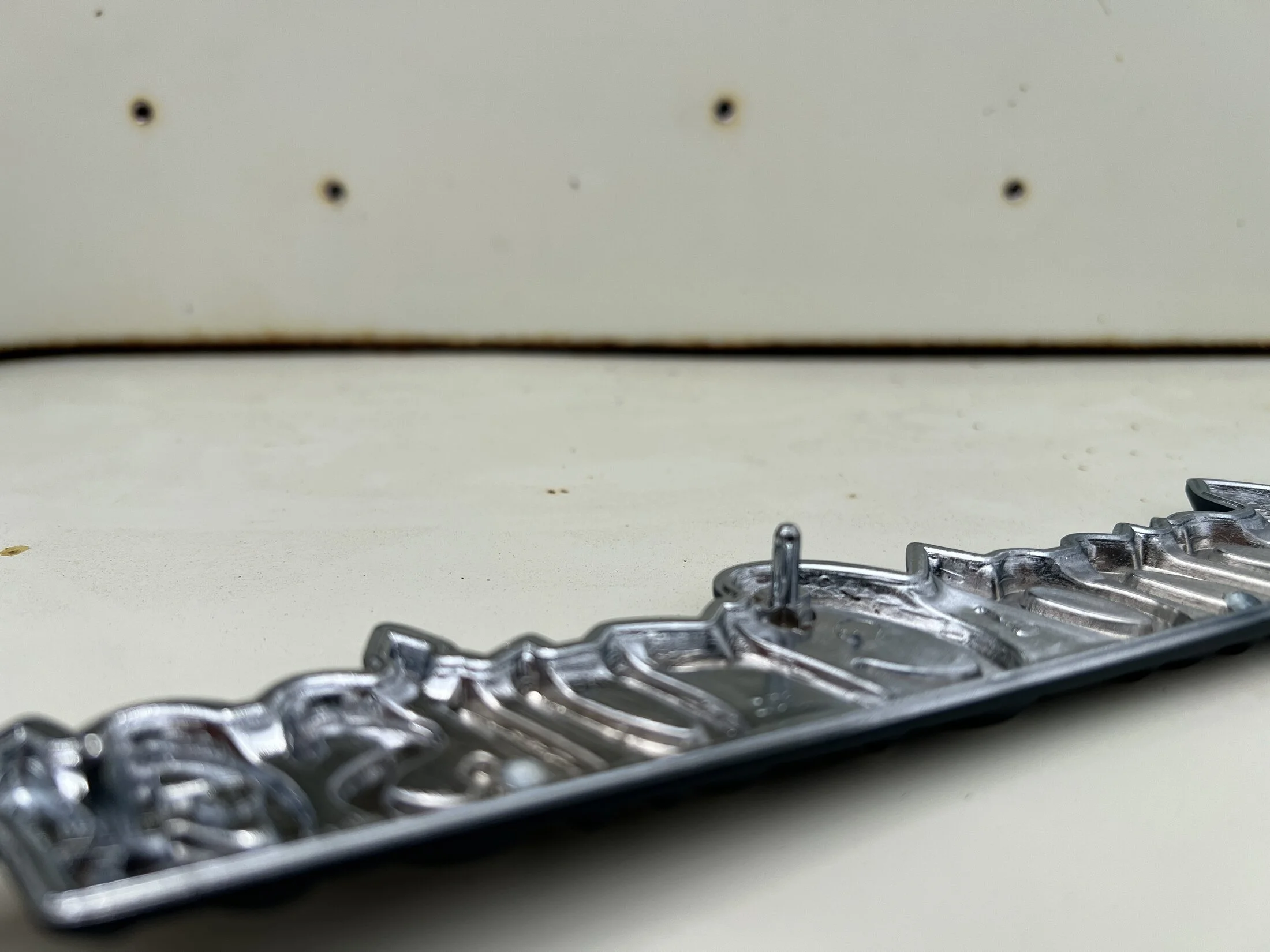

I have the same exact problem. Mine is a 79 and the prongs broke off the back side of the emblem. I am going to order from racer. How did you install the emblem once you received the correct ones? I can’t find anything that says to just push them on and into the holes without removing the grommet or to remove the grommet and reinstall from inside the engine bay. Any help would be appreciated, as I don’t want to break anything.

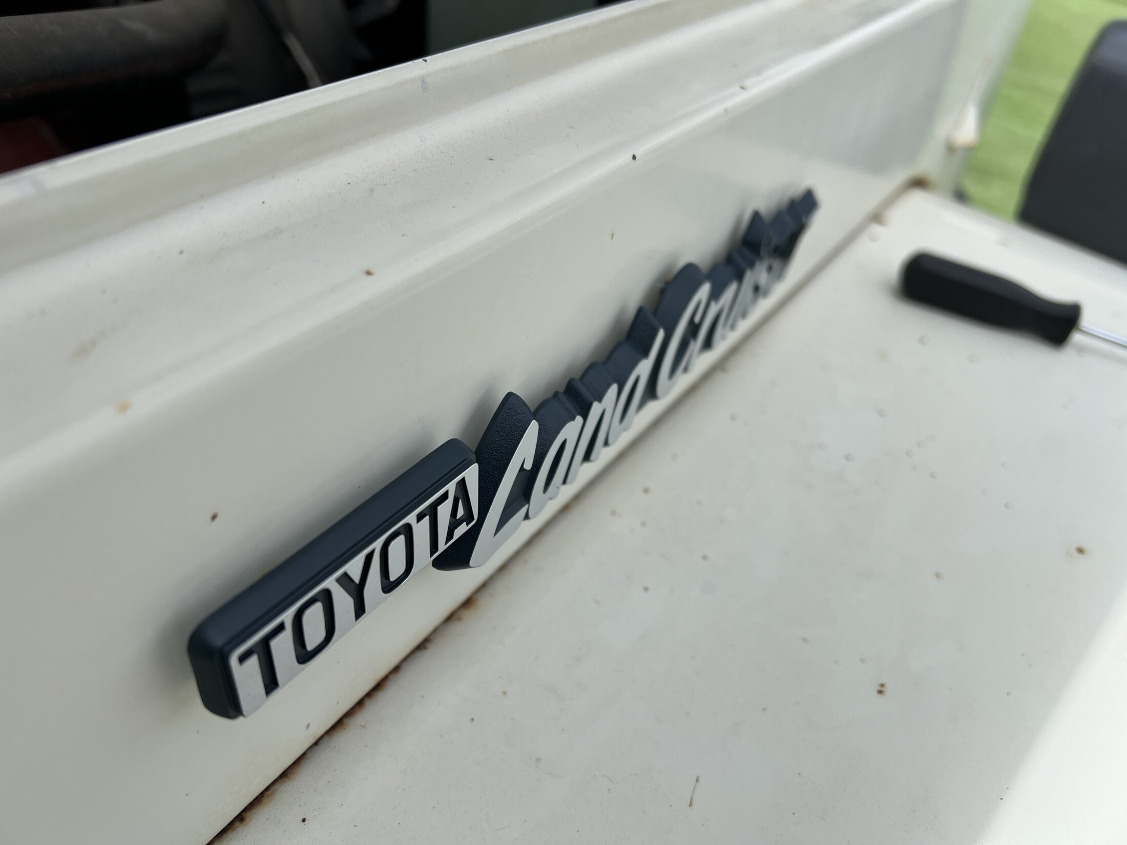

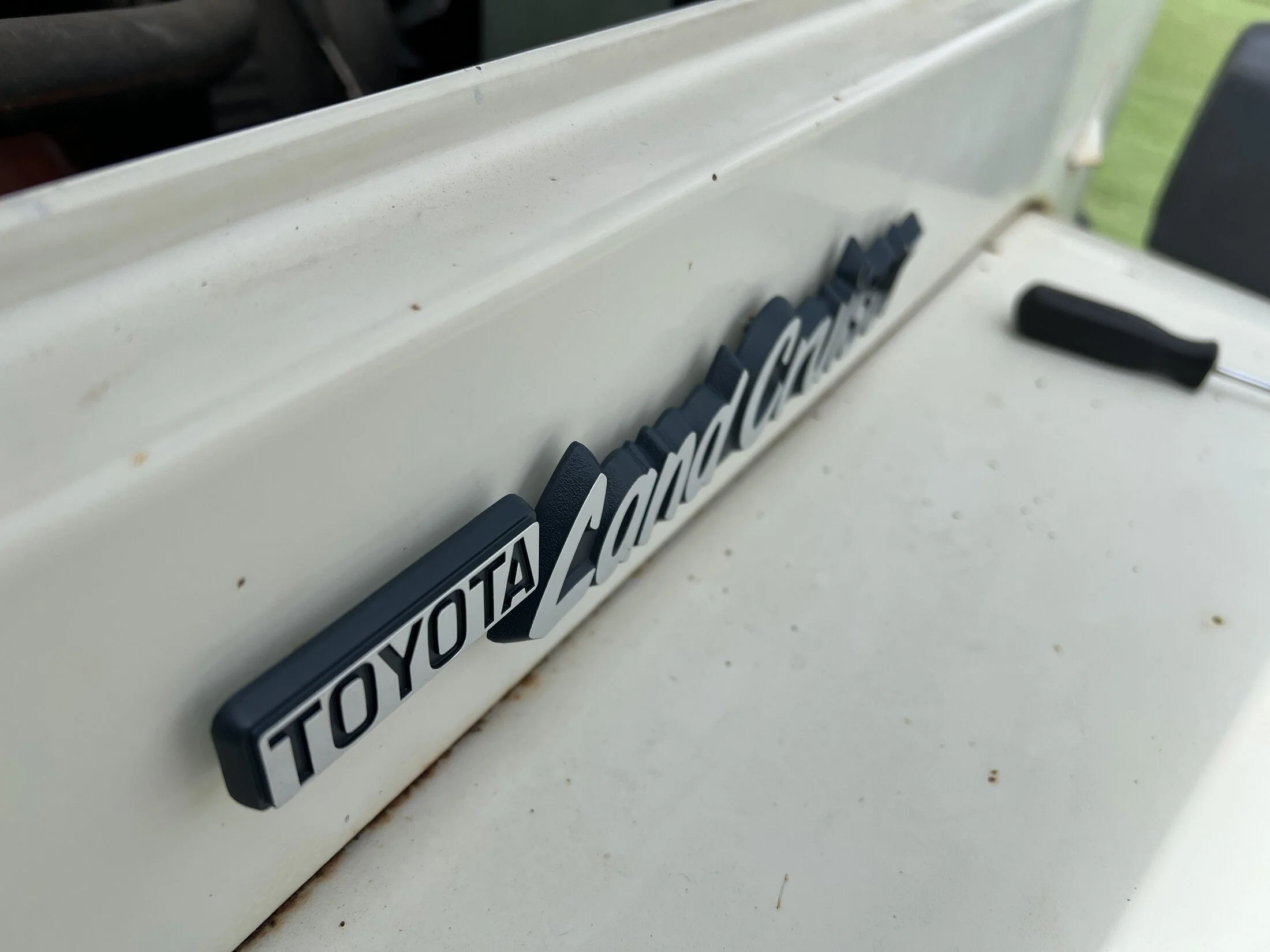

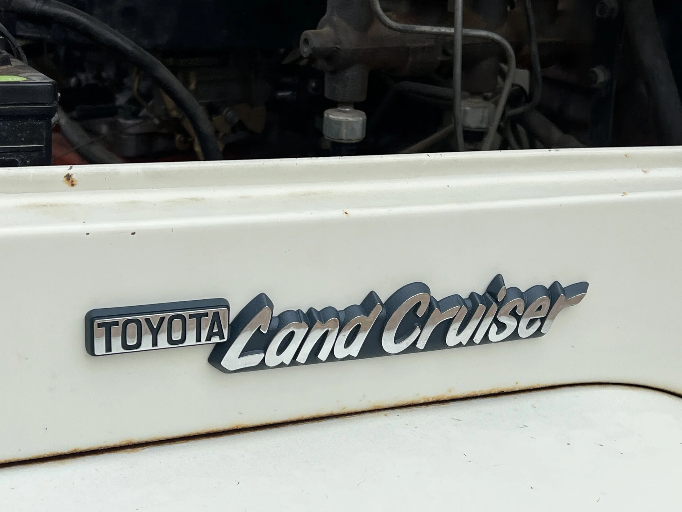

If yours is like mine, and it sounds like it is. You don't have to remove any grommets. They're these little metal grommets and you just have to push them through the holes all together. It's sort of hard to see by my picture, but the metal grommets should just squeeze through holes and then expand thus keeping the emblems pressed on. Just make sure you're not using too much force and try to push them all in just a little bit. So don't push one end in completely and the other end of the emblem is not in the hole at all. It should be fine though and you shouldn't have any problems.

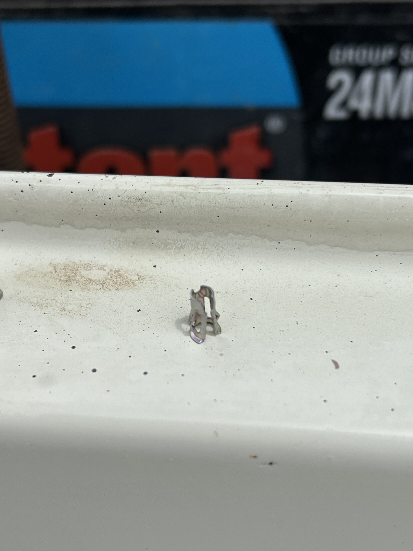

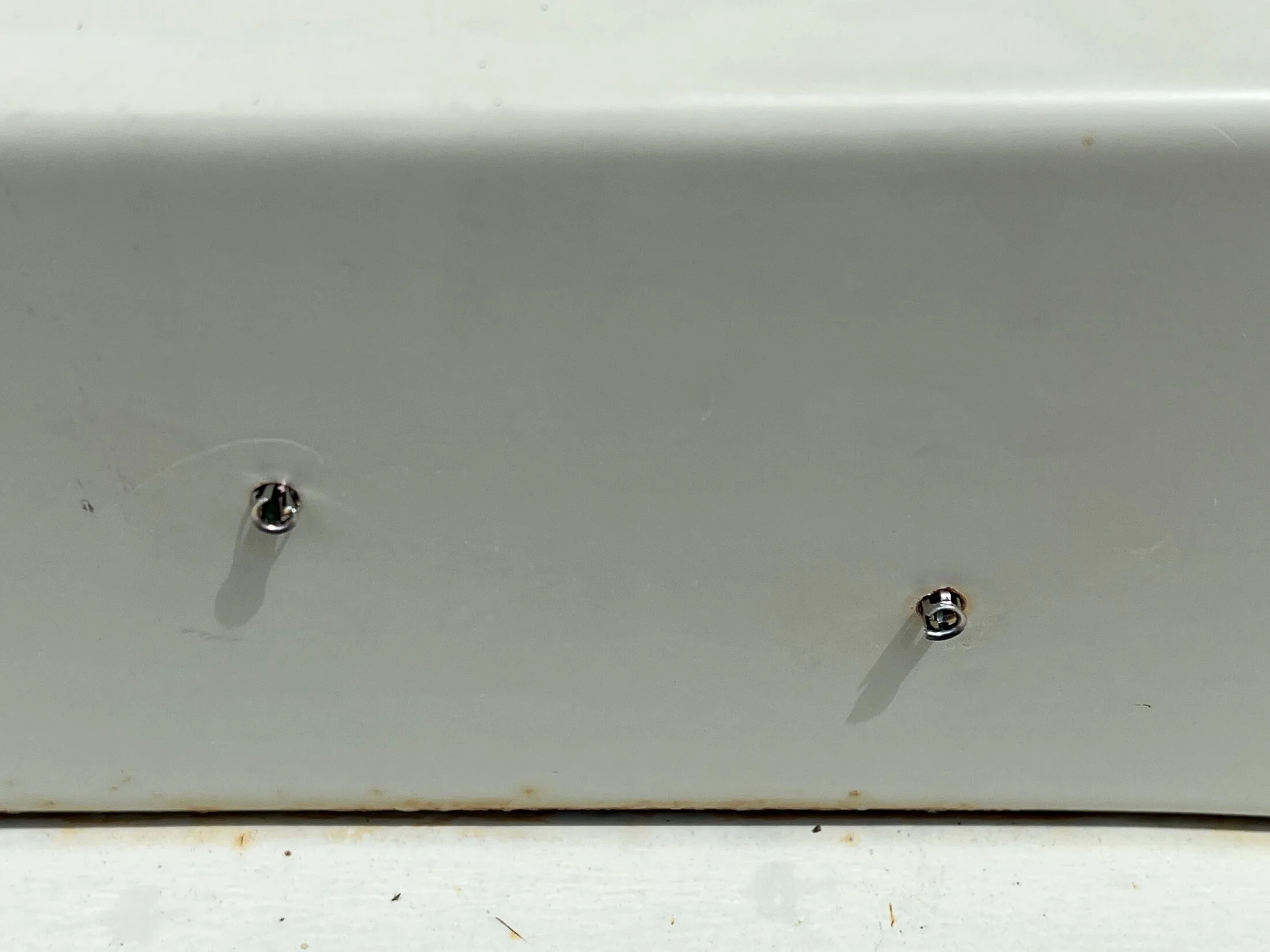

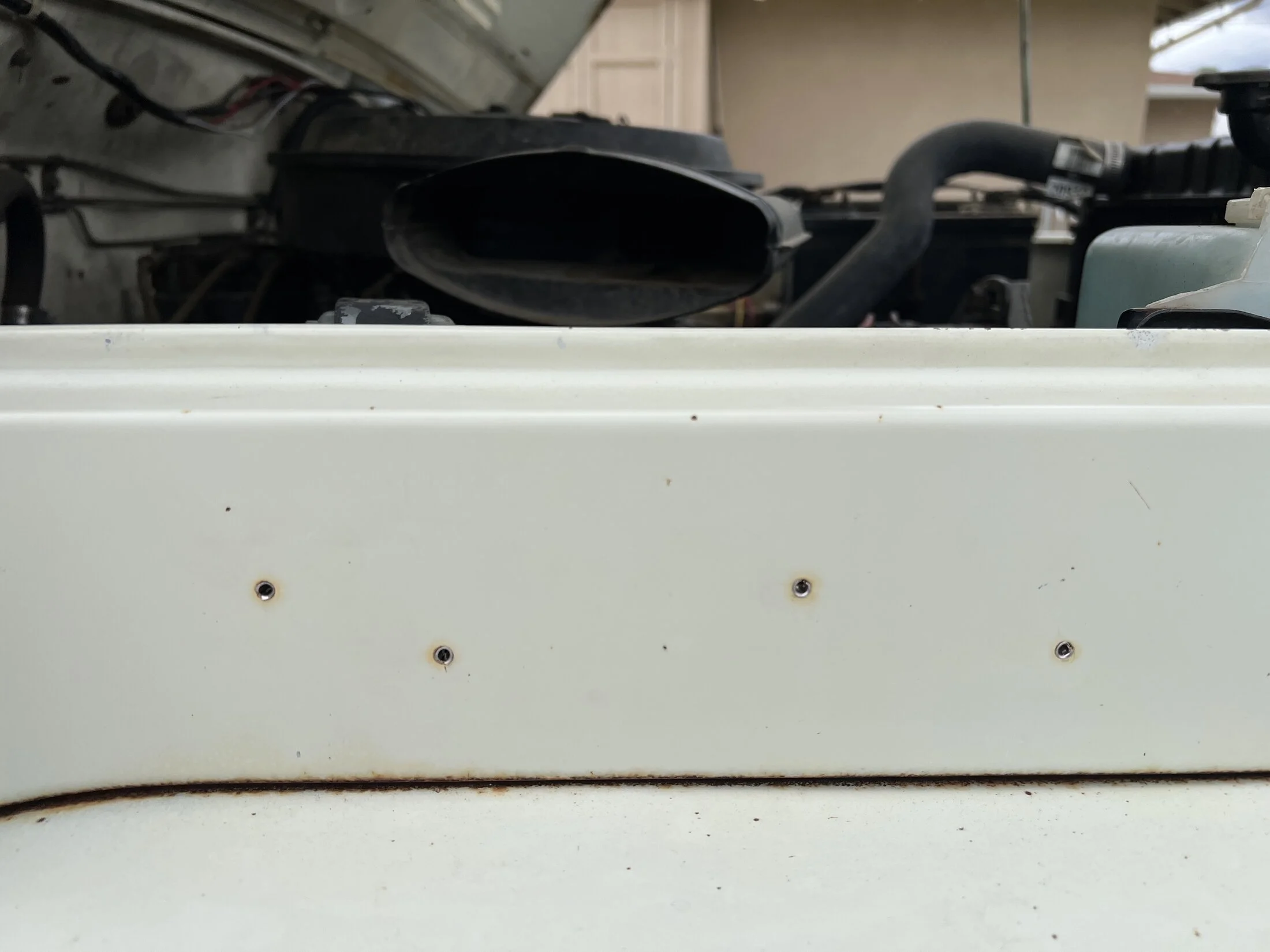

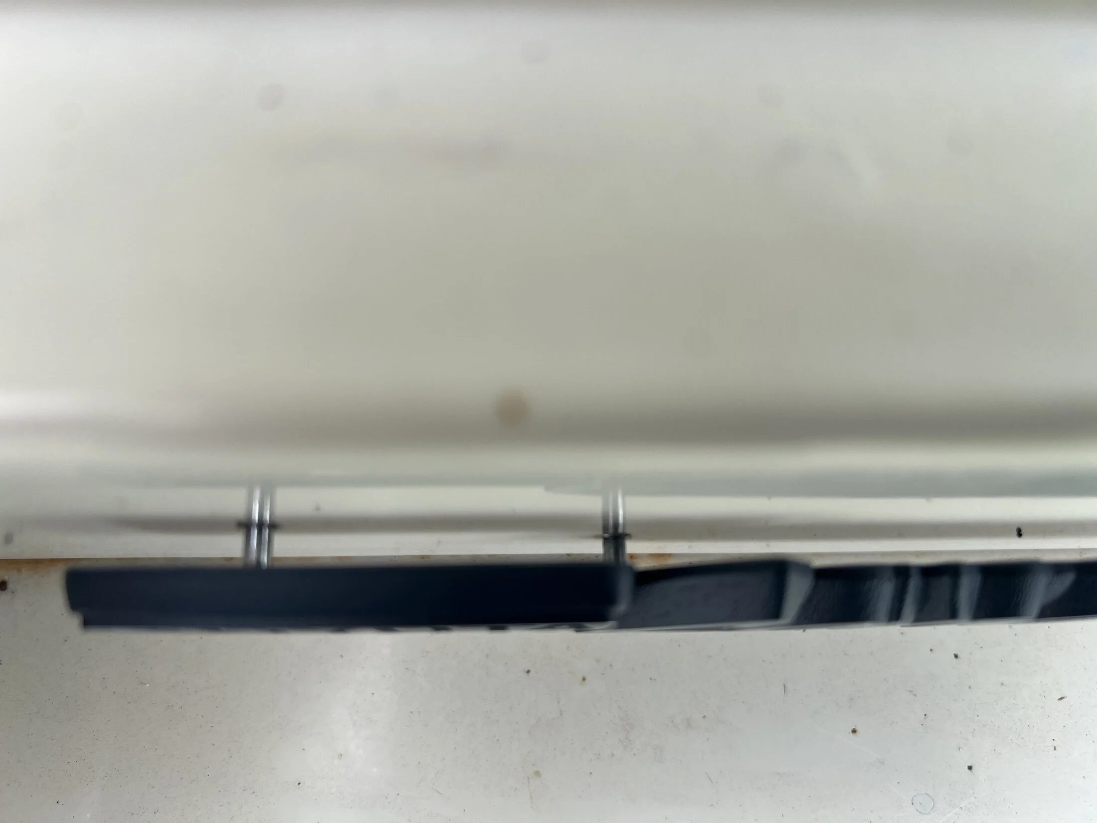

For anyone installing these emblems, remove the little metal insert from the plastic nub, and THEN install the metal insert into the apron by itself. They pop right in. Then, once all 4 clips are in the apron, press the emblem in. This will keep you from breaking the emblem trying to install it with the clips on….
