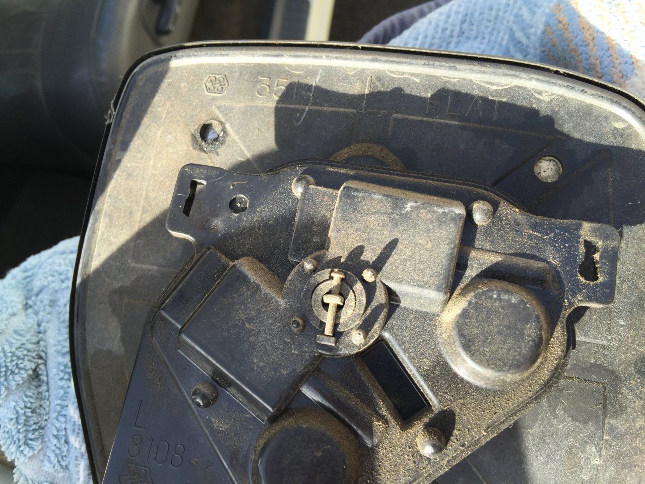

6) Put everything back together as you found it and reconnect the wires. If you are facing the glass of the mirror, from left to right the colors are Black, Red, Brown. Here is a picture of the BACK of the motor plate from another thread (This is for DS; order of wires is reversed for PS):

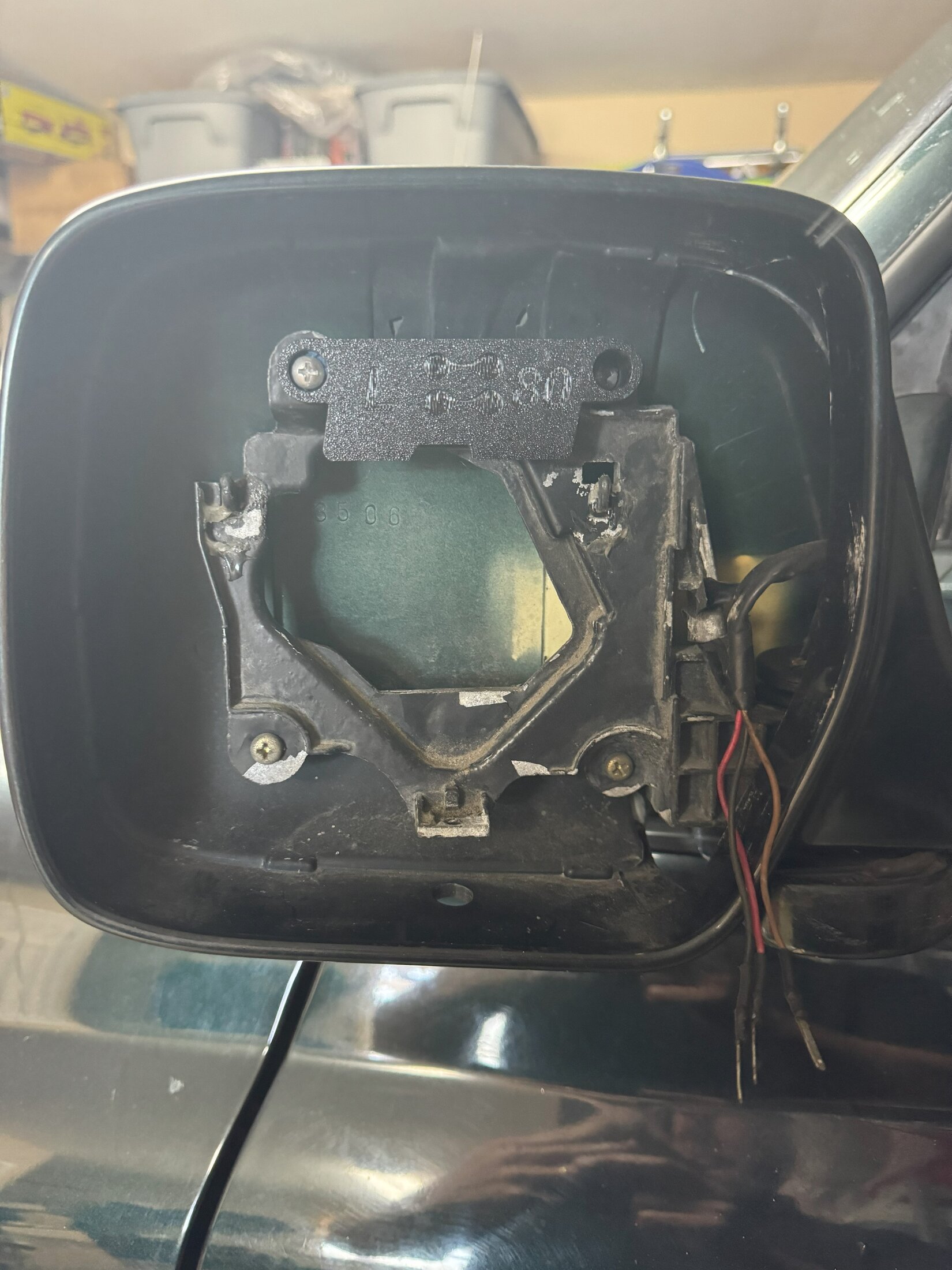

I ran the wiring through the post and ran it through the spring since the second washer was going to be at the top.
I then ran the wiring alone the fastener and made the wires point down like so.
Notice on the above pics that the washer, lock washer, and the two nuts have been set in place.
What's cool is that you only need slight pressure down on the spring. You'll notice that even a small amount of tension makes it work as it should.
Put everything back by reversing the steps. Pretty chill.

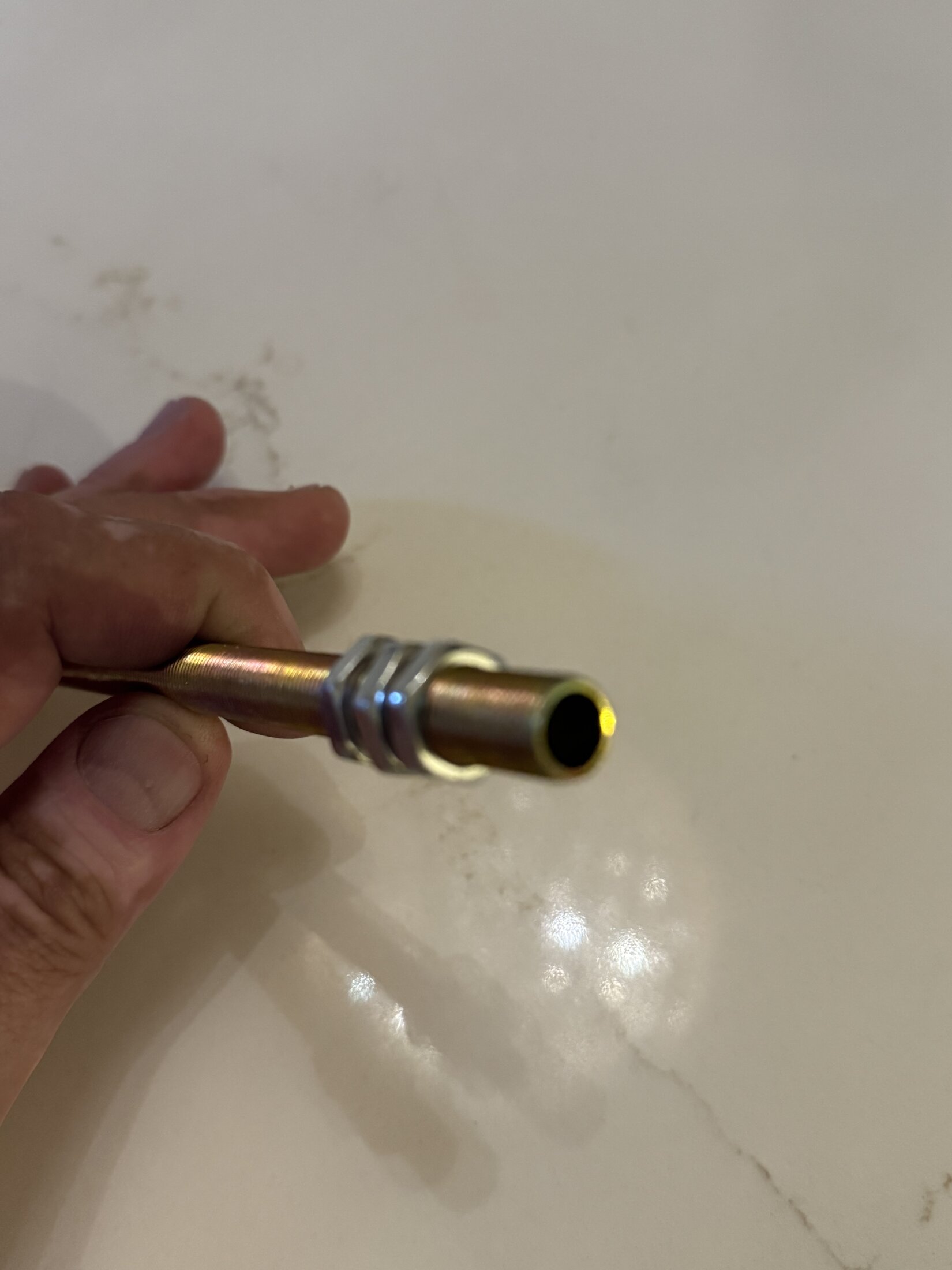

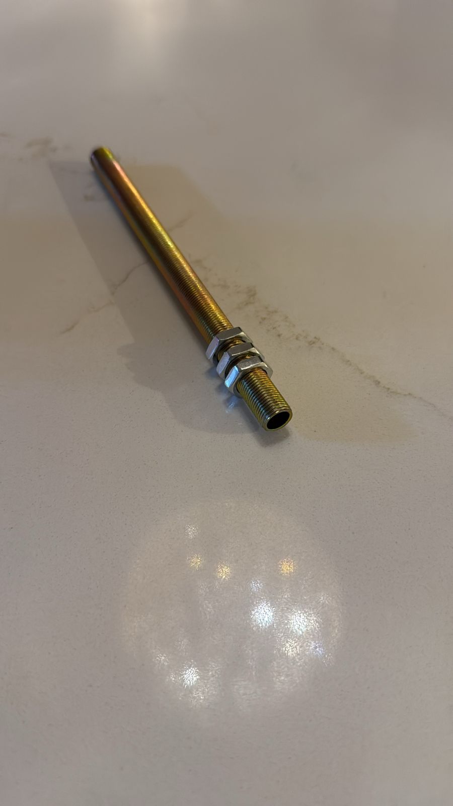

Hello there I found a better solution and still can run the wires easily, instead of screw and nut , I use the screw similar to the one of a roof lamp , but buy a longer screw and cut it to the right size , I am attaching a picture of the screw and nuts , you can figure out for sure how to replace the proposed screw and nut with this one !!!
