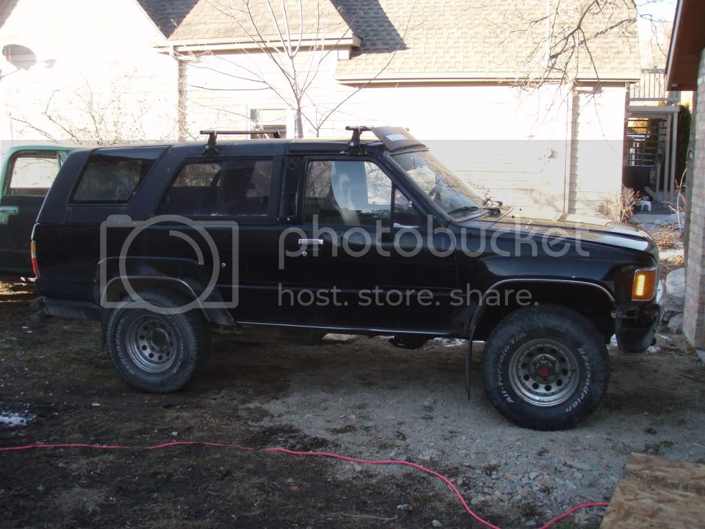

Hey guys, ontop of other issues, of course, my stock springs are dead. Which should I look at doing? Zuk mod or stock springs? I am on a budget and for now it is my dd and not a huge trail rig, although I would like to hit the hills a little and would use this as a hunting rig. Also, should I look at Ball Joint Spacers to keep it leveled? or would I really need that with just the Zuk or stock springs replacement?

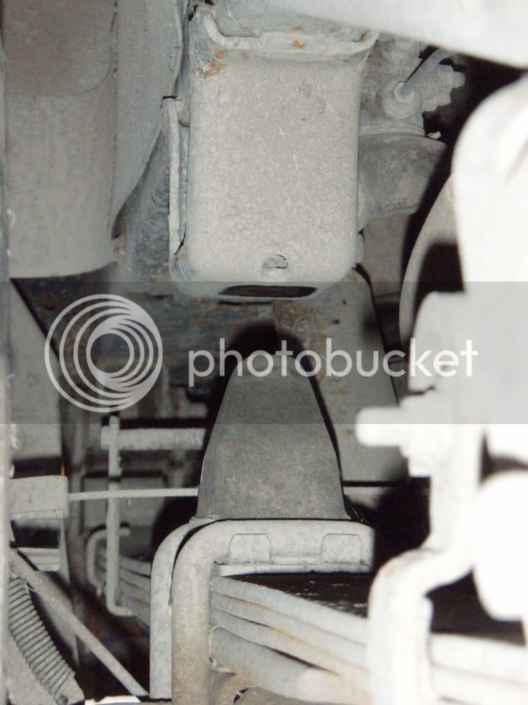

Here is what a ZUK mod is.
Toyota gear install

look i have a geto set up on my leafs, to level my truck because one side collapsed bad,
and any one who thinks that doing a zuk is going to give you a better ride, you need to think this through, you are still riding on leafs, the zuk is nothing more than a helper spring!
and if you are going to this at least get springs that will go over the piece on your frame, that s*** that was pictured in the link is dangerous that spring can and will come out when put under enough pressure, and a spring under preasure leaving its mounts is deadly!
... and any one who thinks that doing a zuk is going to give you a better ride, you need to think this through, you are still riding on leafs, the zuk is nothing more than a helper spring!
Correct, a coil helper.
Zuk is local, so some local rigs have this setup, have only wheeled with one and it worked well. The rig had add-a-leafs (helper springs), removed them and went with the coils, reports that it rides, flexes much better, very happy. I have never heard of one coming out. Not a big fan, but, it is a cheap, easy, effective mod, so has it's place?
If you go to the home page, at the bottom is links to others who have done this mod.
Toyota Gear Installs
not that it does not work i would rather the springs go over than to cut the bottom off, and stuff the spring inside but i guess you could fab it so it goes all the way around the spring.
i guess after seeing a coil shoot across a shop and total a metal roll up door, just makes me think more on it.
x2 - I think I would at least weld some type of post inside of the upper bracket so that the spring could not slip out. That metal will eventually have enough stress on it to open up and let go of the coil. Removing the center affected the strength of the sides. Placing gussets on both sides may also help!
