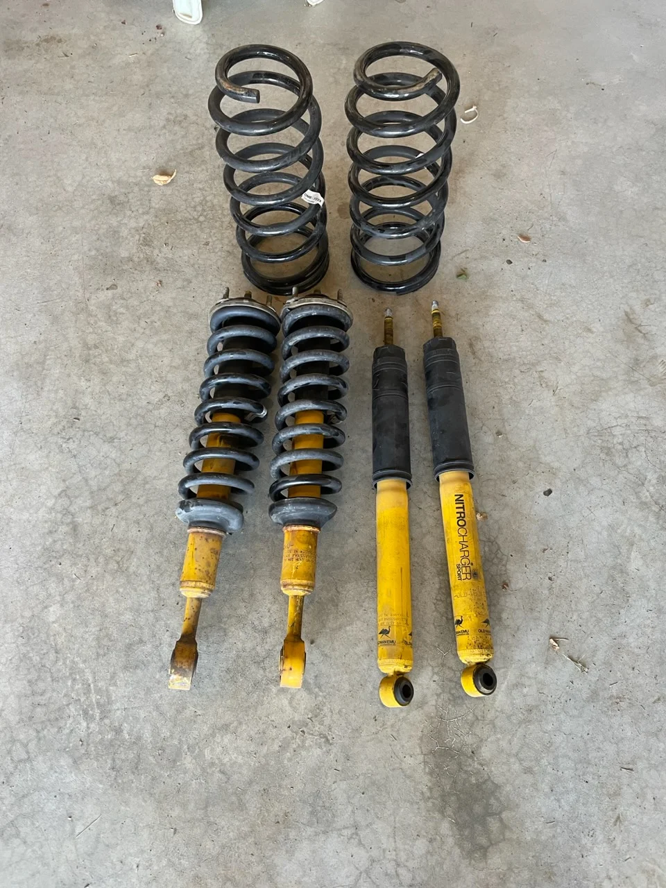

I have taken off the OME suspension that was on my new to me 200 swapped my BP-51 on it. I’m going to sell the rake off parts but I don’t know exactly what rear springs these are:
722X? My guess is 7220 or 7222.
I would guess they are the 7220. How much lift did they provide? How many miles on them?

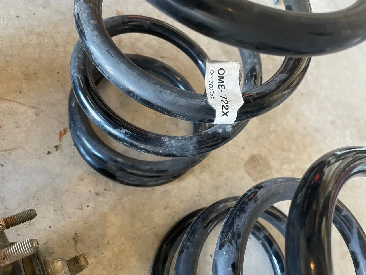

View attachment 3484938View attachment 3484939

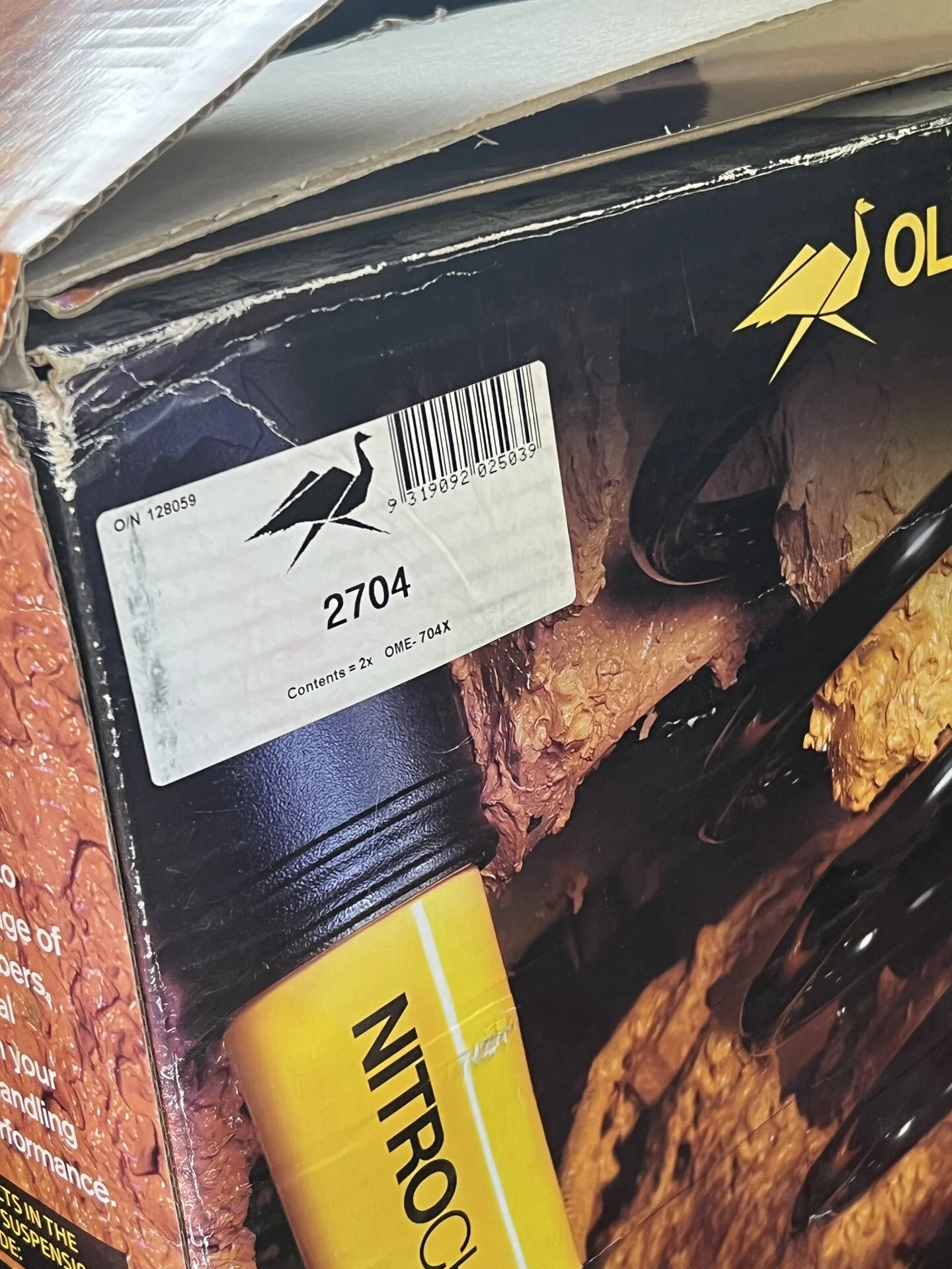

here is a copy of the box for my 2704 springs.
the 'x' appears to be a suffix as in '704x'.
my guess is those are 2722 springs (722x).
Found invoice in stack of maintenance record PO gave me. They are 2722s installed Feb of 23. They look pretty new. The rear shocks were also put on at the same time but they don’t look that new.
