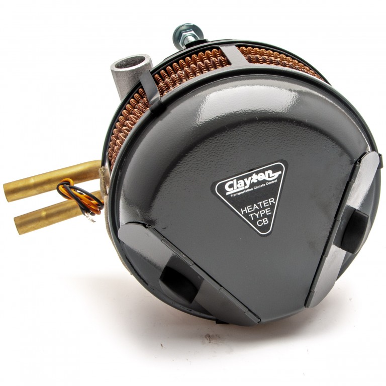

how to Connect Clamshell heater ?

Here is how it was mounted . .i knlw it is aftermarket in 64...so not sure...maybe i xoll install a soft tube between entry and heater like on the previous picture ...but mine have gasket around the heater air entry and was directly connectef i presume ...
Somes pictures....
I really need info or other pictures of a clamshell mount....
In tried to see if is possible to install in yhe middle ....buy don’t know if ok with the 3 speed gearbox or 4 speed (i have for speed at this moment and eveb don’t know if cover is the same between 3 and 4 speed....
The clamshells I have found had some home baked looking mounts. Let me see if I have any on hand for a picture. They were super basic looking and mounted off the two large studs on the back of the unit.
I have two big M10 at the back .
For information...bosch also shared this technology with
Take à look with Google on smiths circular heater
