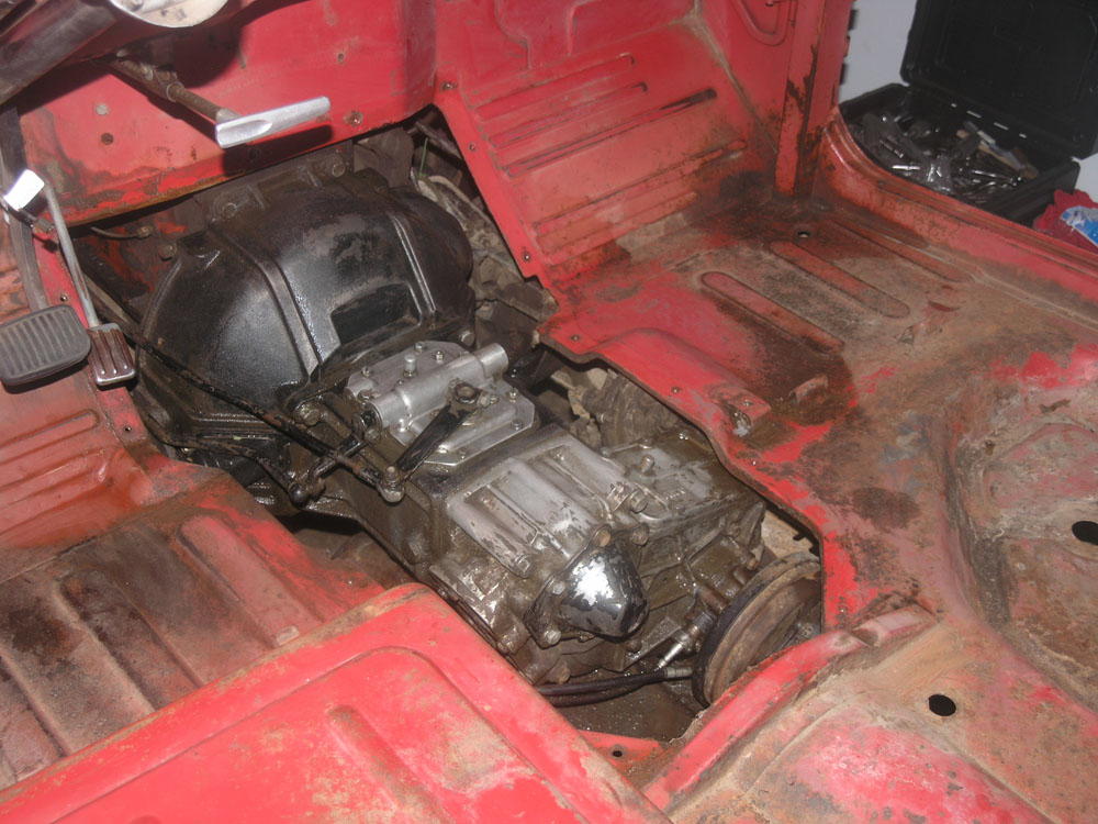

  5. destin
    destin
    Messages:
    3,600
    Likes Received:
    8
    Joined:
    Apr 22, 2009
    Location:
    portland or
    use a spackle knife, nix the big s***.
    hose with marine clean, scrub with a wire brush repeat :D
    before-ish
    [​IMG]
    afterish
    [​IMG]
    now :D
    [​IMG]
