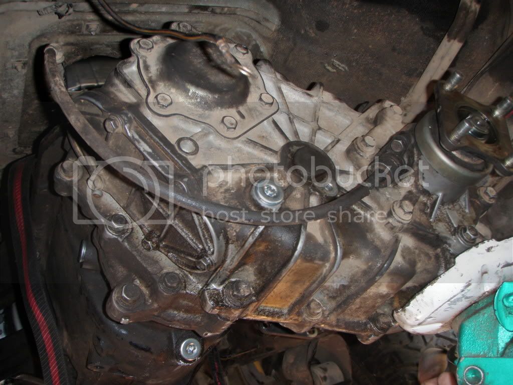

8. Unscrew the speedometer cable and tuck it out of the way. Also unscrew the bolt to the ground wire in the rear of the transmission. (in this photo, speedometer cable is still attached but the ground is unbolted).

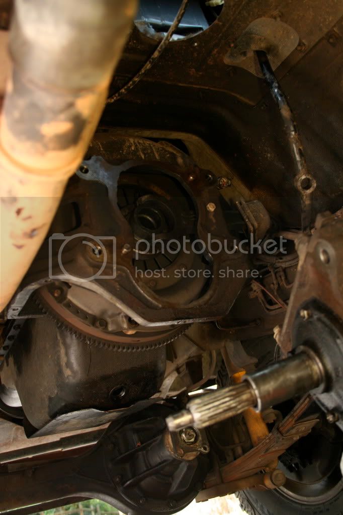

20. Keep moving backwards until the transmission is far enough back you can get into the clutch (2 feet or so).
21. Unbolt the 2 bolts holding the clutch slave cylinder
22. Pop the metal clips on the release fork that hold in the throw out bearing.
23. unbolt the bottom 2 bolts on the flywheel housing. Rotate the housing (kinda tough) and keep unbolting all the bolts until the housing and clutch disk are free. They will slide out the bottom of the bell housing.

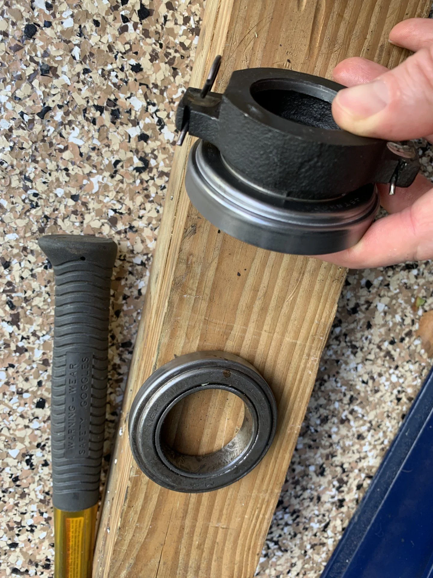

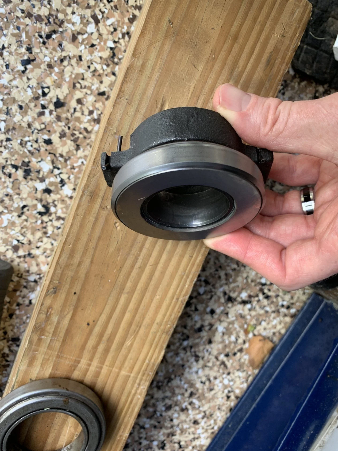

thread bump - question on throwout bearing orientation
Im having a difficult time finding a definitive "right answer"
33. Use a rubber mallet and a large socket to knock out the old hub from the throw out bearing. Gently tap the hub onto the new throughout bearing. Make sure the rounded side is the side that goes towards the clutch and pressure plate.
how I have this on with the flat side towards the three clutch arms makes sense to me . Would not want those arms touching a surface that has two separate independent parts, as I’ve seen on a number of posts. Thx again!
These are opposite answers to a question I'm having.
Which way does Toyota say it should go? one member says rounded side to the clutch, one member says flat side to the clutch....
hOOter
I believe he is talking about the portion in the center of this shot.
If you put in in the other way the springs rub on the flywheel bolts and it will not operate properly

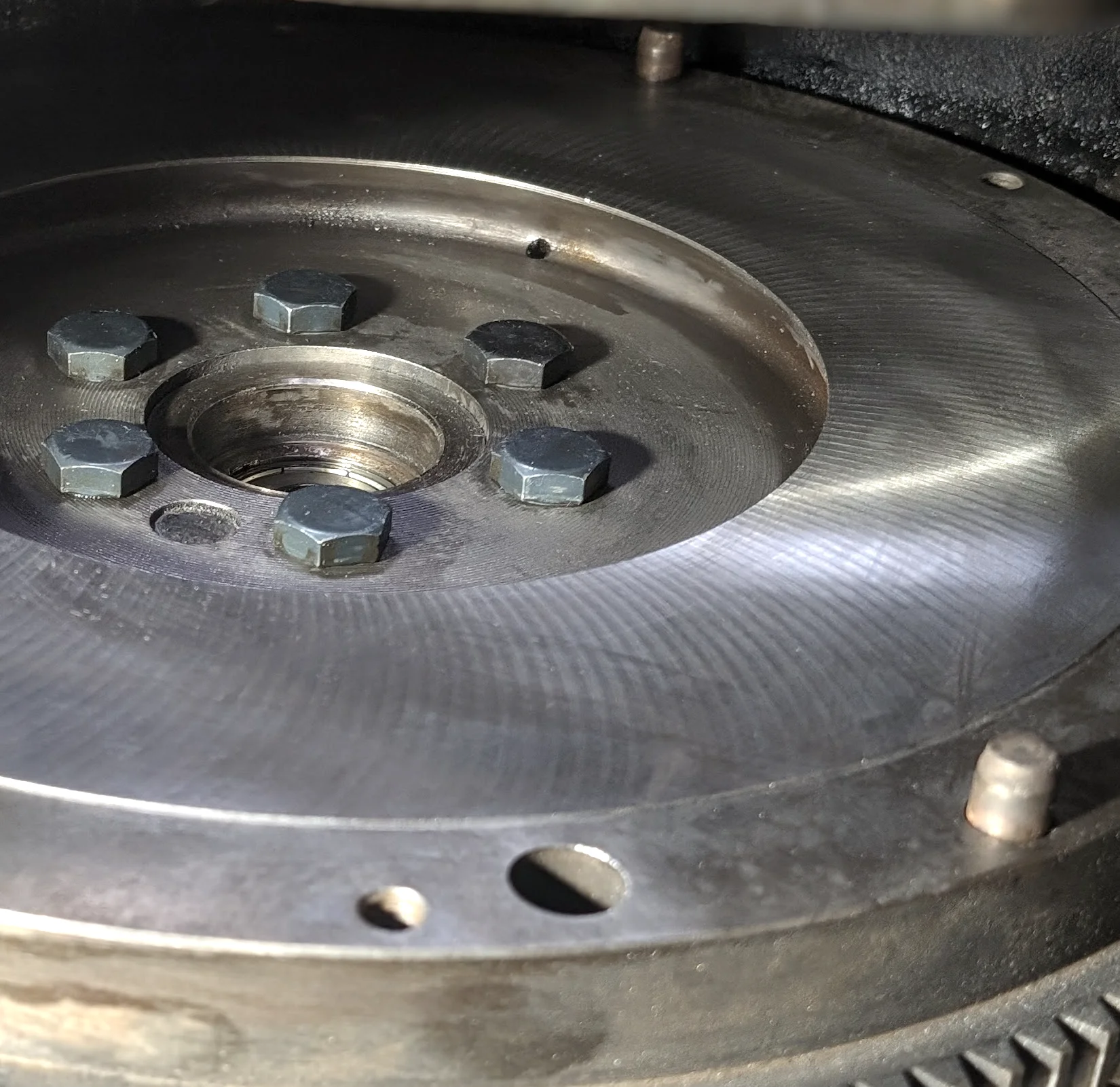

My '78 H42 has dowel pins that the pressure plate slides onto - there are 3 of them. You can see them here on the flywheel.
