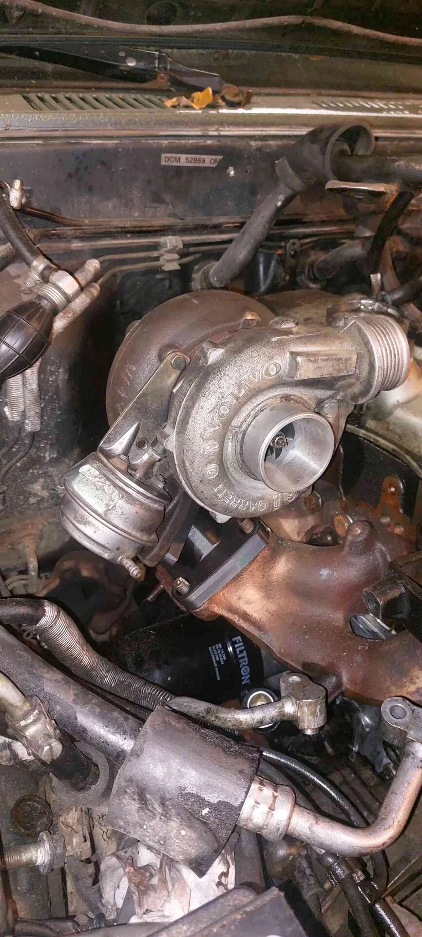

This is the adapter prototype out plastic, it's a 2ltii and the turbo is a gt2052

I’m not sure you will be able to tell any difference. Swapping to a different turbo changes response and everything as well so you really have zero baseline to go off of.

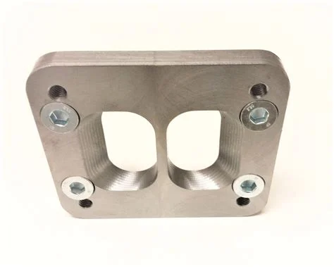

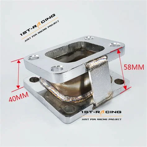

A couple of suggestions.
- Use shorter studs, and shorten your adapter. You only need enough room to get nuts and wrench inbetween top and bottom studs.
- use different hardware.
- Swap studs for bolts.
- reverse the orientation of studs. Thread studs into adapter, and secure adapter to manifold with nuts. Secure turbo to adapter with nuts.
- Or a combination of the above.

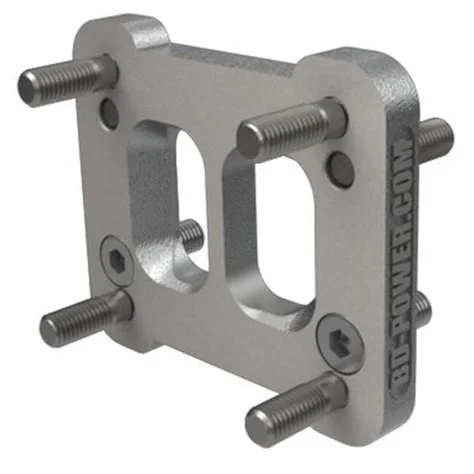

A few random pictures of different arrangements. Some might not be possible depending on clearance to castings, clearance to swing wrenches etc

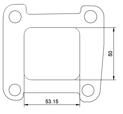

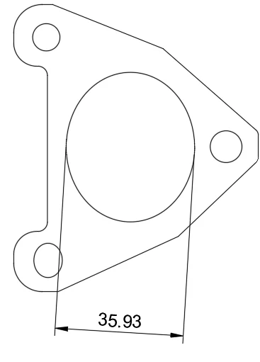

Im thinking of getting the flanges cut on a cnc, they will be atleast 10mm, maybe more. And the cone thing im either going to beat out of a pipe or cut out of flat plate and beat that in to submission. How thick should the walls be though?

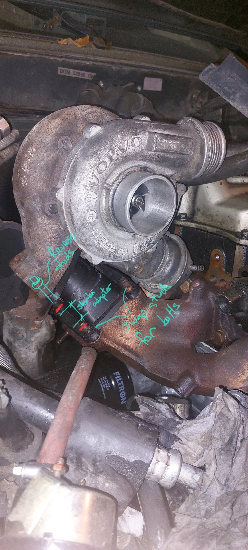

The current lenght was dictated by the wastegate actuator, which wont be there because i need to rotate the core for the oil drain, so i can probably go shorter by 2 or 3cm. The main issue with the adapters you posted is that i have to go from a square-ish hole to an oval.
I don't think the length would make a noticeable difference. Look how long the flow path from head to turbo is on equal length runners manifolds.
For the flanges, I'd use 12mm both for resistance to warping but also to allow for more taper in the hole.
In other words your manifold flange I would make with a round hole, then mark out the square on the manifold side, and start die grinding in the transition. You wouldn't have to keep a fully round hole on the turbo side of this flange, but by not making it the full square you'll have a much easier time for the bit inbetween the two flanges. For that bit I'd use some 40nb pipe, and slot the ends with a 1mm cutting disc. The turbo end you need to close up the diameter by only 4mm. Probably be a lot lazier to get that just by tapering the hole in the flange. The manifold end you need to open it up by 13mm which is quite a bit, but you could probably get half of that by tapering the flange hole without having a too steep transition.
