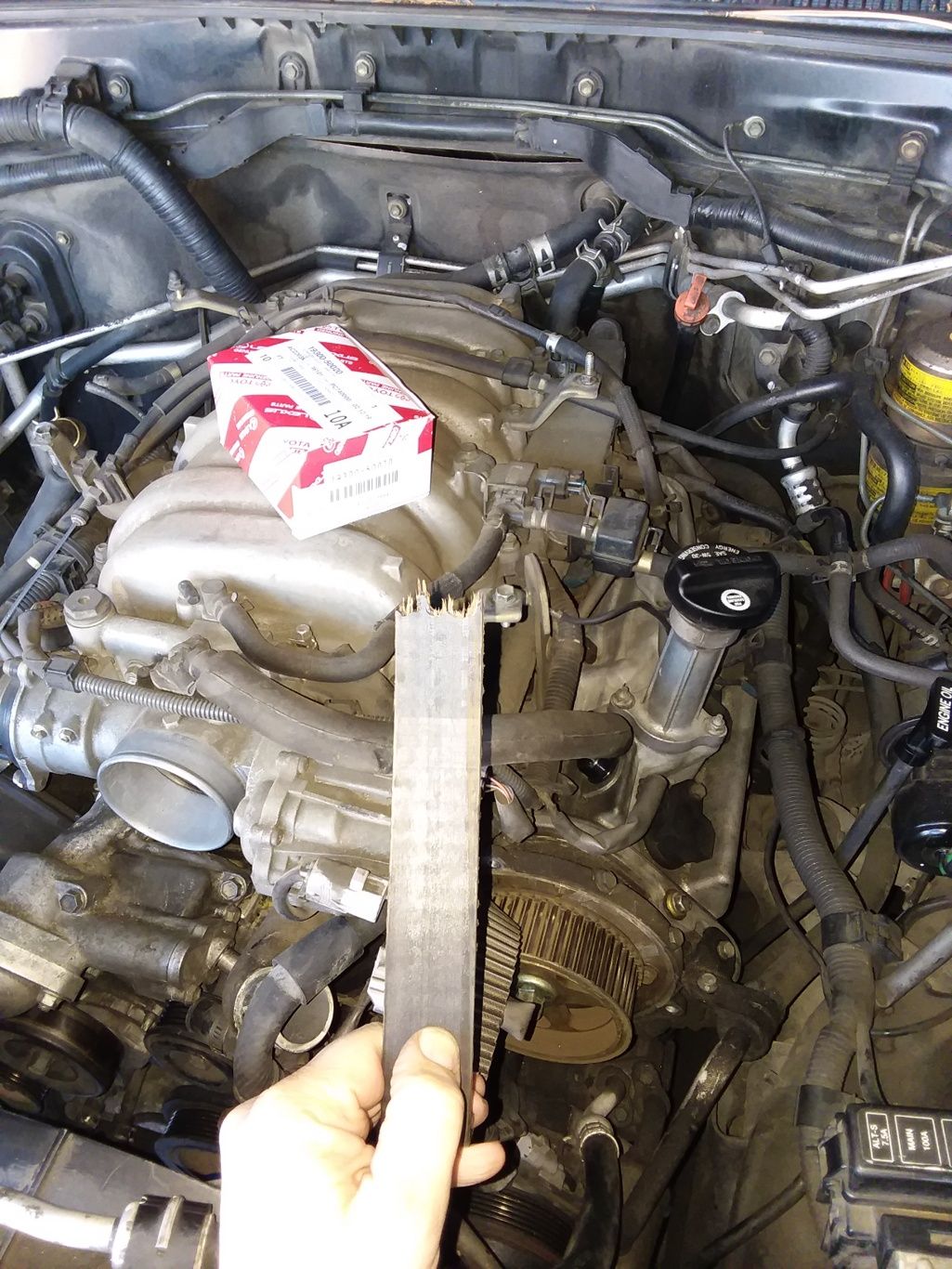

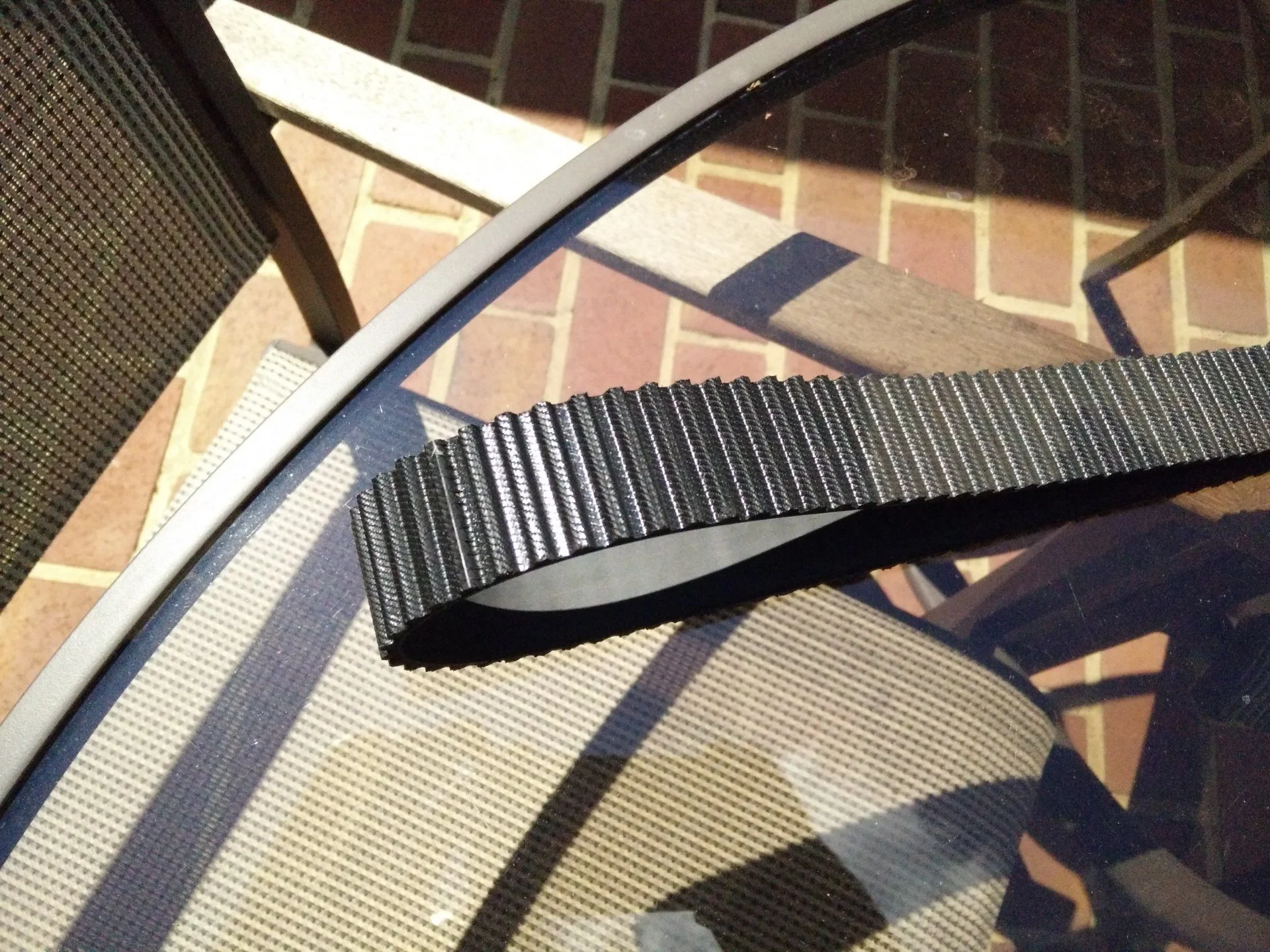

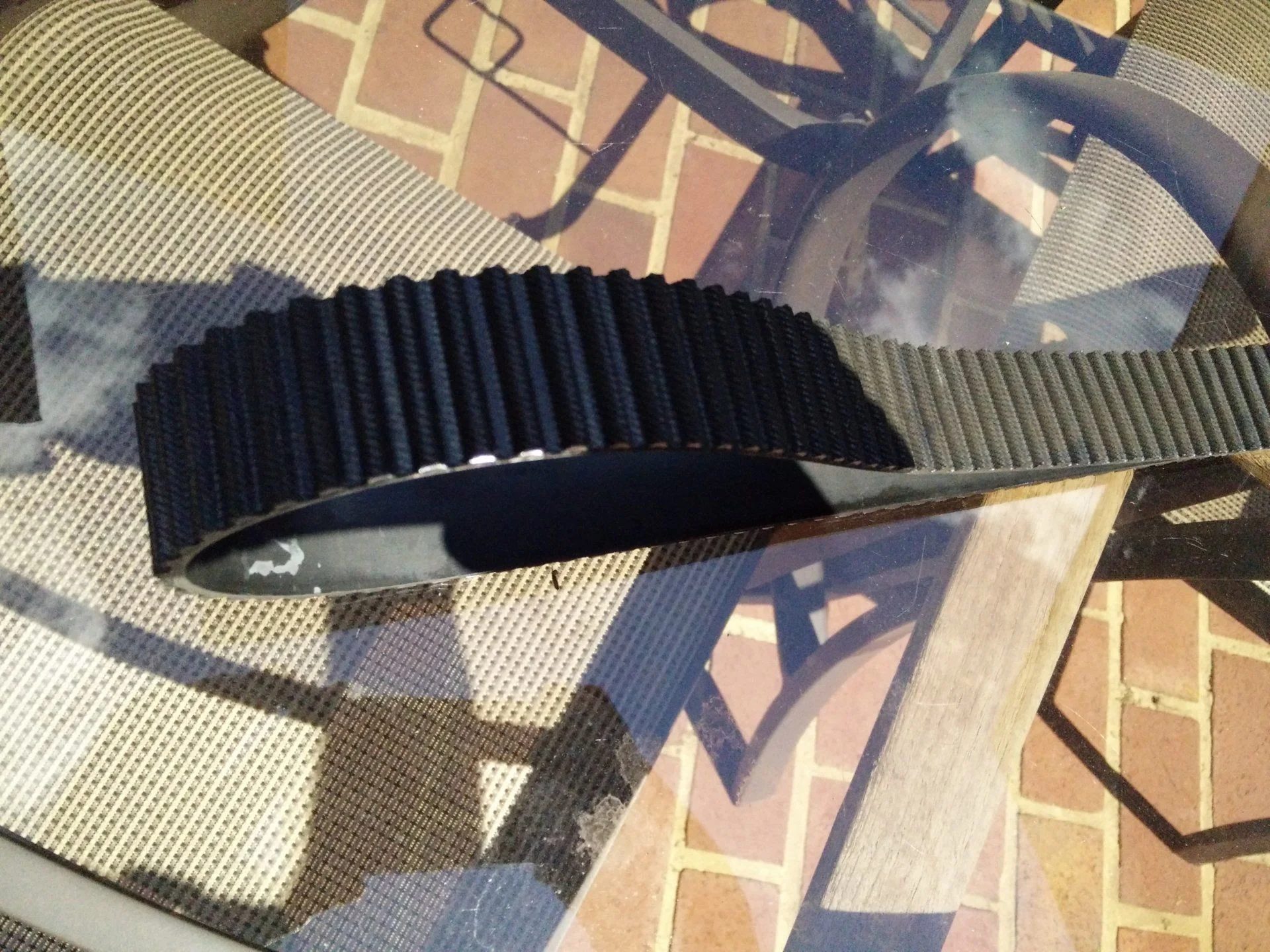

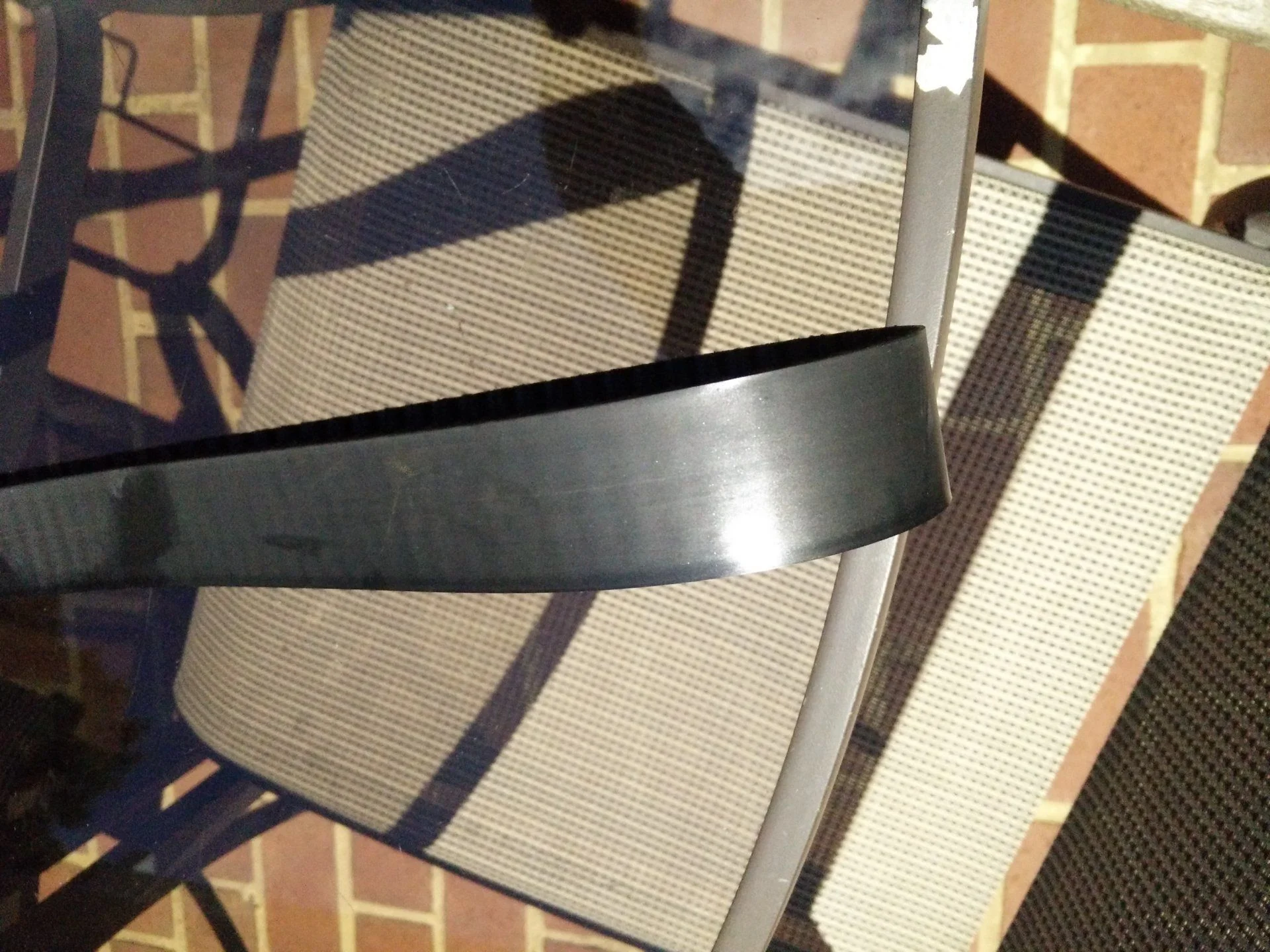

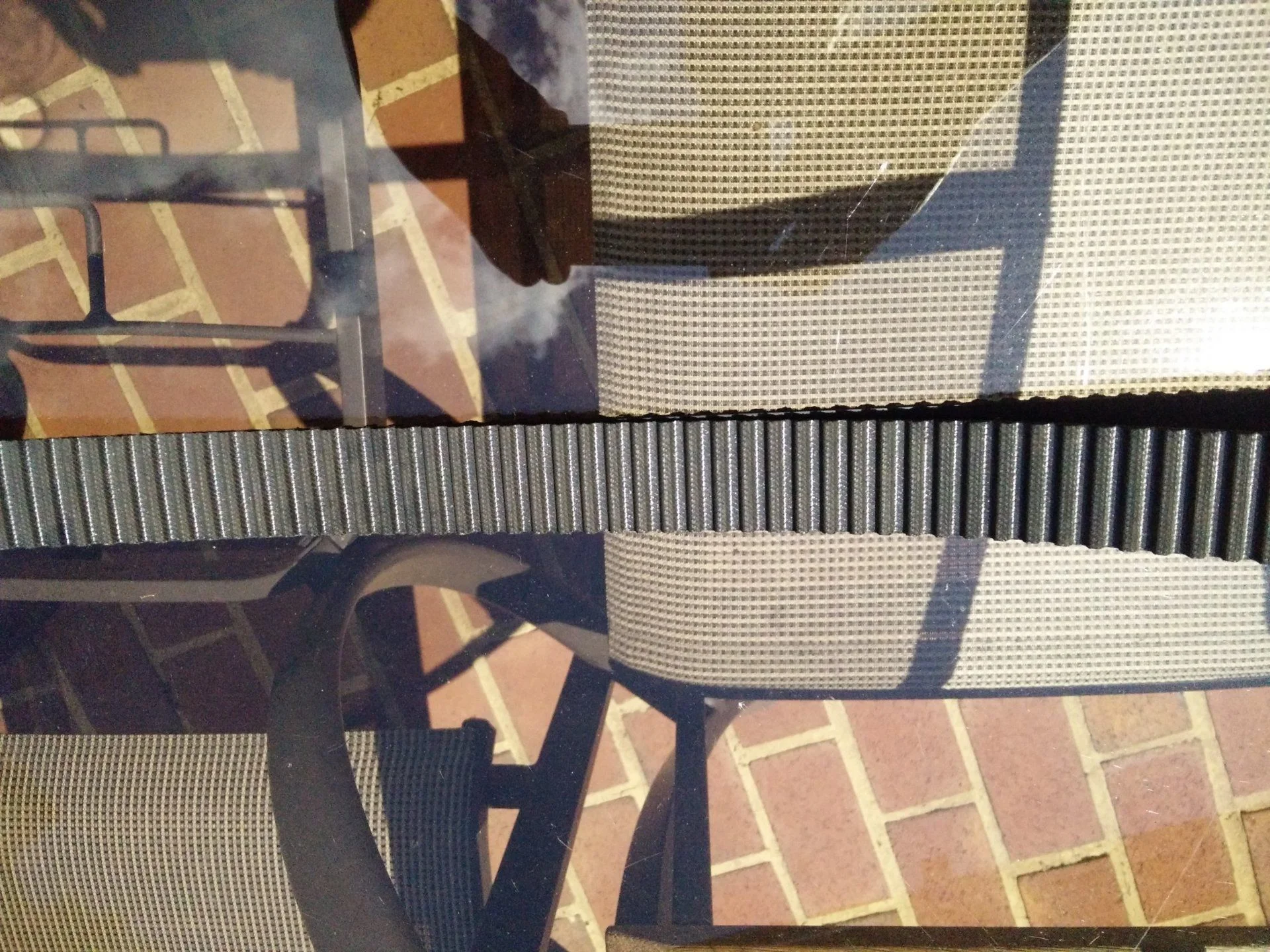

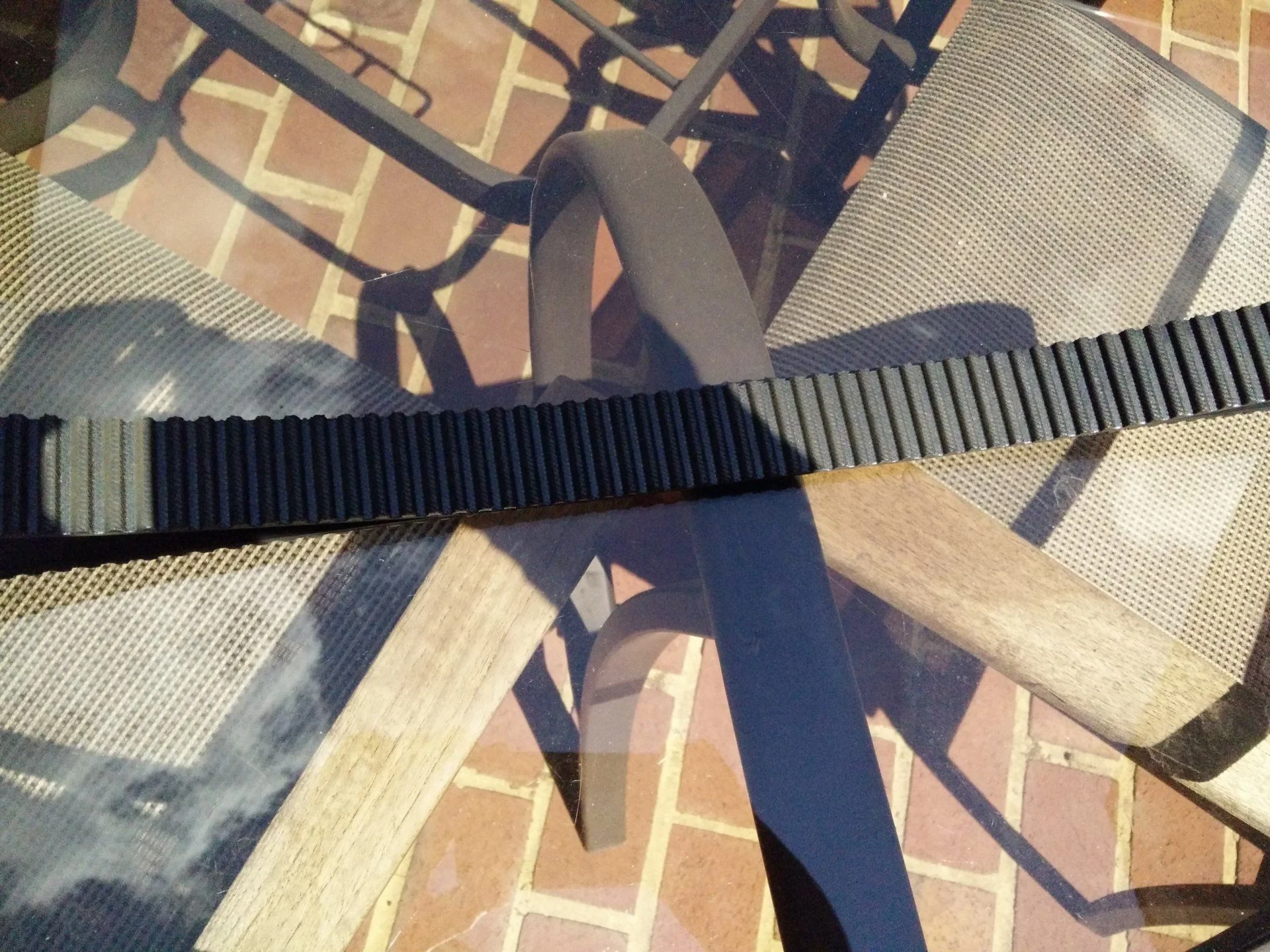

Here are photos of the Timing Belt I replaced on my 2004 LC.
Belt had 114,200 miles on it and and 6 .5 years age.
It looks almost brand new to me - no cracks or wear anywhere.
It did not break - just replaced out of fear.
Miles were primarily Southern USA miles - mostly Florida and N.C.
After noting the condition of this belt, I feel more confident in leaving my 2002 LX470 alone as it has 46K miles and 16 years old.
I'm thinking I will be focused on listening for squeaks and leaks than a factory schedule.
