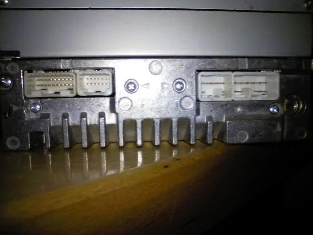

T1804 question
Searched and found this old thread had the most replys for Scion T1800' s.
Here's a pic of the back side of a T1804
Hoping one of you guys are using an IPOD.
I want to hook up an IPod to my 1804 using a cable. Here's 2 different ones, one is 20, one is 60.00
SCION SC12235 INTERFACE CABLE FOR iPOD iPHONE TOYOTA | eBay
or do I need this?
PIE TOY03-AUX/S Toyota/Scion +FREE S&H & More | eBay
help.
