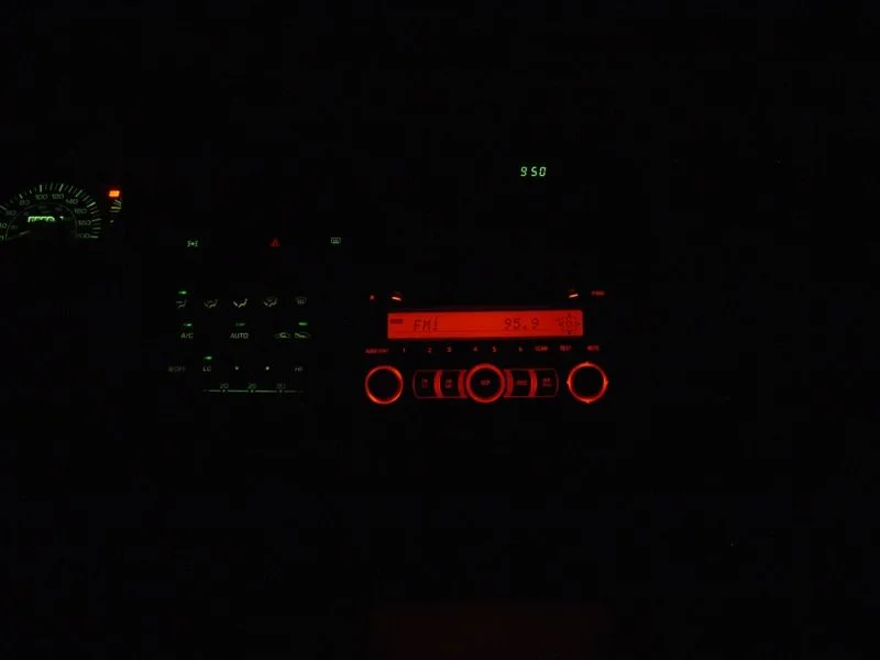

The scion is always lit because it uses LEDs for illumination (pin 10 on the S15). The dimmer does not work on the radio, but the light is subtle at night and dimming is not required in my opinion.

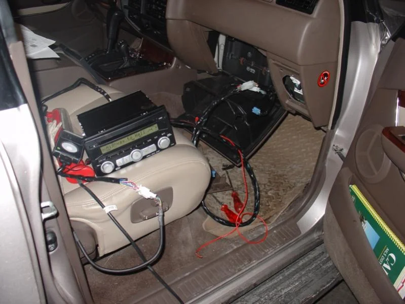

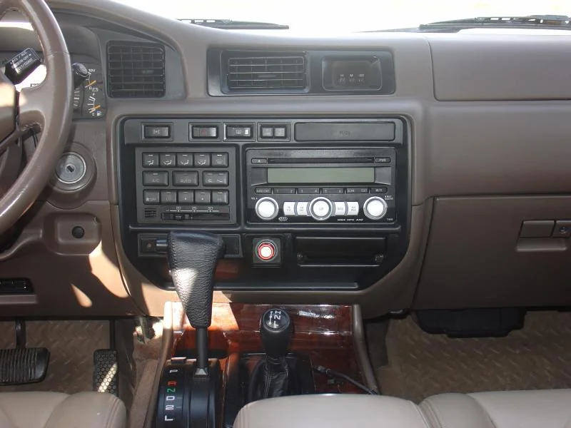

First pic is me testing the harness I built. The second is the final install. The little red thing in my lighter socket is a rechargeable LED flashlight from Spotlight:

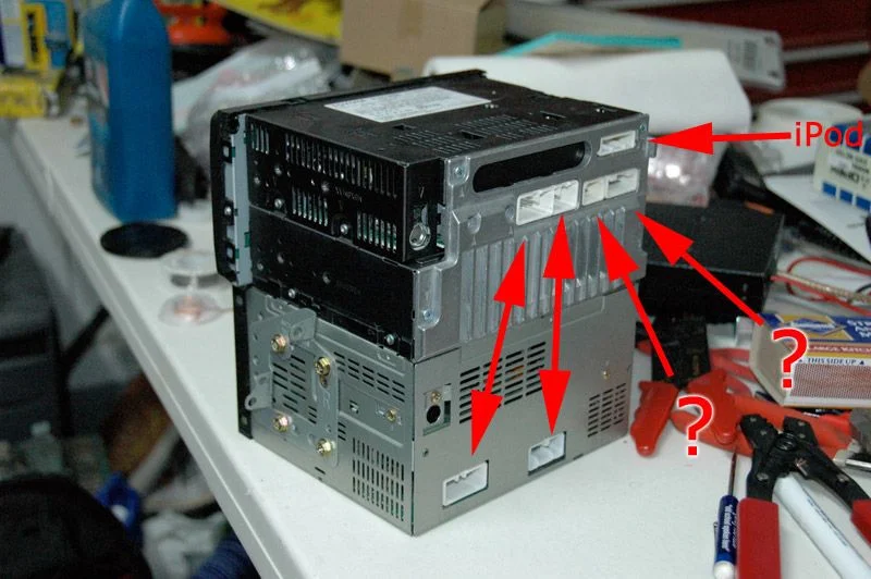

Ok I need to clear somethings up for my own sanity. I actually bought this set up from KNORRENA last Oct. The only thing I didn't get was the new cable he made. So now I am stuck with deciding between making my own cable or extending the wires. Personally I have no issue extending the wires and I really have no way of getting the connector from the junk yard anytime soon.
From everything I read, the LX amp is tossed out completely. So I removed it. Now what I am trying to wrap my head around is which connectors am I connecting to the SCION radio? There are three connectors that use to attach to the factory amp, and there are two connectors that use to attach to the factory radio. Do the old factory connectors not get used at all anymore?
Also I do not have an LX wiring diagram only an LC wiring diagram which is of course different so I have no way of confirming what connector to cut up and use. I did go out and buy the Toyota universal pigtail kit, but it obviously only has one side. You'd think this would make more sense to me but frankly stereo systems scare me :(

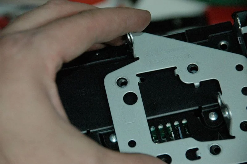

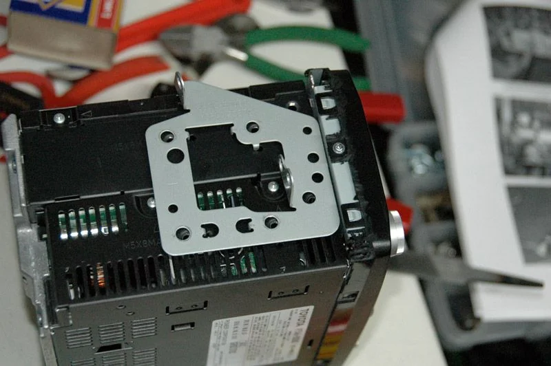

Also something else I dont remember reading was the brackets for the radio needing to be trimmed down. Maybe it was in one of the write ups but I don't remember it and just in case someone else is thinking about this setup, for the LX anyway, I've added pics.
EDIT: I didn't have any of the cool kid's metal working tools so I just sat for about 30mins using a hand file to work it down. It needs a skotch over 1/16" to be taken off.
I have it all wired up just not bolted in and its working fine. On my SCION, one of the two connectors you highlight are for a Satellite Radio, I would guess the other for a CD changer.
I have a setup I bought that plugs into the Satellite connector and just hooked up my Ipod and tested it using the Sat mode controlling the ipod and seeing text while I do it. I also hooked up an Aux port so my Dell could be used to play movies or even MP3's. I'll keep an eye on trimming the brackets.

I did not connect the two wires I asked about and the Radio is holding its memory from the other always on Power line. Don't really care if the illumination changes with the lights on. This one changes colors upon selection and is pretty cool.

From where to where, that is what I am having brain fade about and I haven't seen any CLEAR images to show.
I didn't have to trim the tabs as you said above and tested it before installing in the radio. To see take the amp out and two connectors will plug into the back of the Scio, your basically extending those and cutting the Woofer wires to make it work. You can cut the woofer wires and plug it in at the amp to test and then maybe you can visualize it from there.

Interesting that you didn't have to trim the brackets. I guess it changes depending on the model SCION radio.
