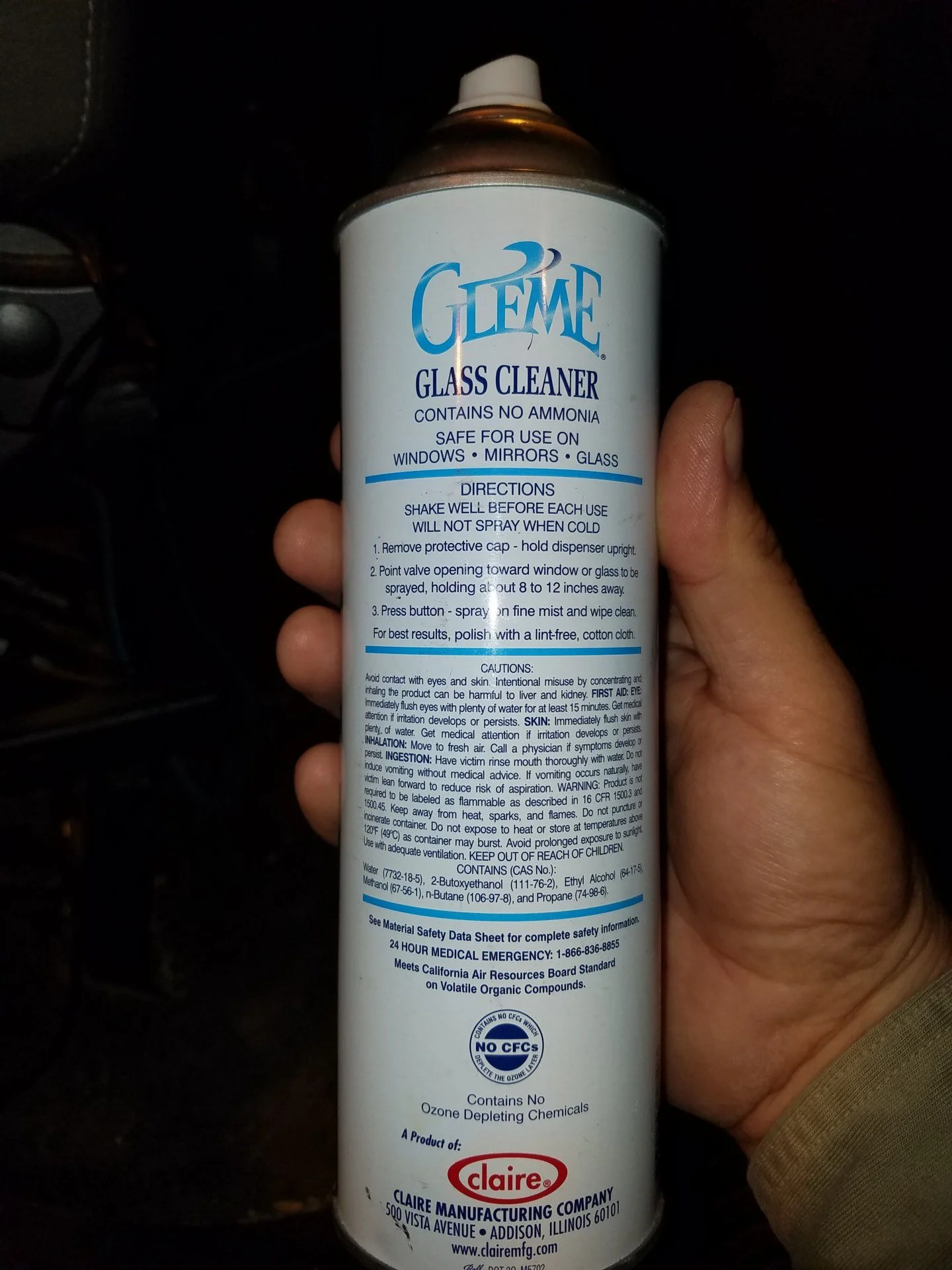

Then use this kind of glass cleaner... Windex is what the Winos under the bridge drink.
Read the label... towards the bottom you'll see the good stuff... they should have put skull and cross bones there.

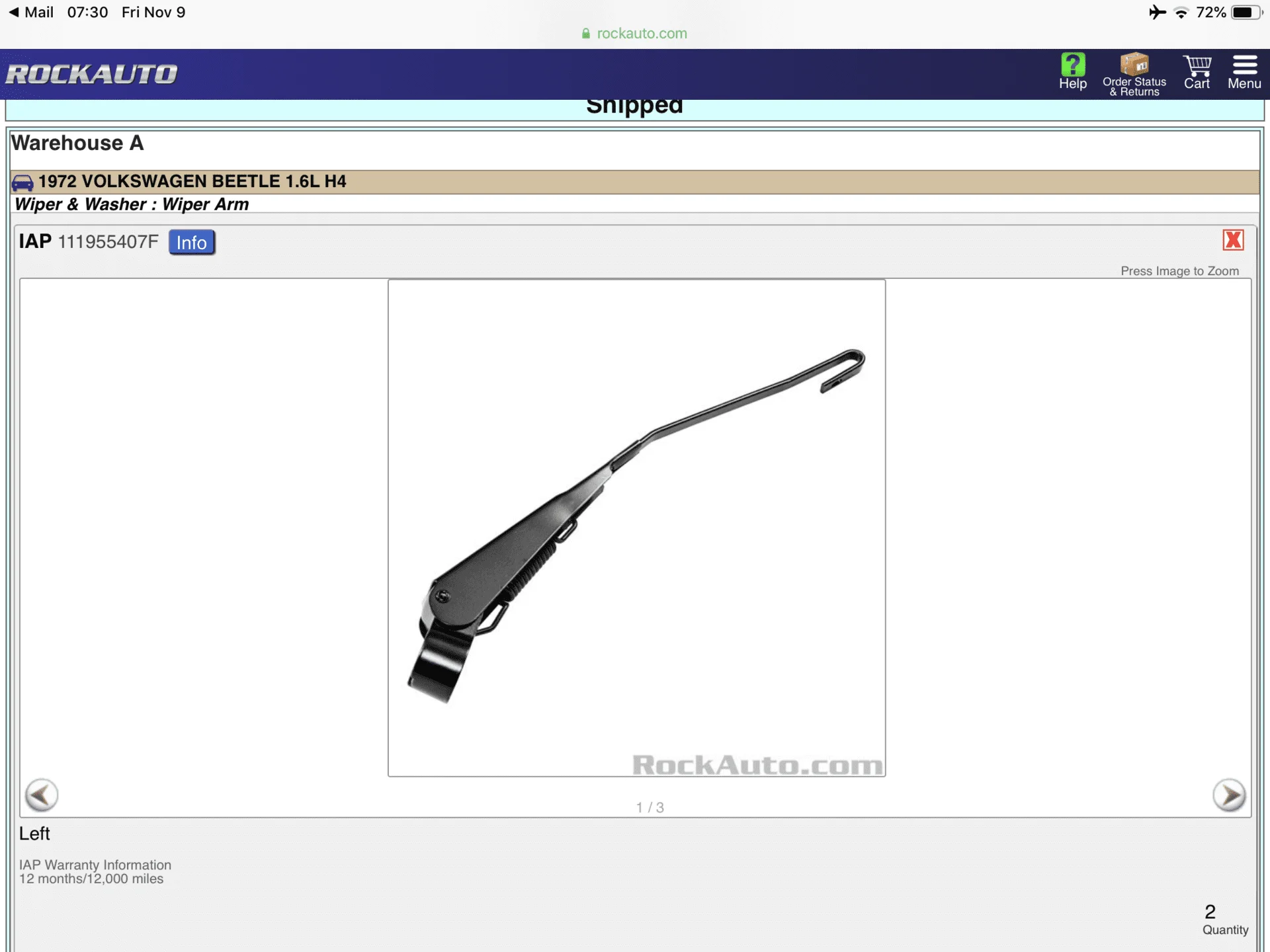

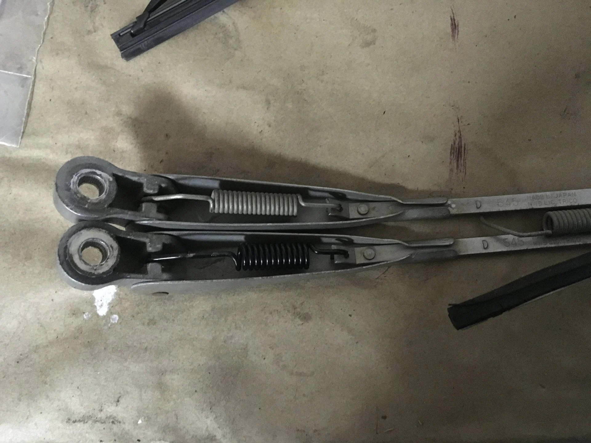

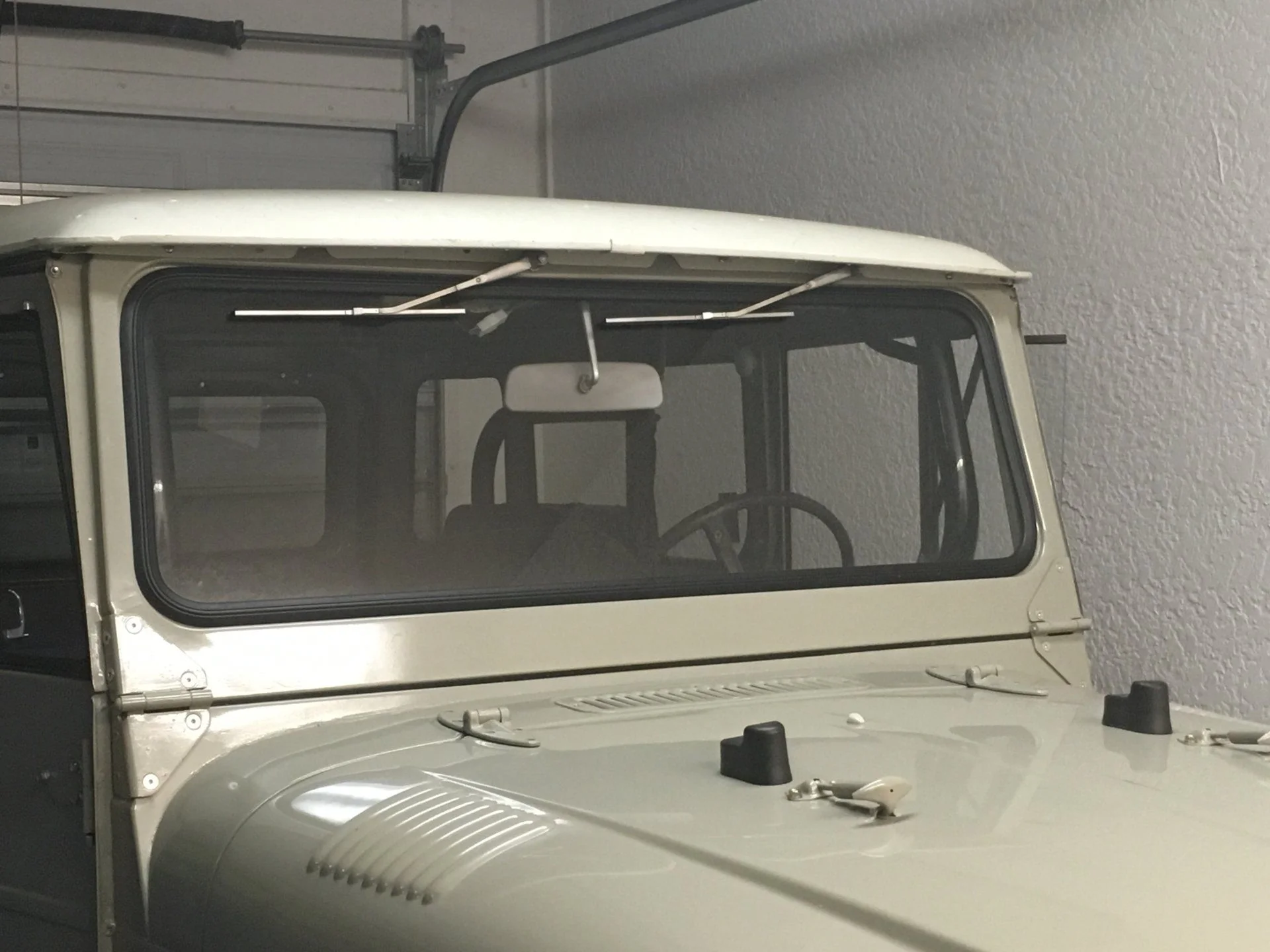

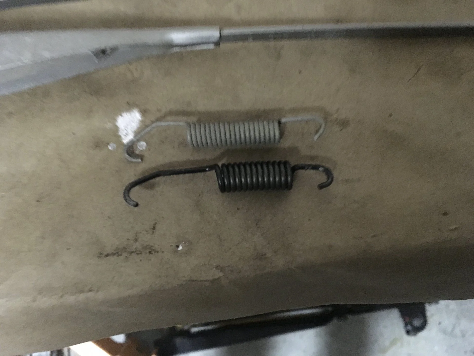

A thread on here pointed me to some VW wiper arms. I put those on, but the incorrect angle bugged me. So I pulled out my old OEM arms and ordered new blades. While I was fiddling around with them on the work bench, the arms had been bent by a PO trying to get more tension, I noted a striking similarity between the springs. Almost identical shape and length. Amazingly they swapped. I unbent the arms and installed them. Just don’t lose the tiny pin on the OEM arm holding the top of the spring. Tension seems great. Sort of a “not cost effective” way to get springs since I bought entire arms, but I think it worked for me. Maybe someone can run down a spring source for the VW arms to try. Again, garage tested only to this point, but they sweep glass cleaner great. YRMV.
VW arms from Rock Auto.
Black VW springs versus old OEM(?) spring photo below:
Installed on one wiper arm:
OEM versus VW arms below:
OEM on both below:

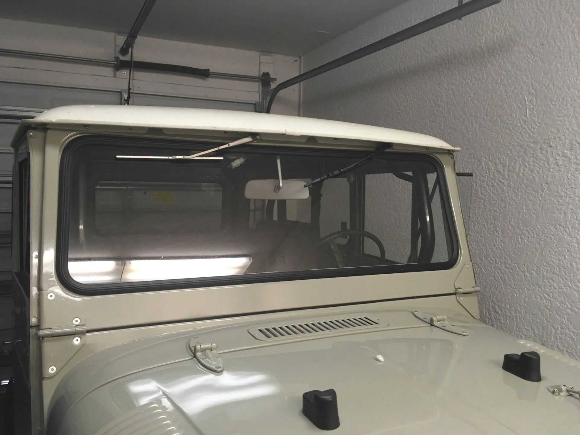

I just put a digital luggage scale on the arms. They pull off at 1.1 to 1.2 lbs, fwiw. My Corolla and 80 series seem to pull at 1.6 lbs measuring where the arm and blade meet. But since the FJ40 windscreen is flat, maybe not as much tension is required (or desired with the old motor). Again, not checked on the street yet.
Edit to add: my 80 series (still) original rear wiper pulls off at 0.9 - 1.0 lbs, so I’m 20% above that.
OEM on both below:
