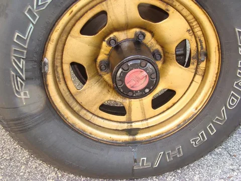

Just recently bought this 85 4Runner. Its a project.
Gear oil leaking out of center of front driver side wheel. What seal needs to be replaced? How involved is it?
I drove it around a good bit this morning. That pic was taken after it sat for only a few hours, so it must be pretty bad.

You need new inner axle seal.
It is very cheap, but you need to take it apart all the way to taking the axles out to be able to change.

First check the axle fluid level. It shouldnt be spewing even with bad seals if its not overfilled or full of water.
Leaking axle seals are the first sign of kids beating a stock toyota before selling it. It gets filled with water while mudding the local holes and then the level is high enough to leak out of the knuckles. Pull the fill plug and I bet it come spewing out cuz its overfull.
as far as axle seals are concerned, replace them with marlins upgraded axle seals. If ya dont use the marlin ones, then dont even bother repalcing the stockers. New stockers are as bad as worn out stockers. Marlin can sometimes be a PITA to get on the phone, so I just get the marlin seals from Bobby when getting new wipers.
