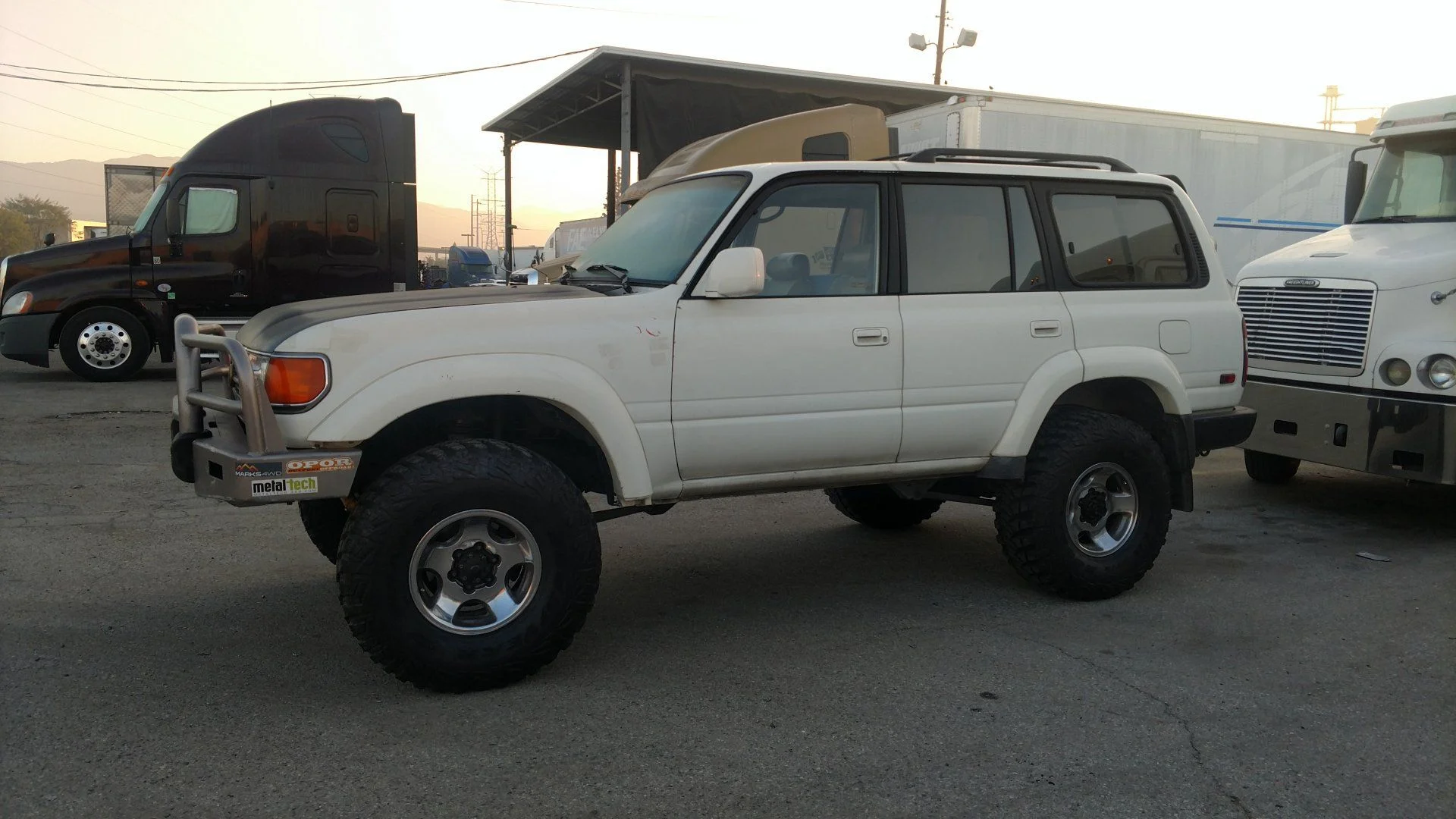

It was sitting in my brother's Driveway for a few years like this. So I decided I would get an 80!
2 days later...
A few months later...
Earlier this year...
I know that doesnt help your choice much.. the 80 series is bad on fuel and with bigger tires and no regearing it gets worse. Range on a full tank sucks. But if you have Jerry Cans it will get you by.
