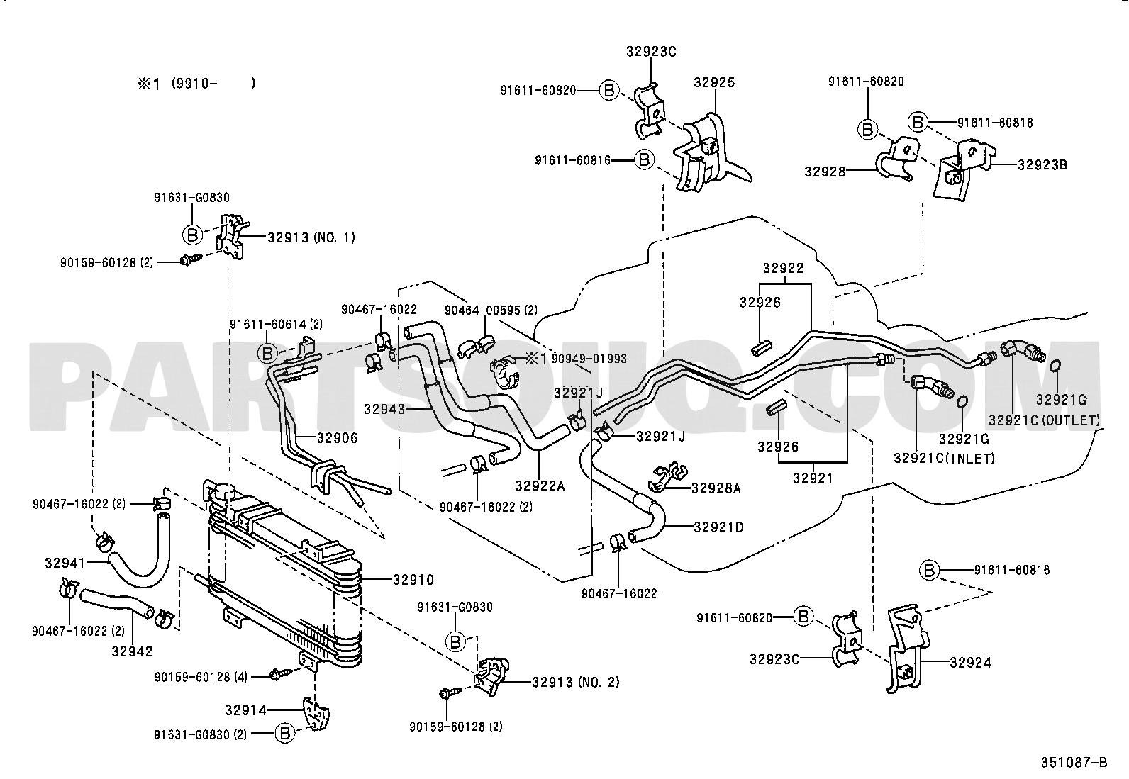

Hey there, I am looking to replace my lines with bulk hydraulic hoses, but trying to determine the sizes I need.
I see that a 3/8" hose fits the bottom of the radiator, but appears that the lines going to the cooler is 1/2".
Thanks!

Looking at prices, I am seeing $300 for 5 hoses...ugh. And the size of OEM is a weird 13/32 or .40". 3/8 hose is too small.
I don't see the job any harder using generic hose except sourcing and cutting (negligible compared to me replacing the steering rack right now lol).

I replaced all of mine with OEM and absolutely did not pay anything close to $300. Maybe $100 total, but probably not even that much.

Correction - I paid $173 for all trans cooler hoses and lines, and that included the 2 hard lines behind the grill. Without those 2 hard lines total cost was $122 for the 5 OEM Toyota hoses.
Do you have the part numbers you ordered handy. A bunch of the ones I just ordered to do during the engine swap came back as NLA.
3294160190 - qty 1 = $30
3294260290 - qty 1 = $38
3294360210 - qty 1 = $32
9044517103 - qty 1 = $8
9044517097 - qty 1 = $12
3290660150 - qty 1 = $52

Did you figure it out? I'm debating between bulk 3/8" and 7/16"
Bulk hoses are pretty rigid and may not give the desired flexibility on shorter connections.
They're all metric. 3/8" will work out to 9.5mm or so—too small for the 10mm hoses that go from transmission to the bottom of the radiator, for example.
I just replaced a 3/8 line at the bottom of my radiator (trail fix, cut a line on the trail and was just pumping ATF out)...it barely fit on in the first place, and had to be cut off with a razor for replacement.
IMO the hassle isn't worth it—$100 or whatever for lines that last another 20 years is relatively inexpensive. If you're dead set on finding bulk hose, look for metric hose.
reviving a dead thread. all of the soft hoses seem to be discontinued now. Can anyone help with the proper metric size for the soft lines coming off the bottom of the rad? i was able to get the hose clamps already.
I just ordered all those hoses, save one (32943-60210) from Impex, plus the upper and lower radiator hoses and all new clamps.
Only one (32941-60190) was NLA, and someone else on here (@Malleus) identified a workable replacement (32941-60280).
Here was my Impex order. First two are coolant hoses, next 4 are transmission cooler hoses, and remaining are the clamps.
