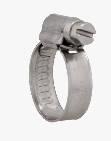

You could also look at ABA clamps. All stainless steel. Worm style, but the groove do not get cut all the way through the band so they are smooth on the inside. They come in different widths too so you can get some nice, small ones for things like the 5/8" heater hoses. I used these everywhere when I did my 2H swap into an FJ60, and did not have a single leak after. The key, in my mind, is to use new hoses (that's obvious), but do NOT cinch them down too tight. I just snugged them up, and that was it. If using the proper hose, the fit of the hoses is almost enough to make the seal, the clamp is gravy.
In the warmer months I'm pretty leak free, but the colder winter months I have leaks all over the place where I still have worm gear clamps, so I'll be going back to all OEM Toyota spring clamps.

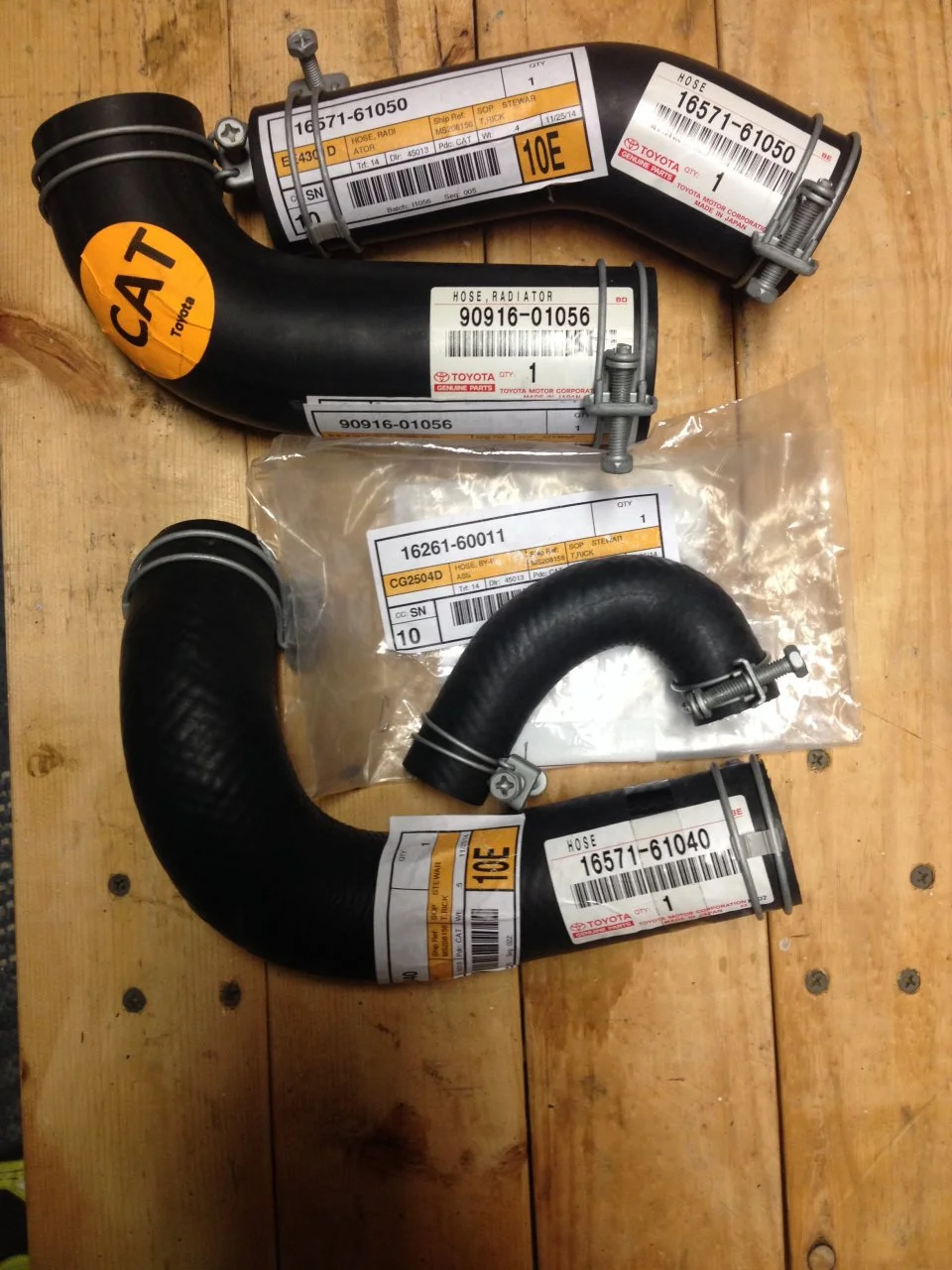

Kurt,
A few years ago I was replacing my radiator and all the hoses for my '77 FJ40. Here is a list of OEM clamps I put together, with Matts help:
wire hose clamps => constant tension band clamps
96112-10250 (ID=25) => 90467-21010 (lite gauge 90467-22004)
96112-10330 (ID=33) => 96134-52600
90460-49062 (ID=49) => 90466-41003 or 90466-A0026
96111-10500 (ID=50) => 90466-41003 or 90466-A0026
90460-58013 (ID=58) =>
Check out my post in this "THREAD" - See #16
Ultimately, the clamps I used were the AWAB stainless steel units found 'HERE'.
