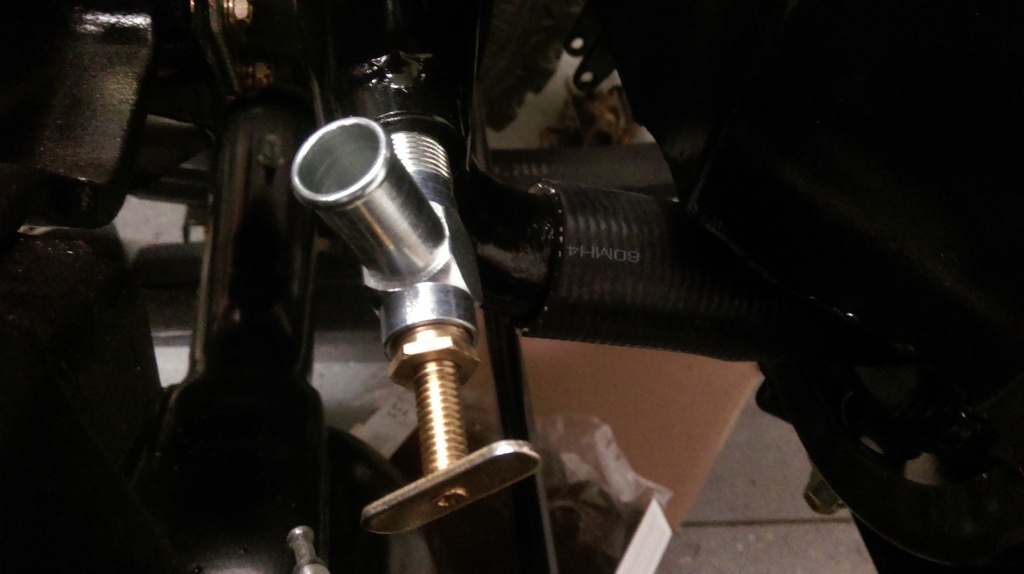

You will need:
Qty 6 of 96111-10500 Radiator Hose Clamps
Qty 2 of 96112-10330 Water Bypass Hose
Qty 10 of the Heater hose clamps.
One Gates hose # 21794 can be cut and used for the upper and lower radiator hose.
Napa sells a heater valve that is really close to the stock valve. It only comes in 3/8 thread so it will work on the block but is to small for the bypass. 660-1401
Nice paperweight!
Got the same hose Nolen. My bottom hoses are all wrong.
Did you get them from us?
I need to revisit our paper app guide for early hoses and compare to my 66 and make a run to the museum. I was 100% convinced the tall thermostat housing ended with the the F135 in 9/66.
Yeah I did not have a original pipe like that. Just a flex hose.
Also, they had installed a later water pump on mine so the original lowers I got from Kurt were technically wrong but by adding the updated connector pipe they were right.
