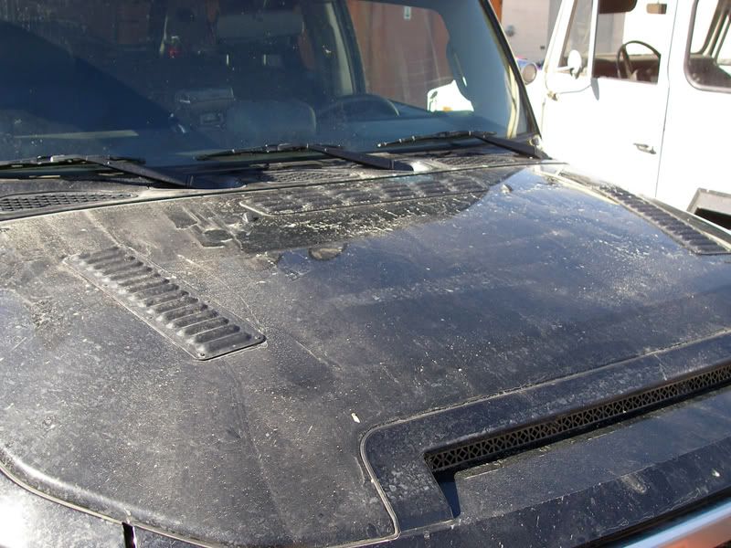

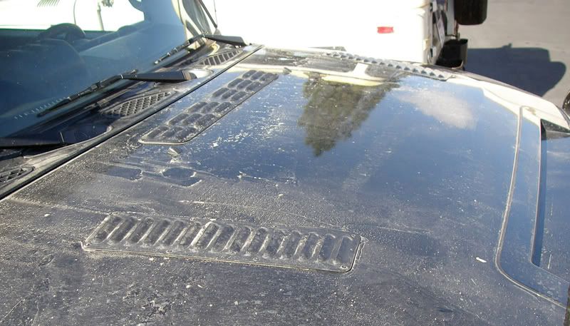

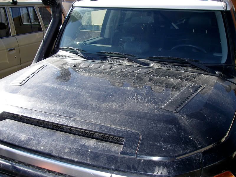

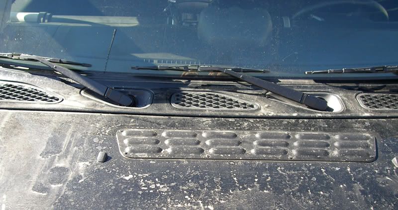

I now have my full set of three louvers on the truck. The rear, long louver now does the job of the air intake cut through (that'll make sense if you read my first post), so arguably, I don't need the cut through anymore.
My major issue with the cut through was that, being the air intake for the cabin, if the A/C was set to exterior air, it'd suck in engine bay air. Yuk. But I never use exterior air - I always have my system on recyc. I found a problem with this in that the A/C would tend to switch the recyc off all by itself. That was annoying until a saw a post someplace that said that if you hold down the recyc button for more than a couple of seconds, it locks the system into recyc. I'm now totally happy with the full set of air flow through mods that I have and will not be patching up the cut through.

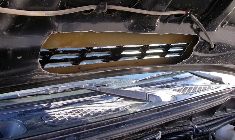

Hole in the hood near the windscreen for the thin louver:
Exterior shots:
