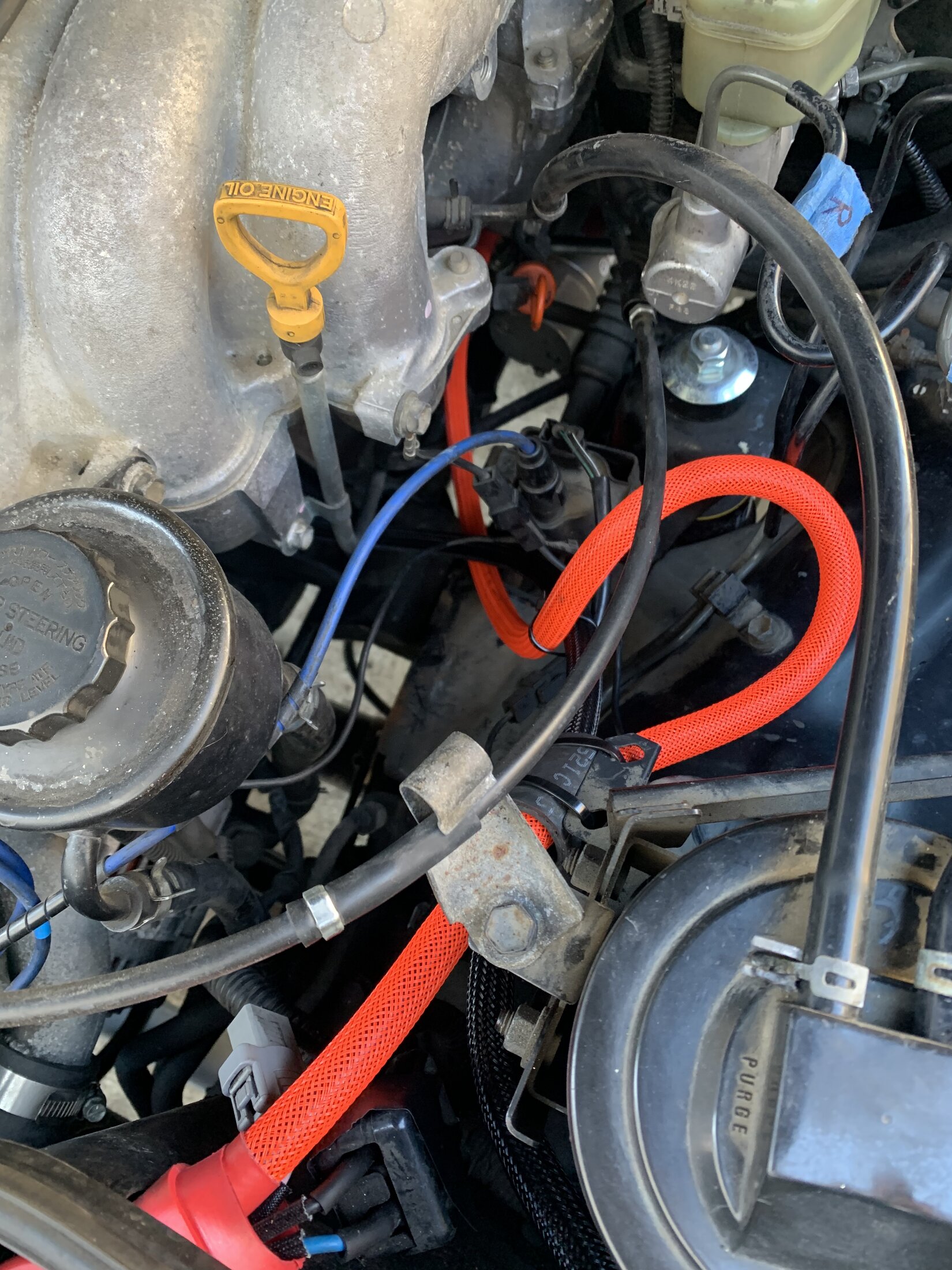

Some less exciting but necessary progress today. Ran the extended diff breathers up into the engine bay.

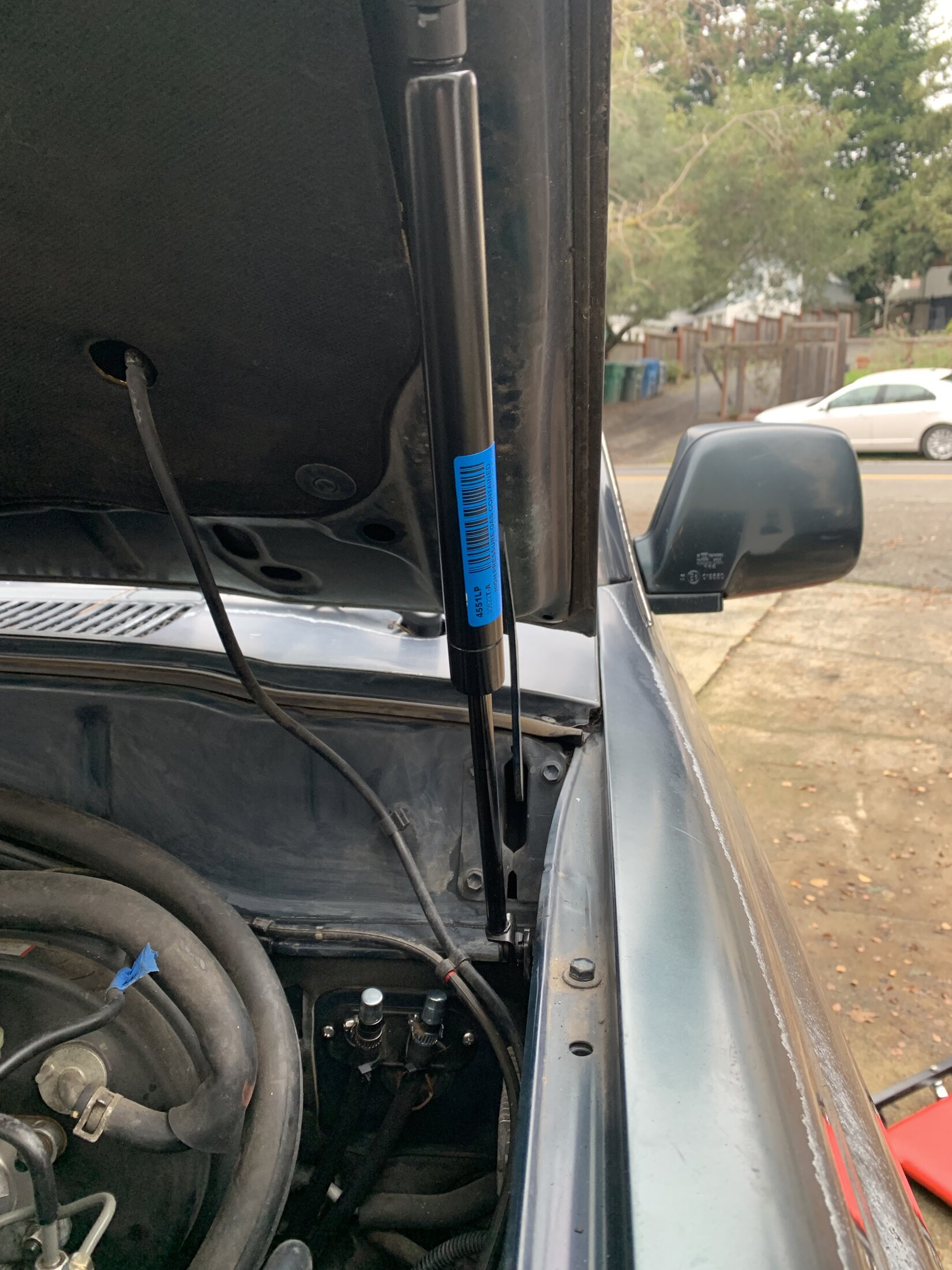

And scored a fresh pair of hood supports from Rock Auto. Strongarm 4551L and R.

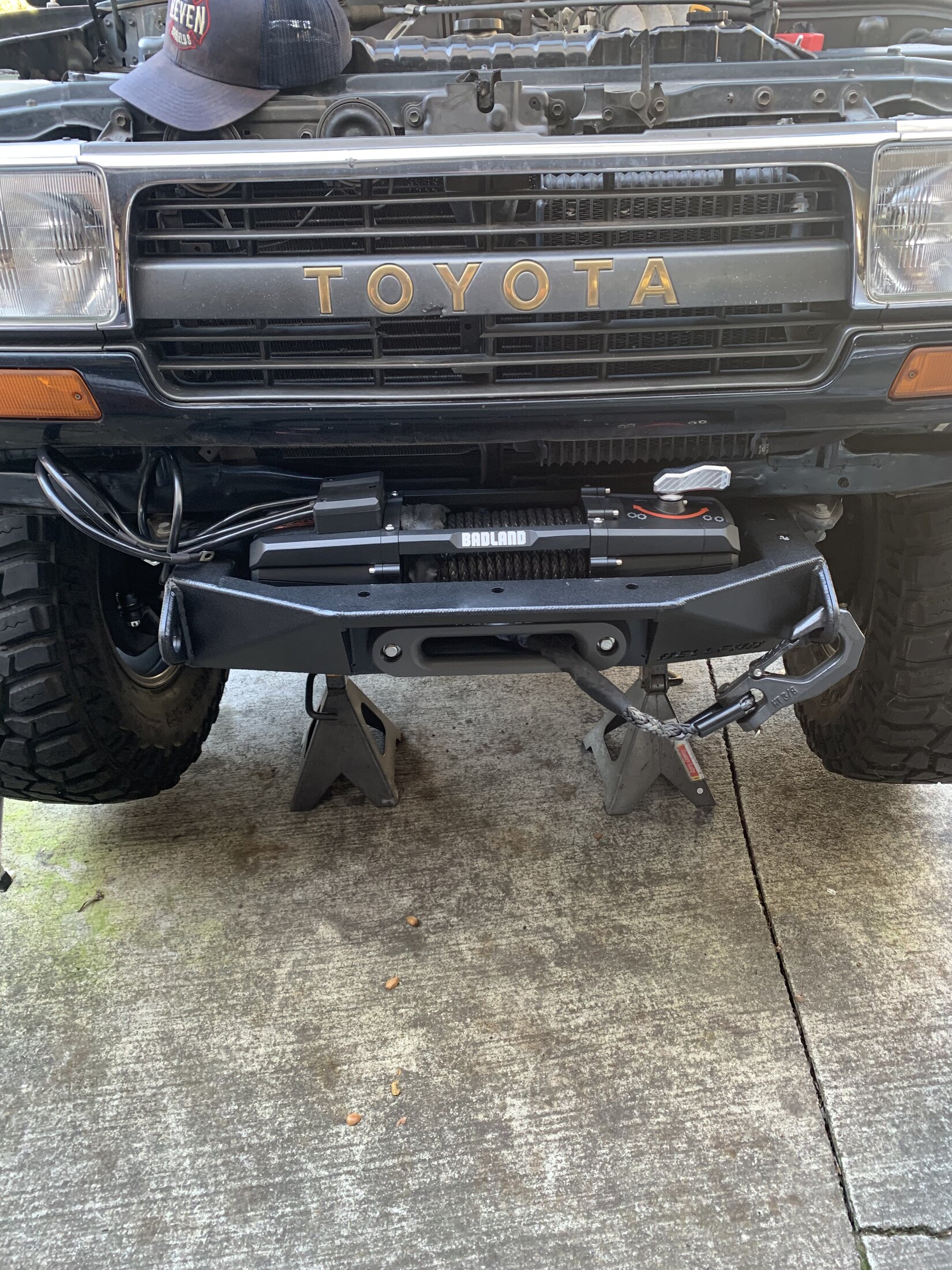

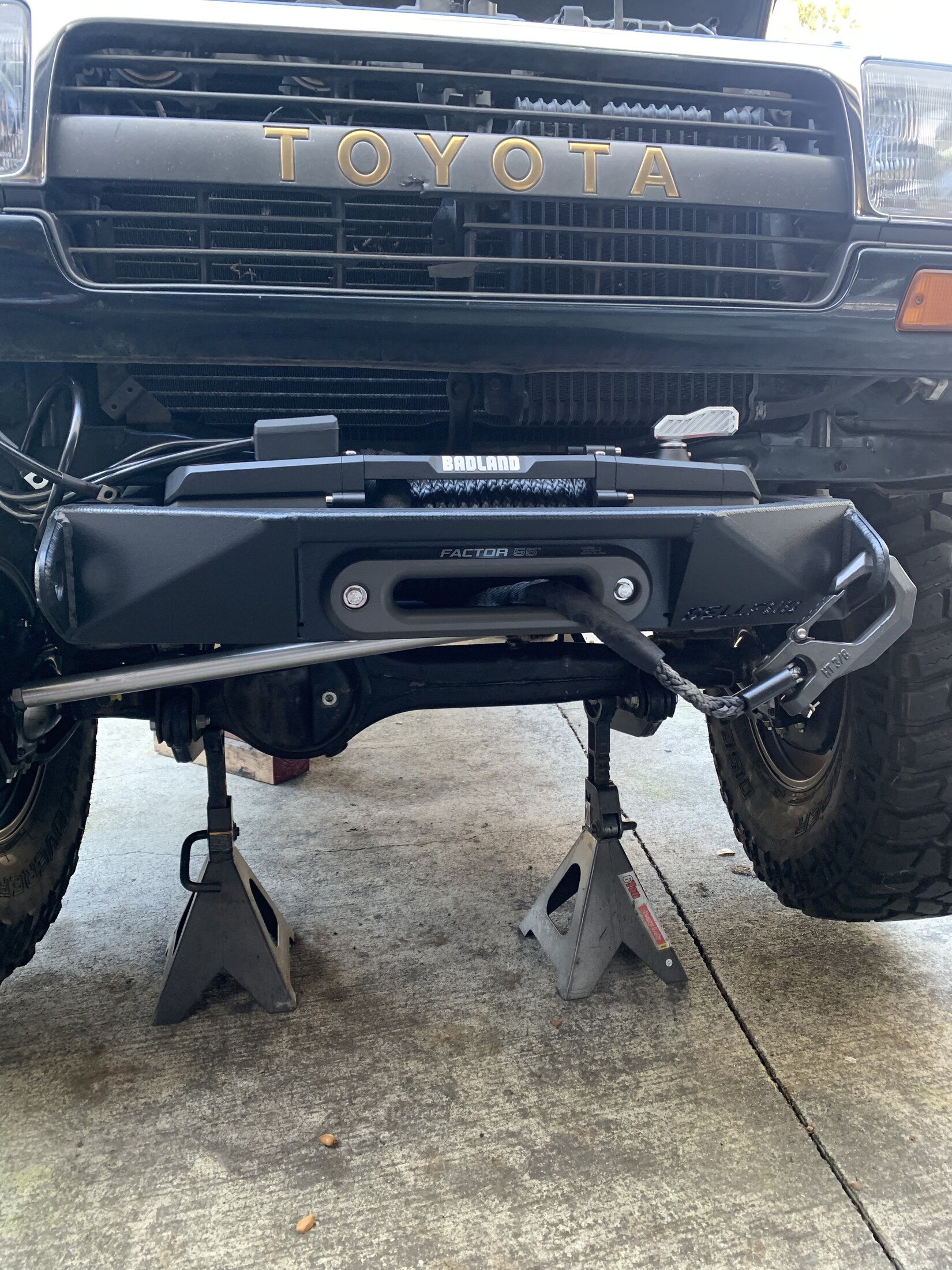

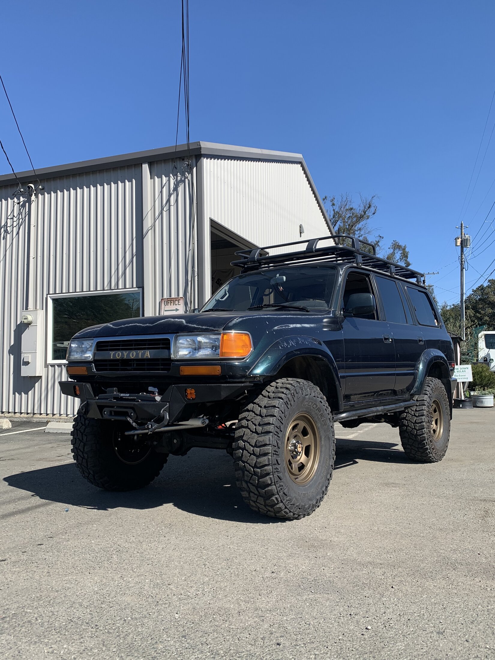

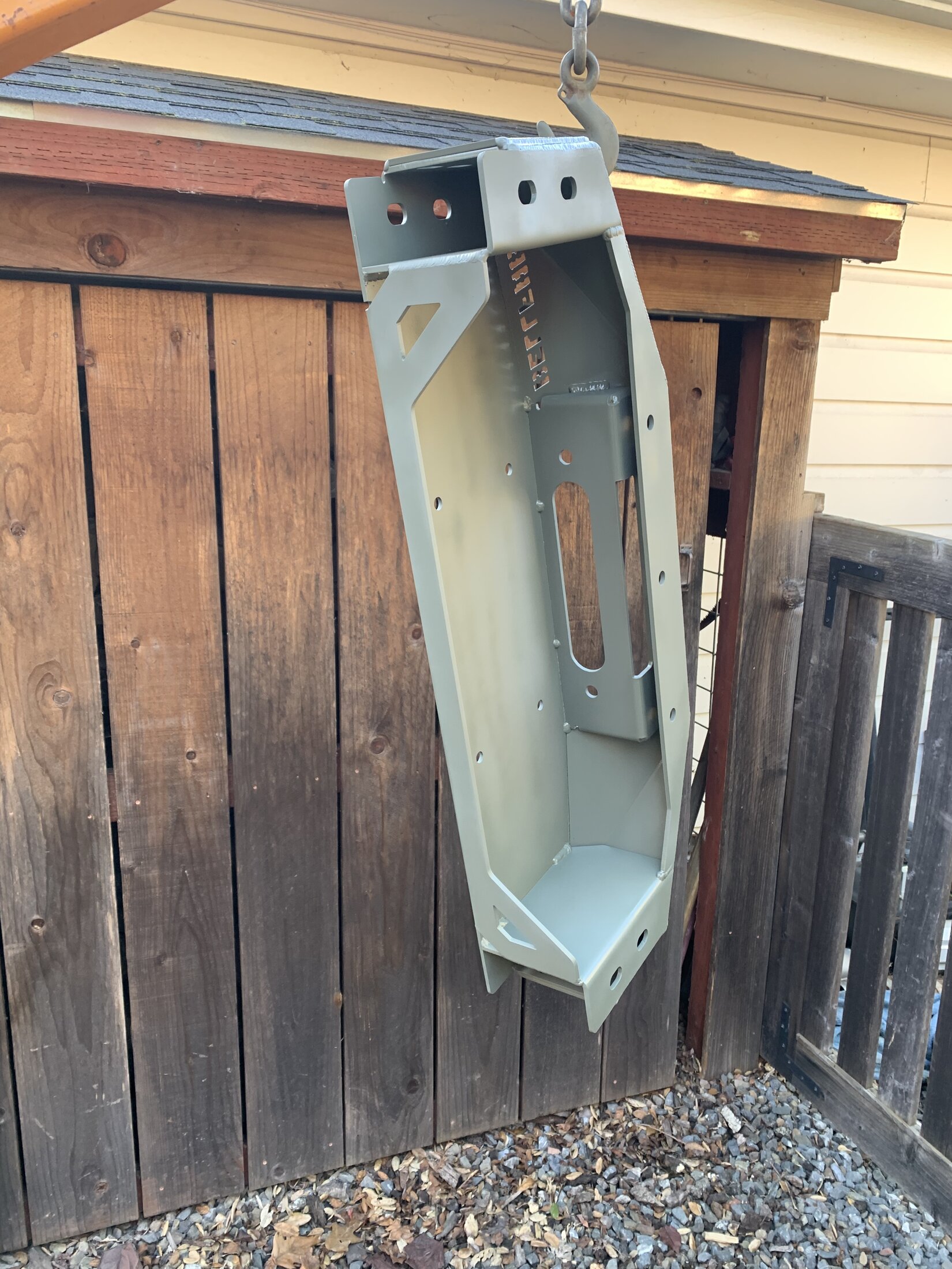

Got started on the @Bellfab bumper and winch install. Factor 55 Fairlead on there, tryna church up my badlands apex 12k. 😂

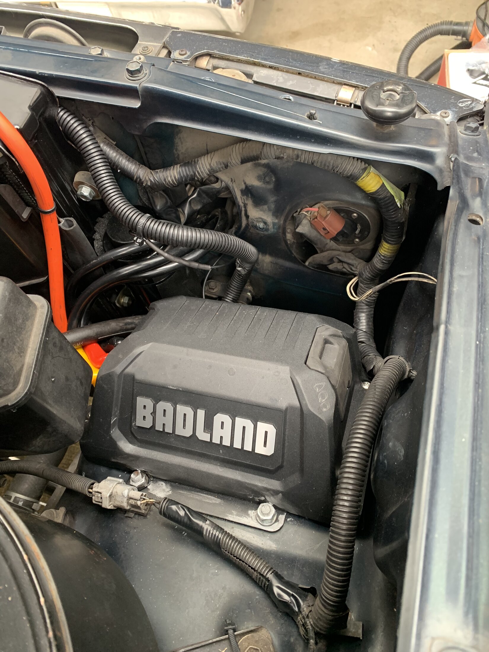

Had to do the control box relocate. Made some room where the overflow and washer bottles go. Not bolted down yet but I think it'll work. I modified the box a little, as it's huge and there's some unnecessary metal that I trimmed away.

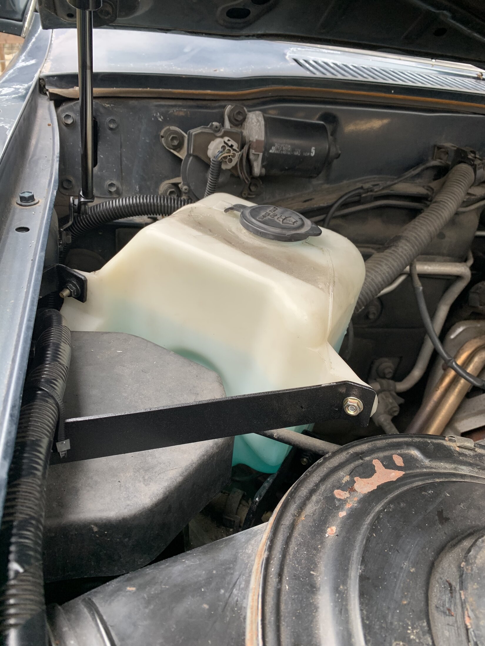

Had to do some relocating around the engine bay to fit the winch controller in there...

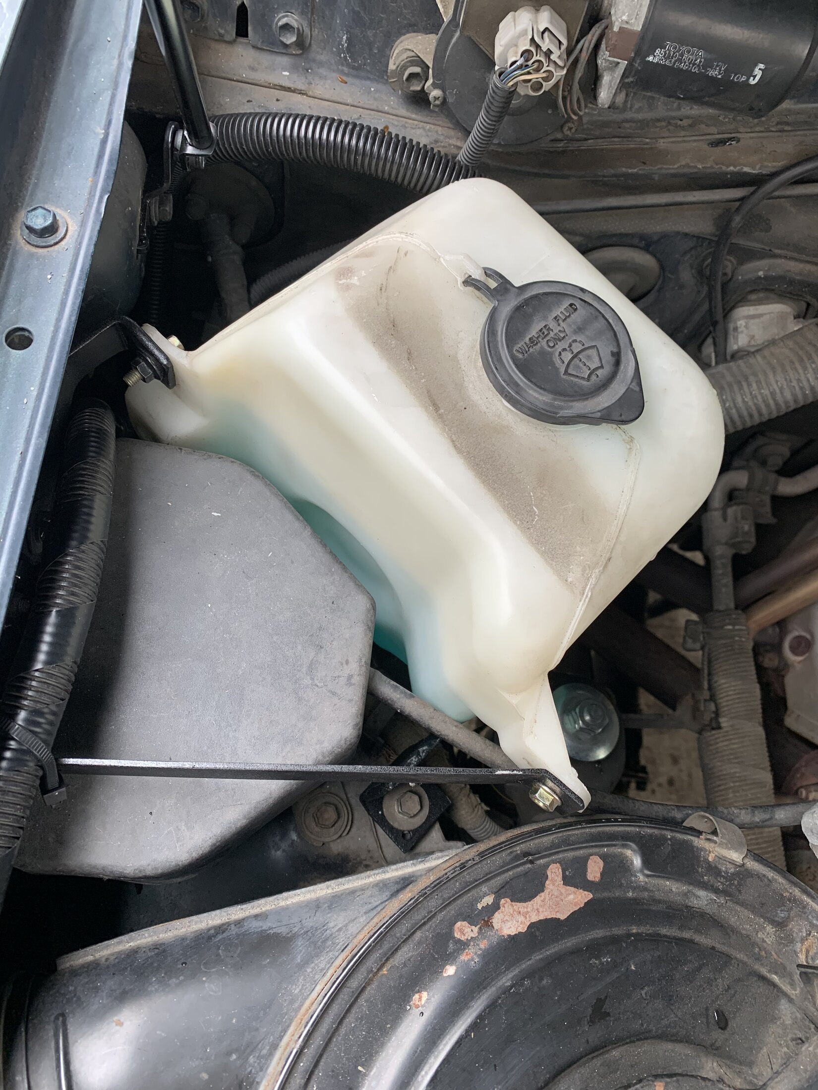

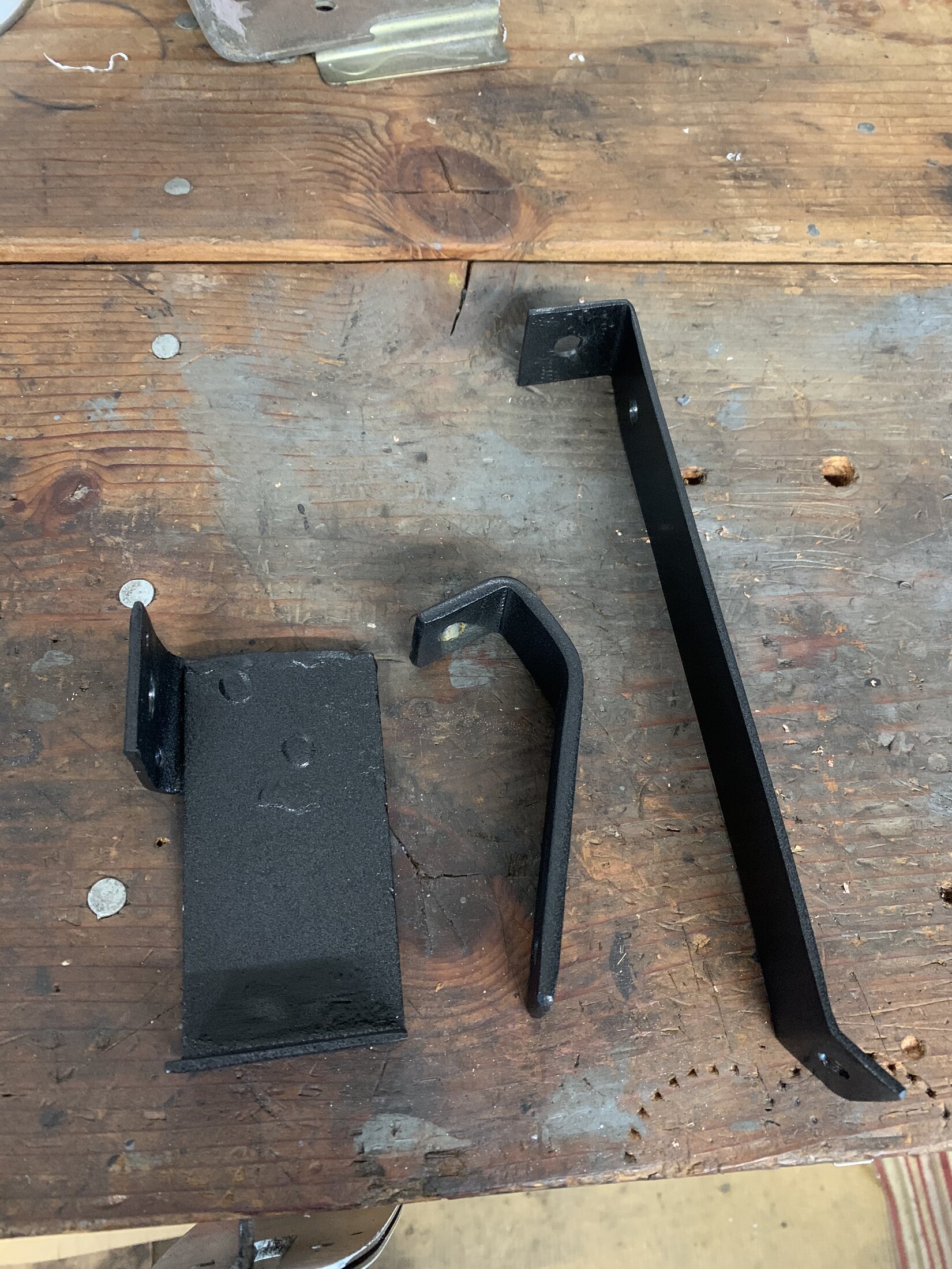

Moved the windshield washer bottle next to the cruise control, home made some brackets. Also bypassed the diverter valve and my squirters work great now.
Swapped out the factory overflow tank for a cheapy slim design one that tucks nicely down by the radiator.

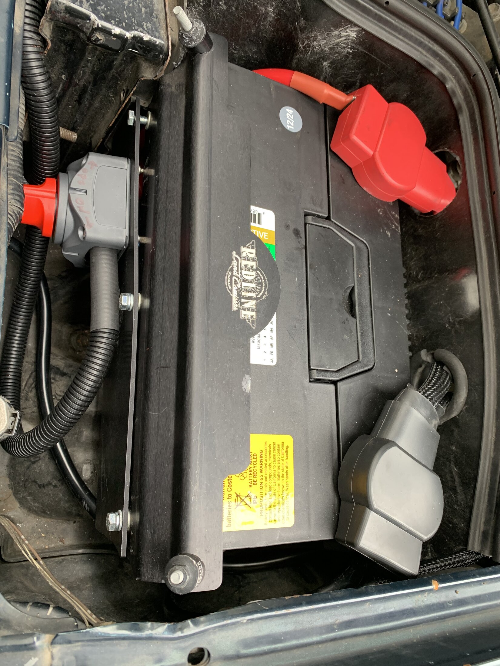

Finished up the winch wiring. Added in a shut off switch.
