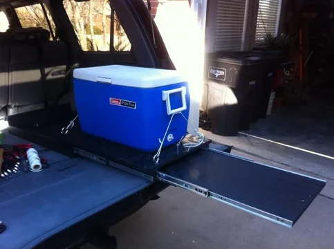

All that is left is to get my fridge back, wire up full time 12v power, and fashion a lock to keep it open. It wants to close on an incline, it may rest on the tailgate once I get the fridge back on there though. Also, thinking about bolting the fridge to the platform from the bottom, but will address later depending how often I take it out of the LX.
no offense intended- just an observation
Ratchet strap over the top of the cooler. There is potential for everything inside to go flying forward, and can be heavy when loaded.
String on the handles is probably not as secure as you might think. I'm being morbid, I guess, but just thinking about a worst case scenario
jmo, nice job on the sliders.:cheers:
No offense taken. There's nothing in it so it's not going anywhere, just put in on there until I get my fridge back. (Plus it's nylon rope, not string ;) ) I may throw a ratchet over the top of the fridge, just not sure how the mounting points would work out. I could install some eye bolts on the slide base towards the seat side, it's blank on the last 8" since I used 22" slides. I would prefer to strap it down to the vehicle though.
I'm leery on how well the fridge will do loaded. I need to go jerk around on the slide real good and see how sturdy the actual slides are when it's closed. I really needed to use 28" slides. I was able to bolt through on the base slide, but not able to on the shelf the fridge rides on, only able to screw the track to the wood. Partly because I didn't think about it and also because the profile of the design won't allow for it. I would have needed to make enough space so that the table slide is not in the same plane as the fridge slide.
I may just put the fridge the SUV only when we need to use it versus full time. My kids ride in that vehicle and I'm definitely not going to risk it if I'm not sure about how secure the unit is. I needed to build this in order to learn what to do and what not to do. I have a feeling I'll probably build something better later on. I'm very confident I can build a heavy duty fridge slide, but not sure how to incorporate the sliding table and keep the low profile.

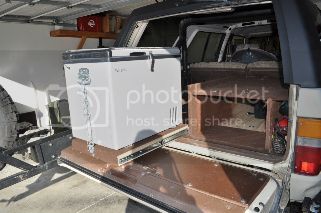

I need to make 1 just like this for my Edgestar fridge & Rainier grill. Did 22" slides fit perfect for your 63qt Edgestar? I can't figure out how much extra length the slides need to be compared to how far they'll need to be slid open. Where in Tx. do you live?
If I had it to do again, I'd get at least 28" slides if it's for an edgestar 63. The clearances are very tight to get my fridge door open with the slide out. I'd go as long as you can on the slide base, it will also allow you to fit a bigger stove table. I live in the west DFW area.
Thanks. Yes it's for an Edgestar 63qt. If I get 28" slides that'll give me an actual 'working' area of 28"? I live just south of D/FW.
My slides are actually about 23.5" long collapsed and I get 24" of travel. (I believe they are labeled as 22" at lowes)
My slide base is 30-31" long, so I could easily fit 28" slides. You might have to check Amazon for anything over 22", the big box stores don't seem to carry bigger.
