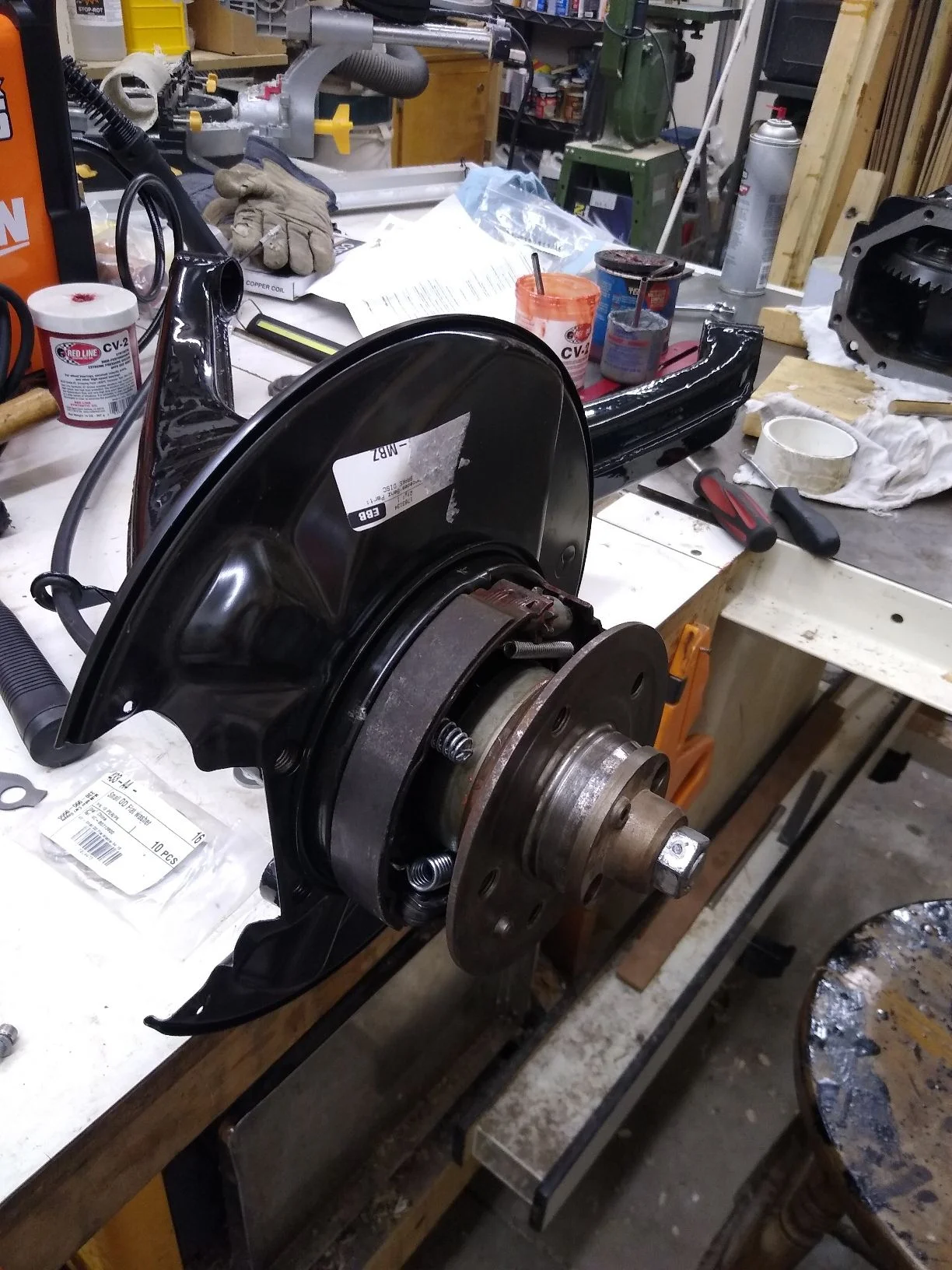

A tool doesn't have to be permanent but can be improvised and temporary. This was cobbled together from some hub I had meant to go on a motor shaft, a crappy Harbor Freight 3/4 drive socket, and the threaded rod from a spring compressor. The Mercedes tool it emulates is meant to change bearings while on the car. Mine is all apart so I could use the shop press but this part is so awkward and I'm working by myself.

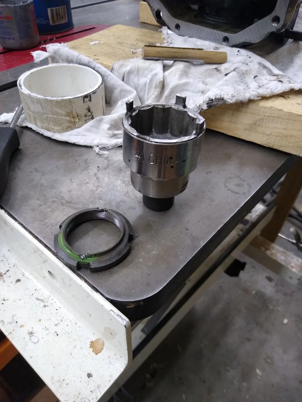

Speaking of that crappy HF socket set....I sacrificed the 41mm to make this Mercedes SST for the locking but on these bearings. The tool is pushing $100 these days for something I will likely only use once. Broke one of the tabs breaking free a nut that had been in place for over 35 years. Hope it holds together for reassembly.
If you hold your tongue just right, that chinesium should be good to go

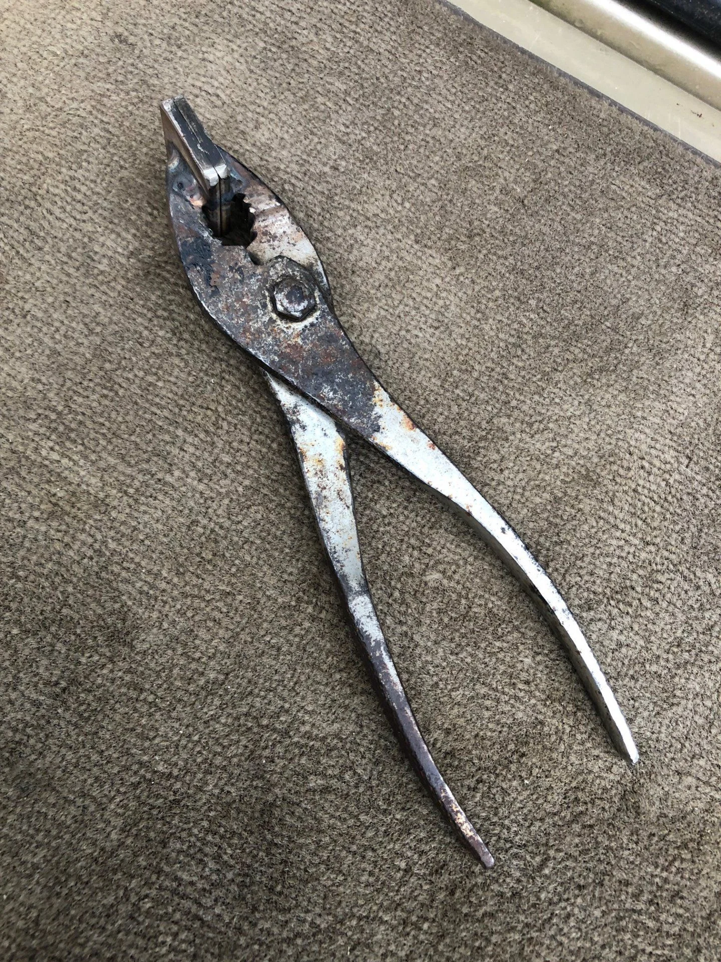

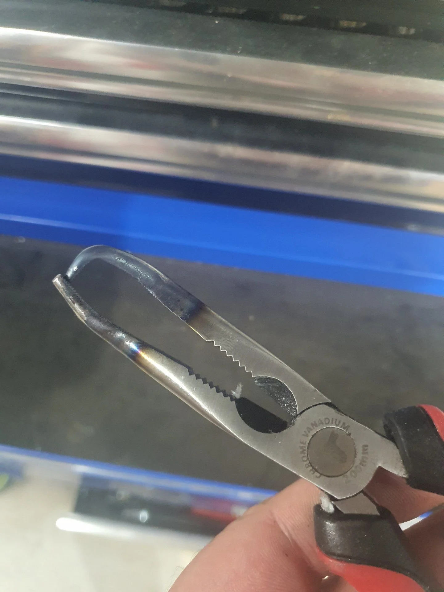

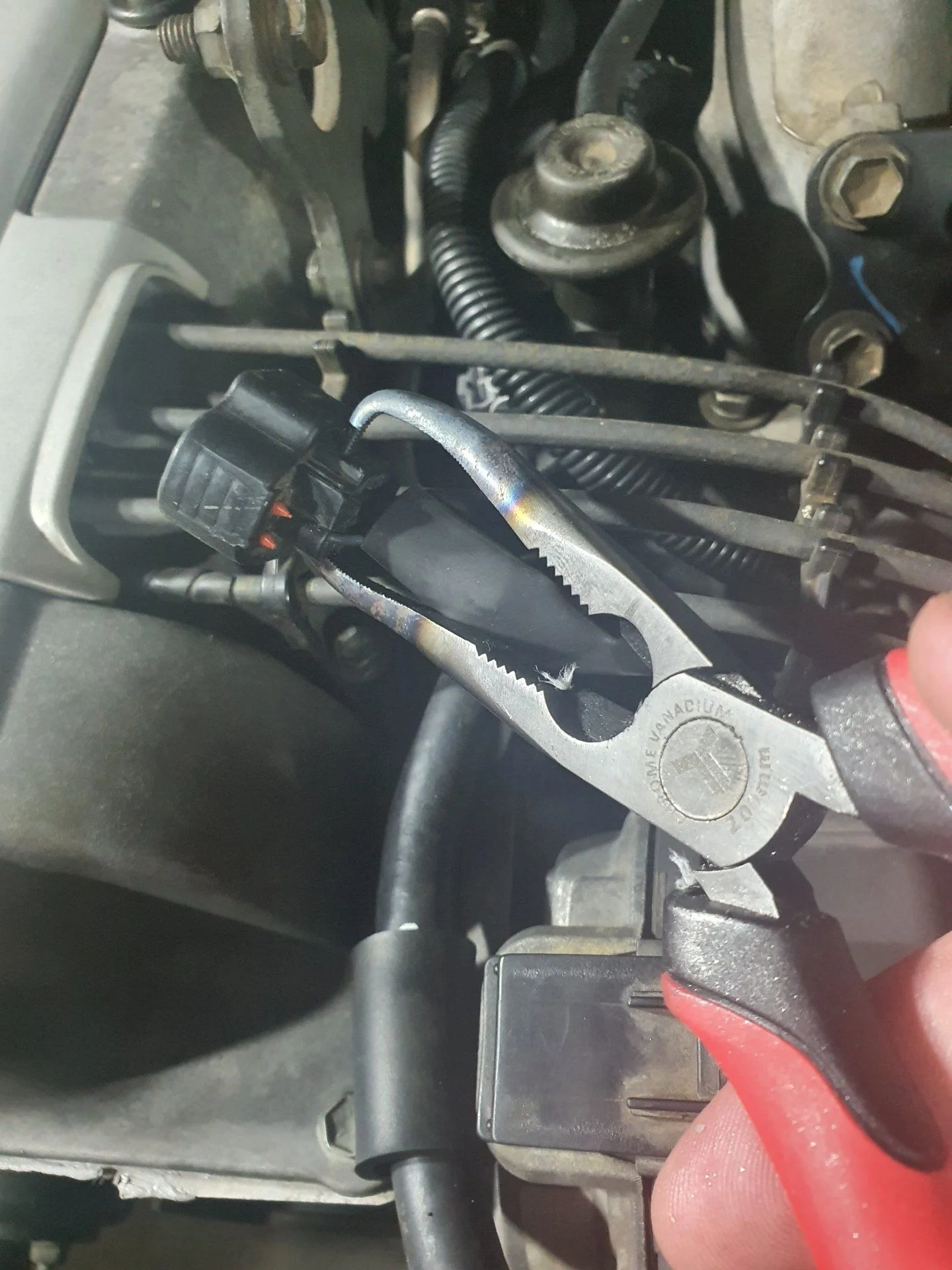

I made a tool for disconnecting harness connectors. $10 pliers, 10 minutes with a gas torch, pliers, grinder, file. Good to go.
It grips the connector by the release tab with the hooked end, and the body of the connector on opposite side.
Offset pliers grip the connector, but stays clear of harness.
Allows you to pull on the connector without pulling on the harness.
Most the harness connector retaining clips work the same way, so this will work for the majority of harness connectors

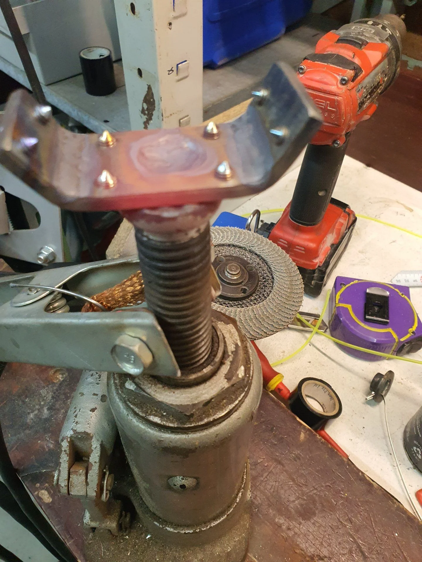

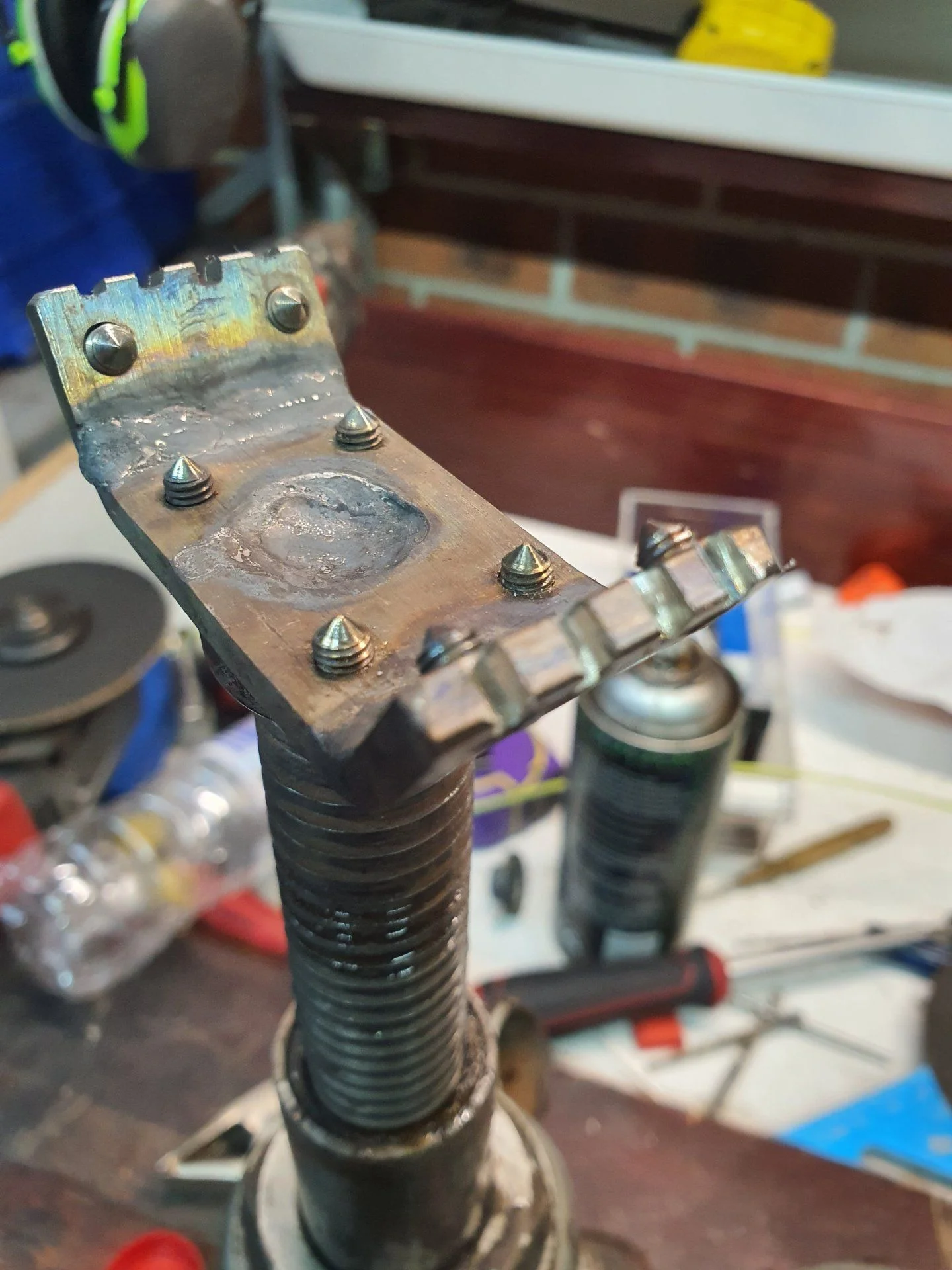

Another tool mod happened today.
Added a cradle to the top of a bottle jack.
I use this jack in the garage to jack up my 80. With the round top, it was a bit sketchy jacking under radius arms or diff housings.
Used a bit of SS flat bar and some pointed grub screws threaded in and tacked in place

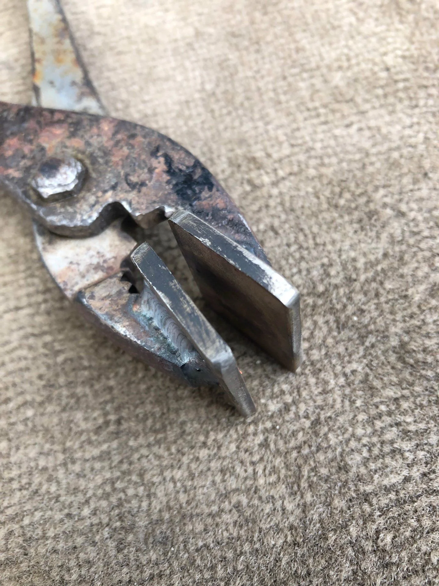

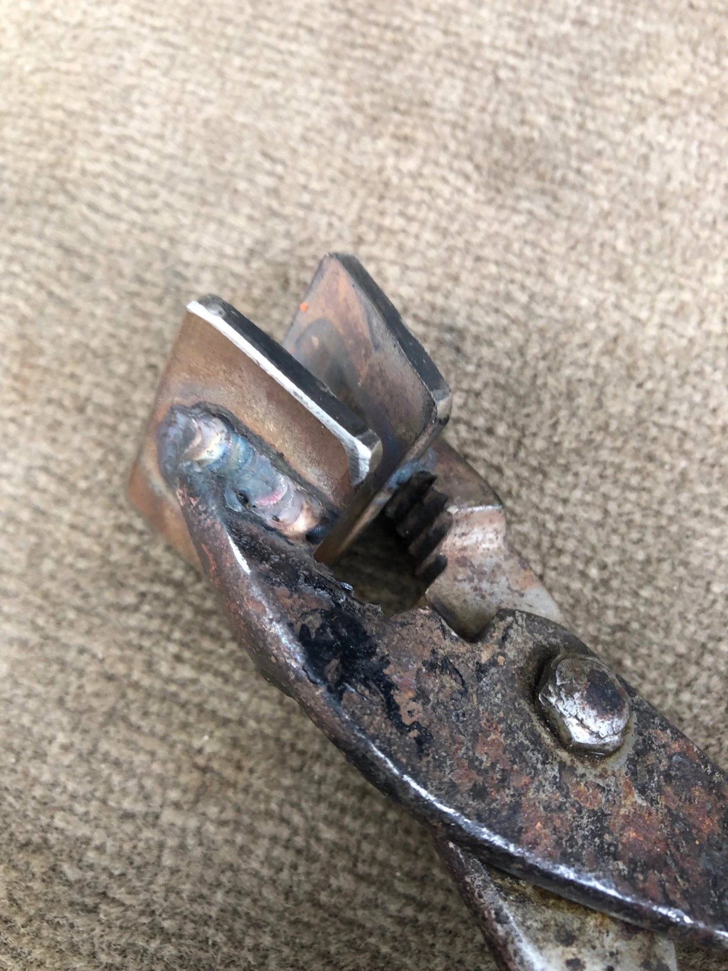

Hose clamp pliers. I had the idea but @nvrlose54 made it happen. I wanted a set of pliers with a wider jaw width for clamping the taps on hose clamps. I tried a set of commercial hose clamp pliers and they were worse than the standard pliers. I expect these to work well.
