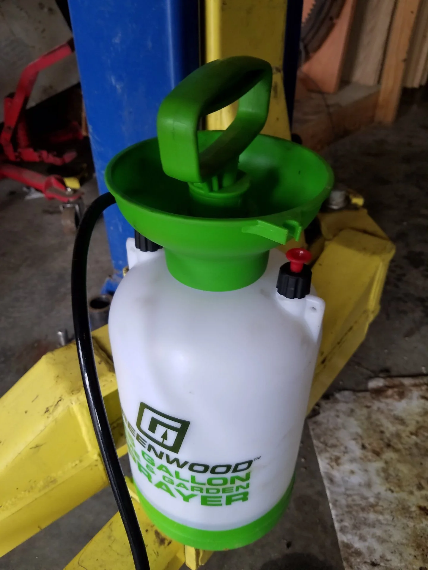

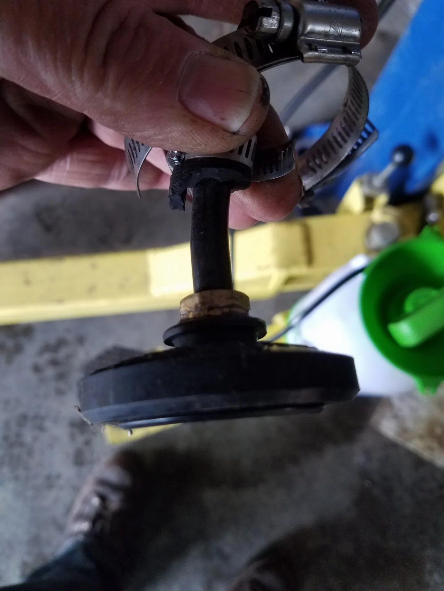

Ok I hear people complaining about getting their brakes bled, and all the difficulties and the need of another person, I bought a small garden sprayer, cut the sprayer handle off, got a 3/16 male threaded nipple, took a new MC cap took the one way valve off, got a small hose clamp to clamp the hose on the nipple. I then got 1 1/4 " hose clamp for the MC cap. It works as good as the $70-$90 units . To use it, dump your favorite flavor brake fluid into the tank, connect it to MC tighten the cap with hose clamp, now pump it up no more than 3-5 pumps, go to the caliper you want and crack the, valve . You have to be careful not to over pressurize the, MC you will have a mess, and when you are done with the bleeding release the air from the sprayer, you need a rag when removing the MC cap after the bleed, because it does add a little more than you need. Enjoy your one man rodeo bleed

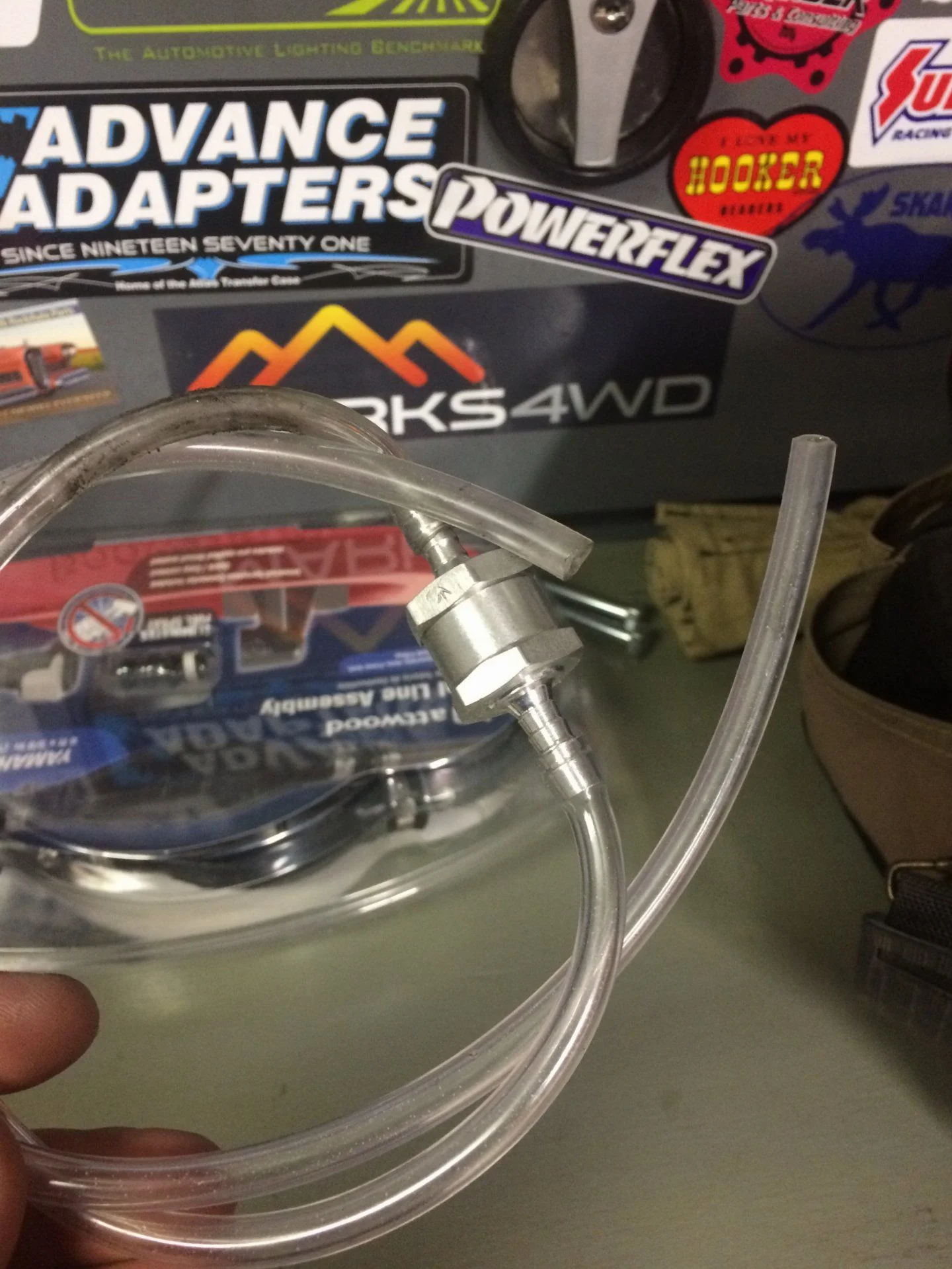

Put a cheap 1-way valve on the hose you connect to the bleed nipple and and watch it ooze as long as you wish while drinking a beer.

This sounds great! I'm having trouble visualizing the garden sprayer part. Can you post pics please?
That's cool for a simple, bleed, but if you did a full system overhaul or like took the body off and swapped a diesel, that molasses, bleed would take a week, and the LVP would still have air, this get's it done in a timely manner, and you can flush the whole system
I agree. I made the exact same apparatus you did. I'm saying I use what I pictured on the brake caliper.
