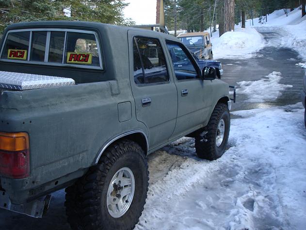

This is the Home made dual cab that I was talking about many months ago. I finally drove by a house and saw it sitting in the front yard. Went and talked with the new owner, and asked him if he would mind if I took some pictures. Interesting idea, but I think the 4runner with back removed looks the best!
Fugly for sure!

Who did this 4Runner build? Are there any pics of the step by step process? We are in the process of buying a 1991 Runner for $250 right now. I have an extra cab for the rear window to go into a runner once it is fabed up enough. I would just like to see some pictures if they are available.
