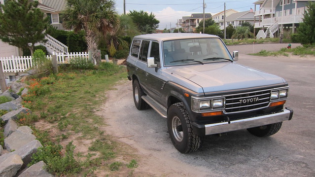

This thread is for me to share my rig and keep track of my first Land Cruiser journey. They story began in high school when I first discovered classic 4x4s through Defender 110s, RRCs, and FJ60/62s. I have been searching on and off since 2011 but I finally took the leap and bought a really nice example of a 1988 FJ62. I wanted to find a truck with some of the creature comforts of a more modern truck while retaining the classic look I desired. I am going to be moving into an apartment soon and won't have access to a garage or tools so I opted for a more sorted truck with meticulous records, all stock parts included, and most of the large items I was looking for already installed. As they say in the BMW community I previously was apart of, Bought Not Built. This truck is going to be my new daily driver and I wanted to get one that would be reliable, capable, and ready to cruise (pun intended). I also needed an automatic and I preferred the fuel injection for my daily driver. I also have a 1969 Datsun 2000 fairlady to fulfill my manual, carbureted hooning. Although that may see an SR20 swap sooner rather than later due to the Land Cruiser being so darn slow. Anyway, I bought the truck in Austin, Texas and drove it home over the course of 2 days back to North Carolina. The truck performed exceptionally the entire way and I averaged 12 MPG. Luckily, or unluckily, it decided to wait until my second day home to blow a fan belt and reaffirm my decision to buy AAA. I have been slowly baselining the truck to make sure it is ready for daily duty and I have a front knuckle rebuild kit on the way.
The modifications are as follows;
-2in OME lift (Australian version)
-OME shocks and steering stabilizer
-Custom Warren Auto/Manual locking hubs
-Centerline 9.5" x 15" wheels
-Falken 33x12.5x15 Rocky Mountain ATS Tires
-Disc brakes from Spectre Off Road
-Mean Green high torque starter
-Mean Green high output alternator
-Marlin Crawler transmission upgrade
-Auxiliary transmission cooler
-Custom catback exhaust
-R134a conversion
-Man-a-Fre running boards

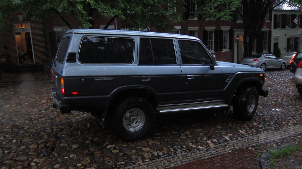

This week was a big time for the 62. I replaced a started on the side of the road in downtown DC in the rain (with an unhappy girlfriend in the front seat), removed the horrible 'period correct' Ungo alarm, and fussed with some grounding issues. I am hoping that the removal of that darn alarm will alleviate some of the electrical gremlins I've been chasing. I also took some new pictures and videos of my truck on some old cobblestone roads in Alexandria, VA.

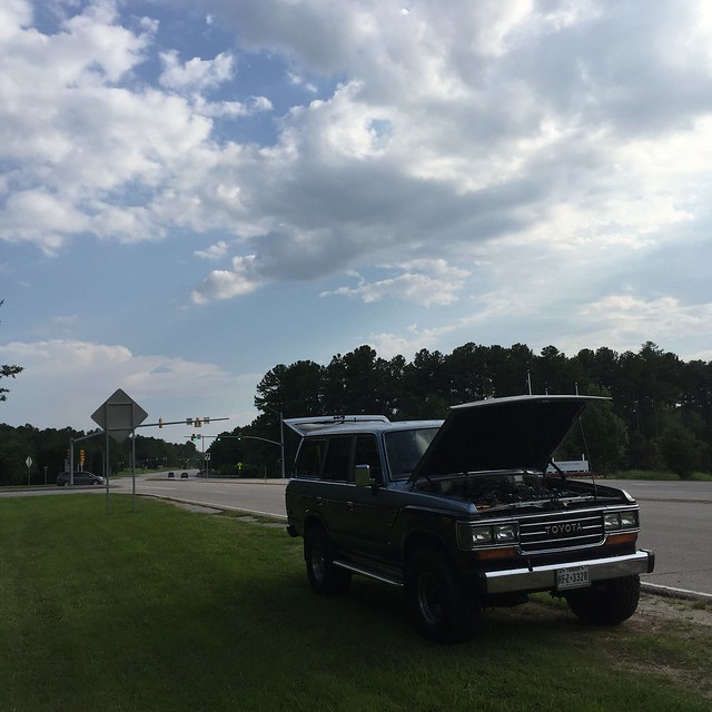

The latest adventure happened while picking the girlfriend up at the airport at midnight in DC. I was having intermittent battery/alternator charging issues but decided to make the short drive to the airport. While sitting in the cell lot, my headlights started to dim and I made the fatal mistake of turning the truck off to preserve battery. When I got the call from the girlfriend, the truck wouldn't start and I booked her a uber home. I proceeded to knock on door after door to find jumper cables (I should order some of those) and a young army officer came to my rescue after about 15 minutes. I had to limp the truck home at midnight with no headlights to make it back home. I later discovered the broken battery terminal was the problem and it was not completing the circuit to the Alternator.
