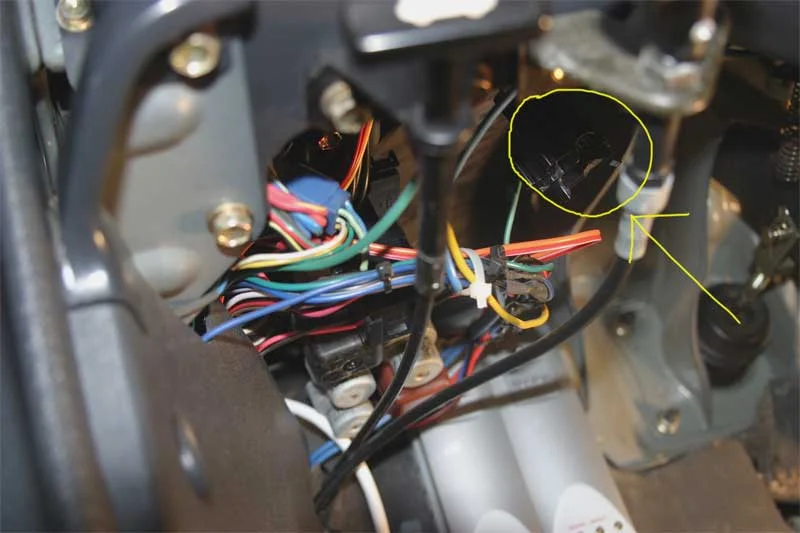

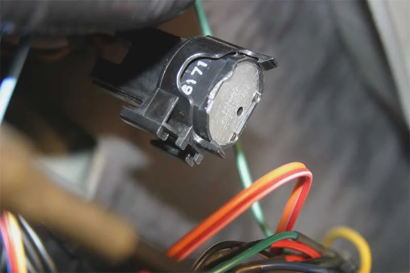

Do your door locks not work on your FJ62?
Try resetting the circuit breaker. Use a paperclip and insert into the hole on the silver top of the breaker. It will "Click", then it is reset.
It's located right around the other relays and electrical stuff behind your fuse box and the hood release.

This will be for when they don't work at all. The circuit breaker will turn the entire system off if it needs to be reset.
