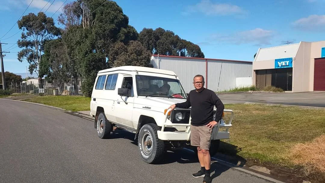

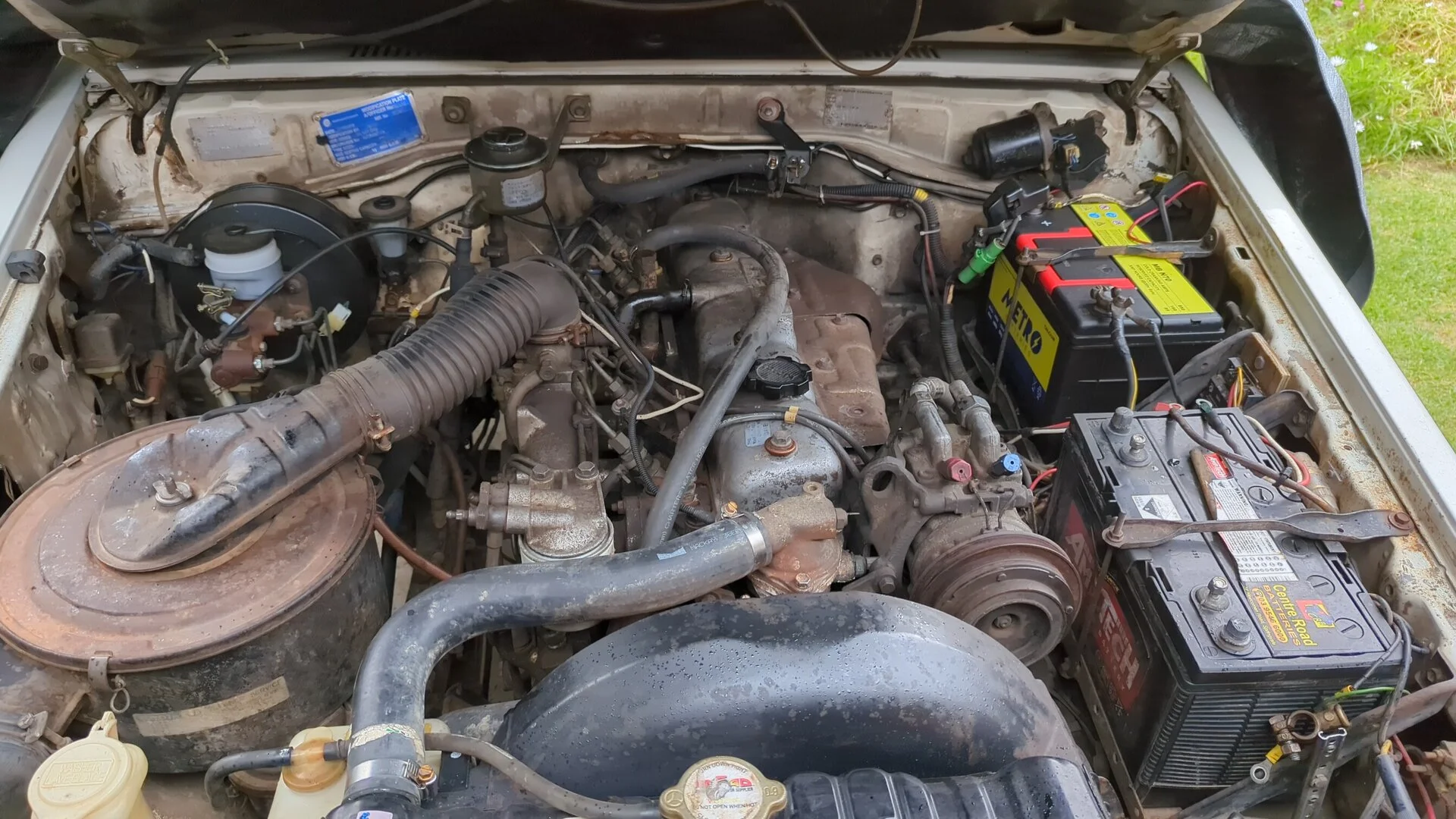

Got this 2 weeks ago. Original Trakka fitout (Oz) with unmolested 2H engine. Happy days!

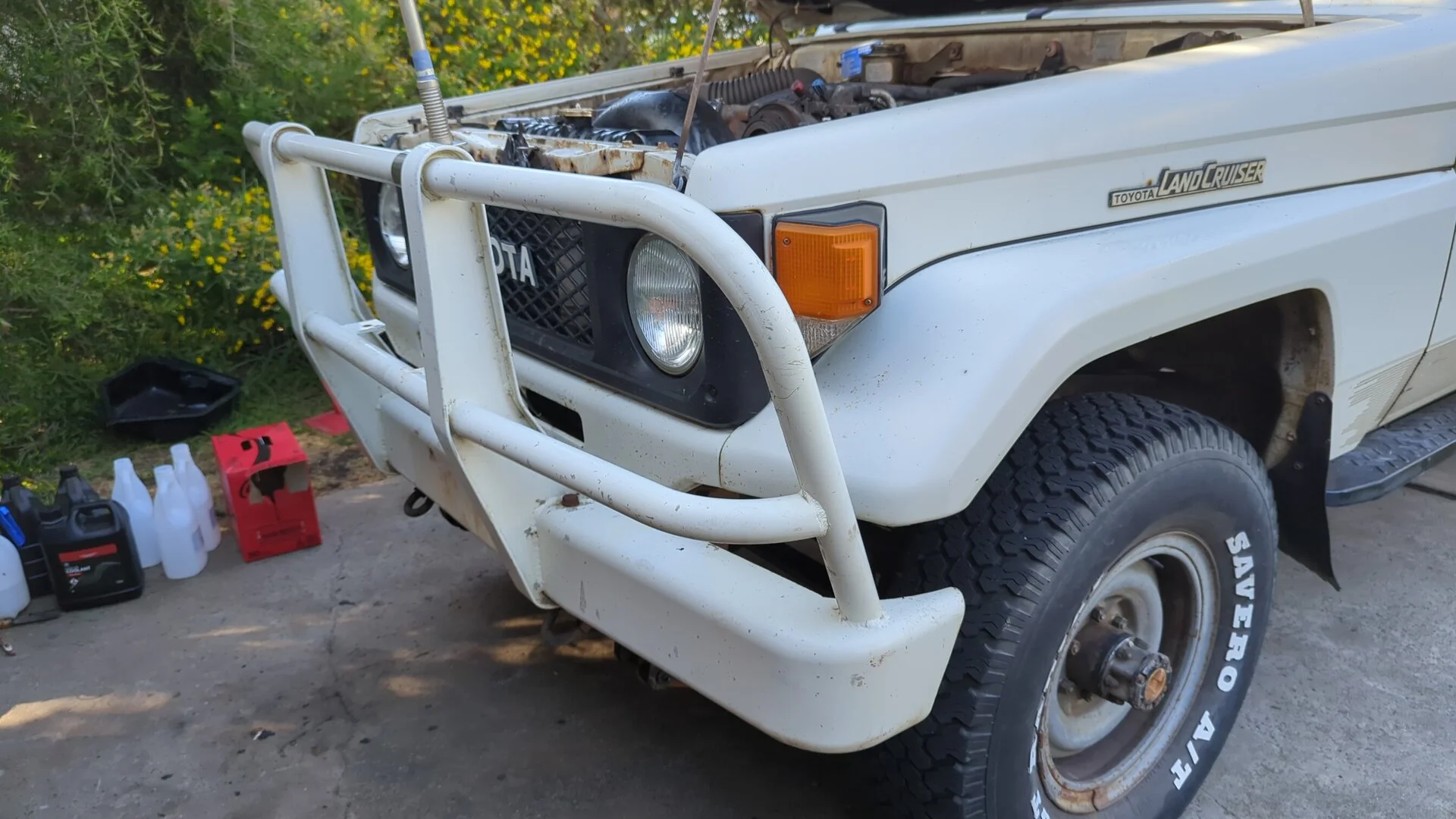

Also test fitting the rear bumber from 76 series.

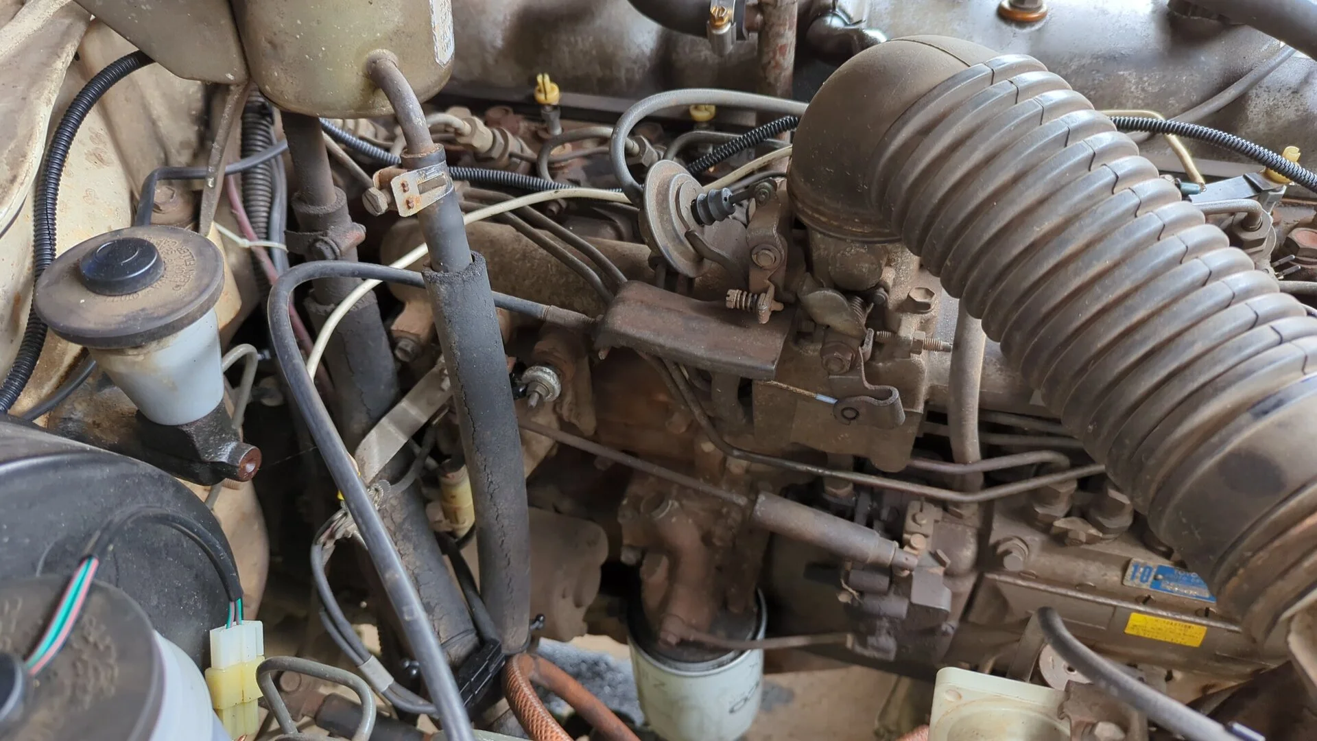

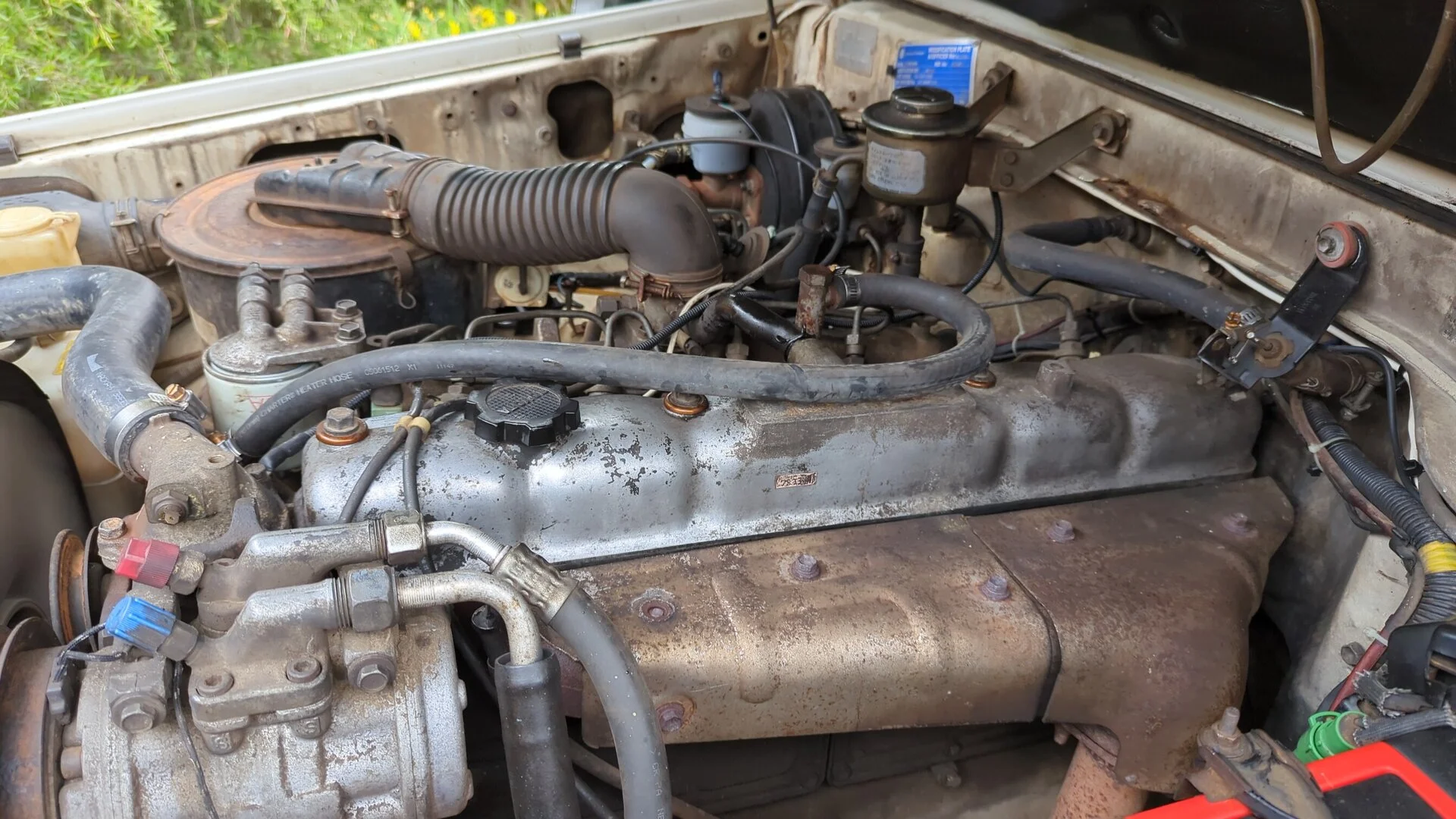

Does anyone know what this connector is?

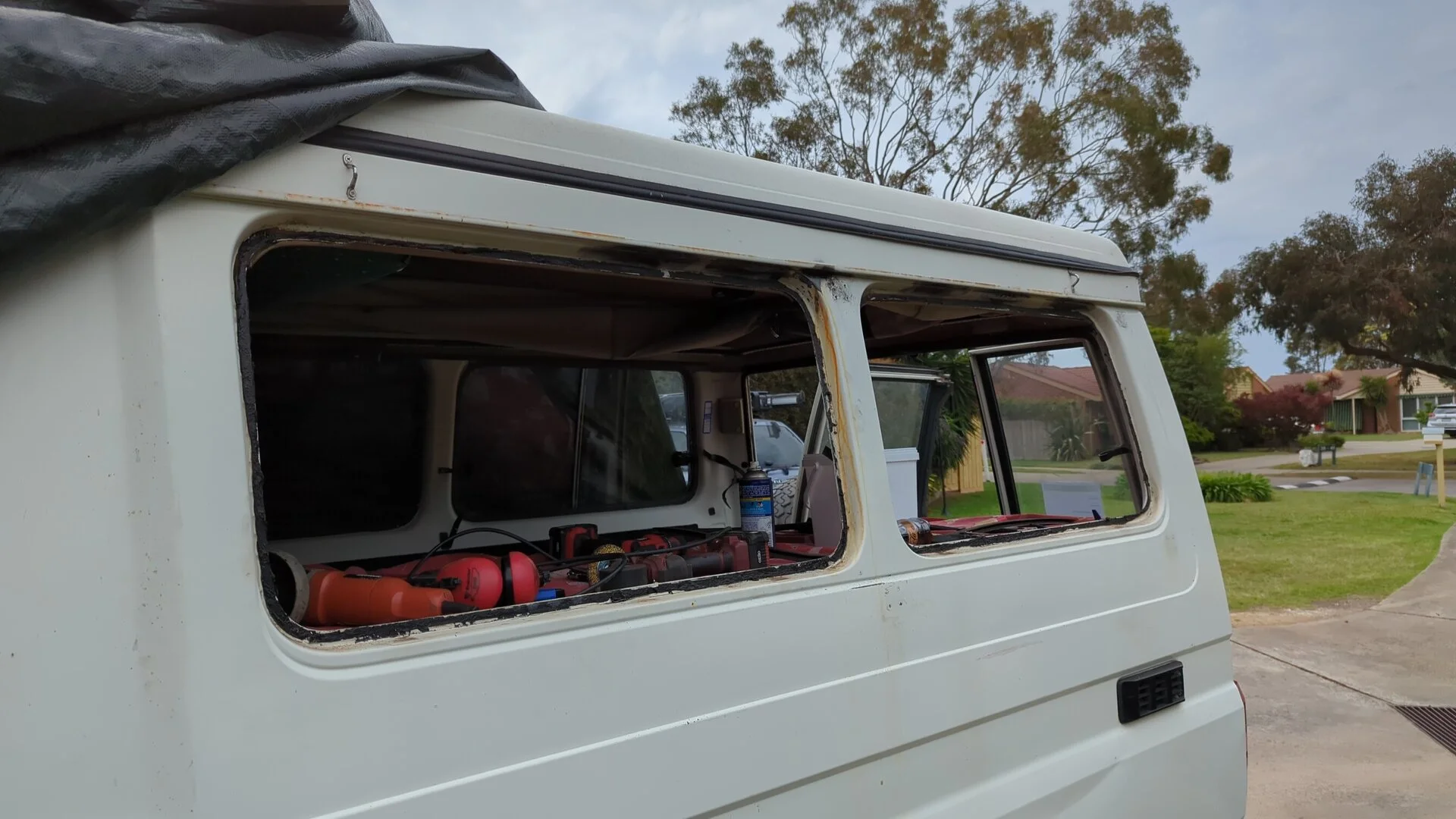

What's with the ventilation louvers on the right rear quarter panel?
I have no idea really!
Will take it off one of these days and look

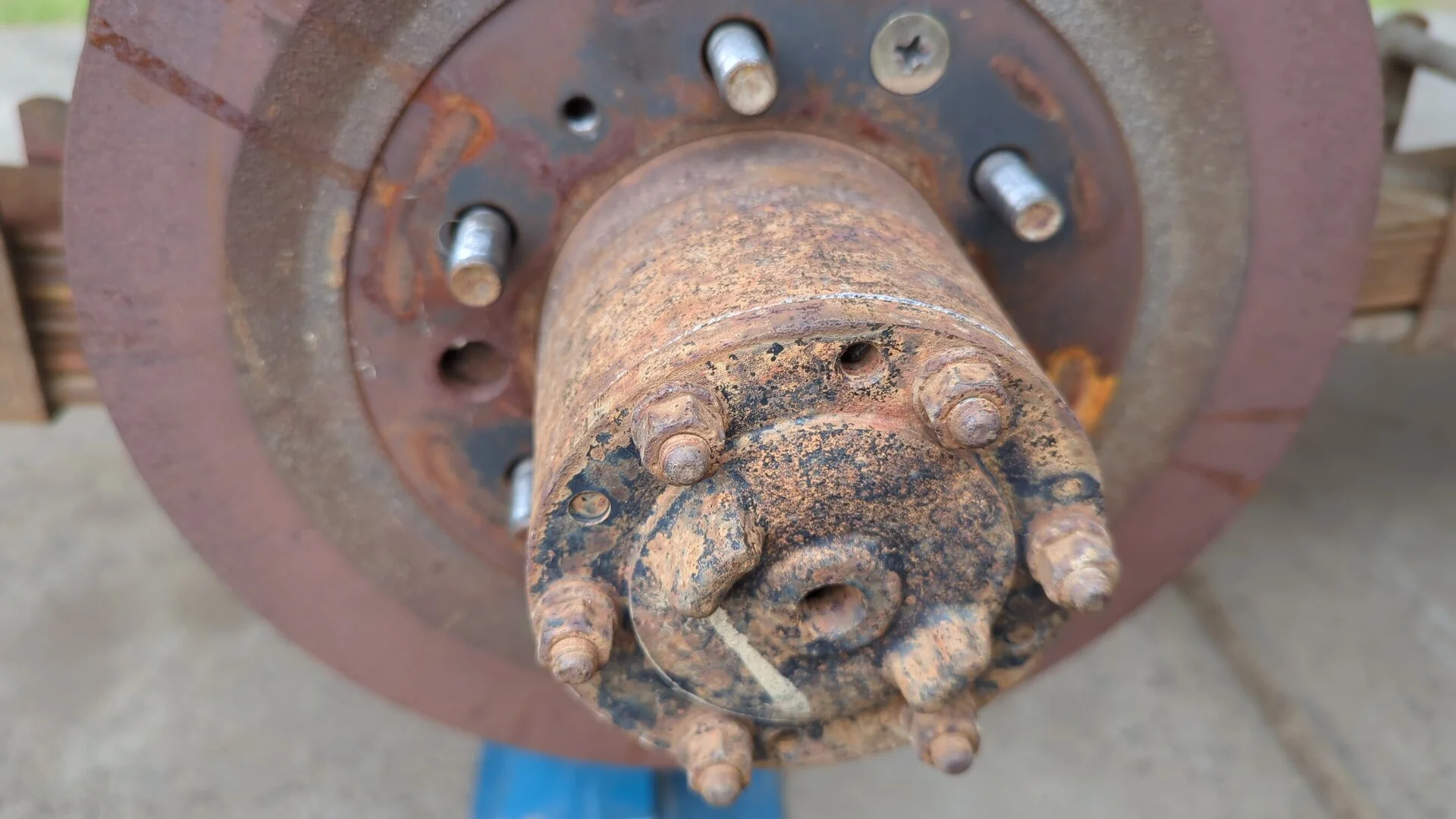

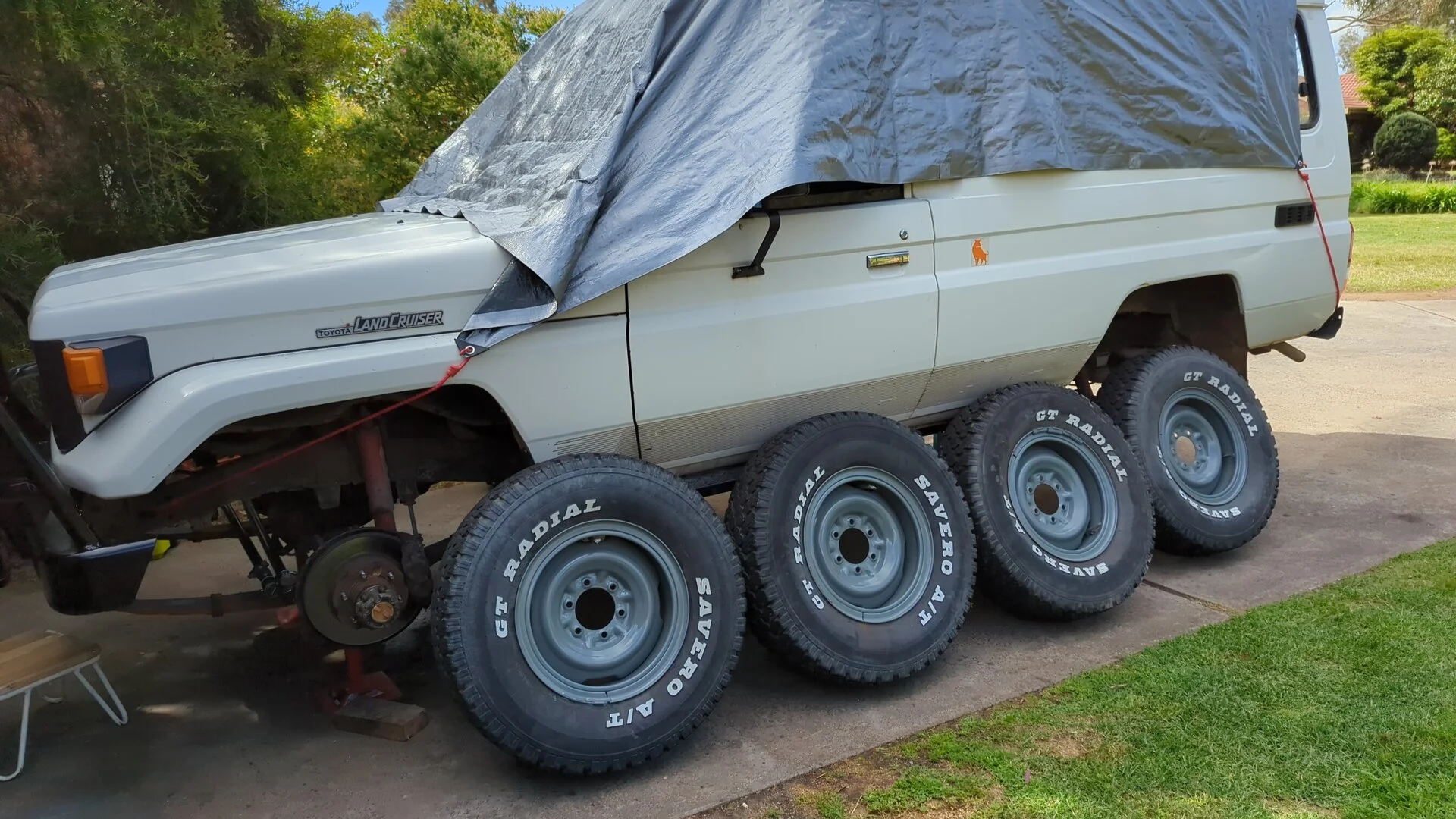

More wheel painting. After some thinking I will keep these split rims and not put bog tyres etc
Found out to paint 4 rims you need 2 decks of cards!

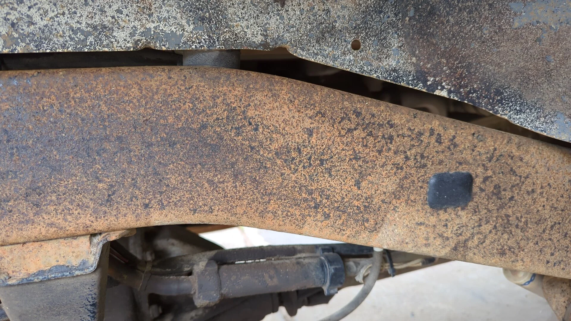

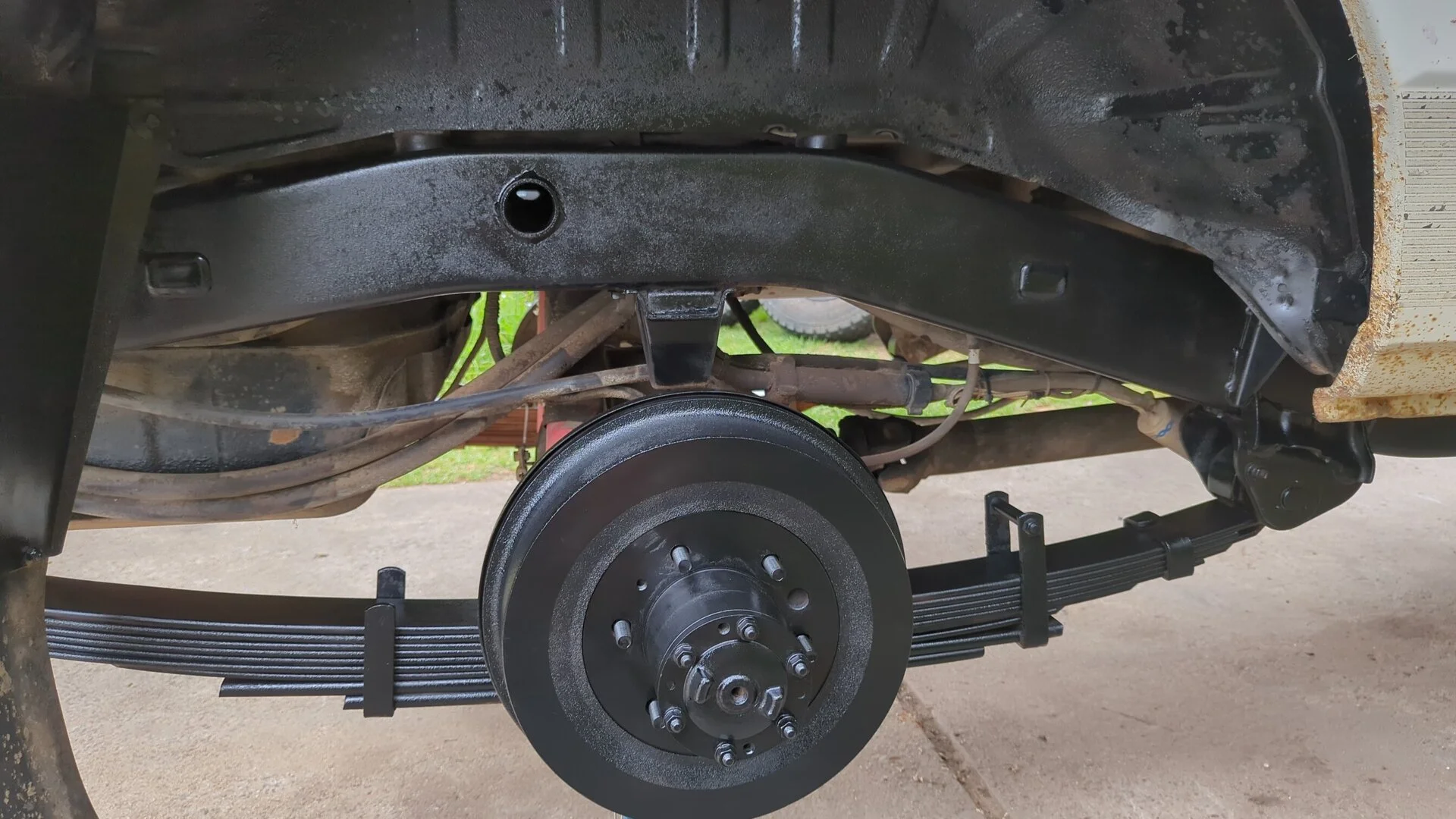

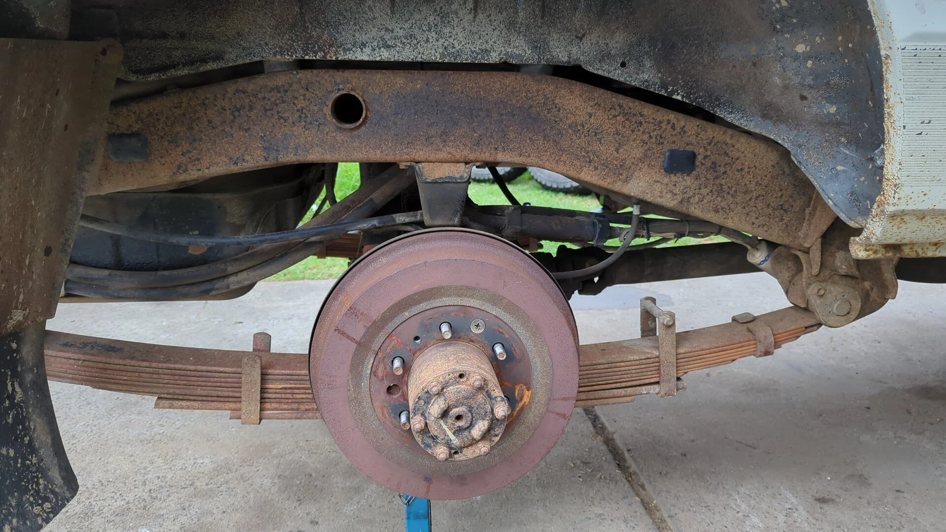

Starting to do the chassis, bad surface rust.
Quick wire brush and then soak with rust converter
Then coat with Black Cold Galvanising paint
Indeed they were just surface rust and mostly baked mud. I had to be careful when buying old cars here as the authority hates any sight of rust.
I use local products which are cheap but same thing are available from global brands like rustoleum or CRC
Rust converter:
Black Zinc cold galvanising paint. I wasn't sure what to spray my chassis with and had been considering raptor or chassis paint. But when I tried the Cold Gal it finished as nice deep satin black and was very tough. I sprayed a bit and left it for a week. Then tried to wire-brush it... couldnt!

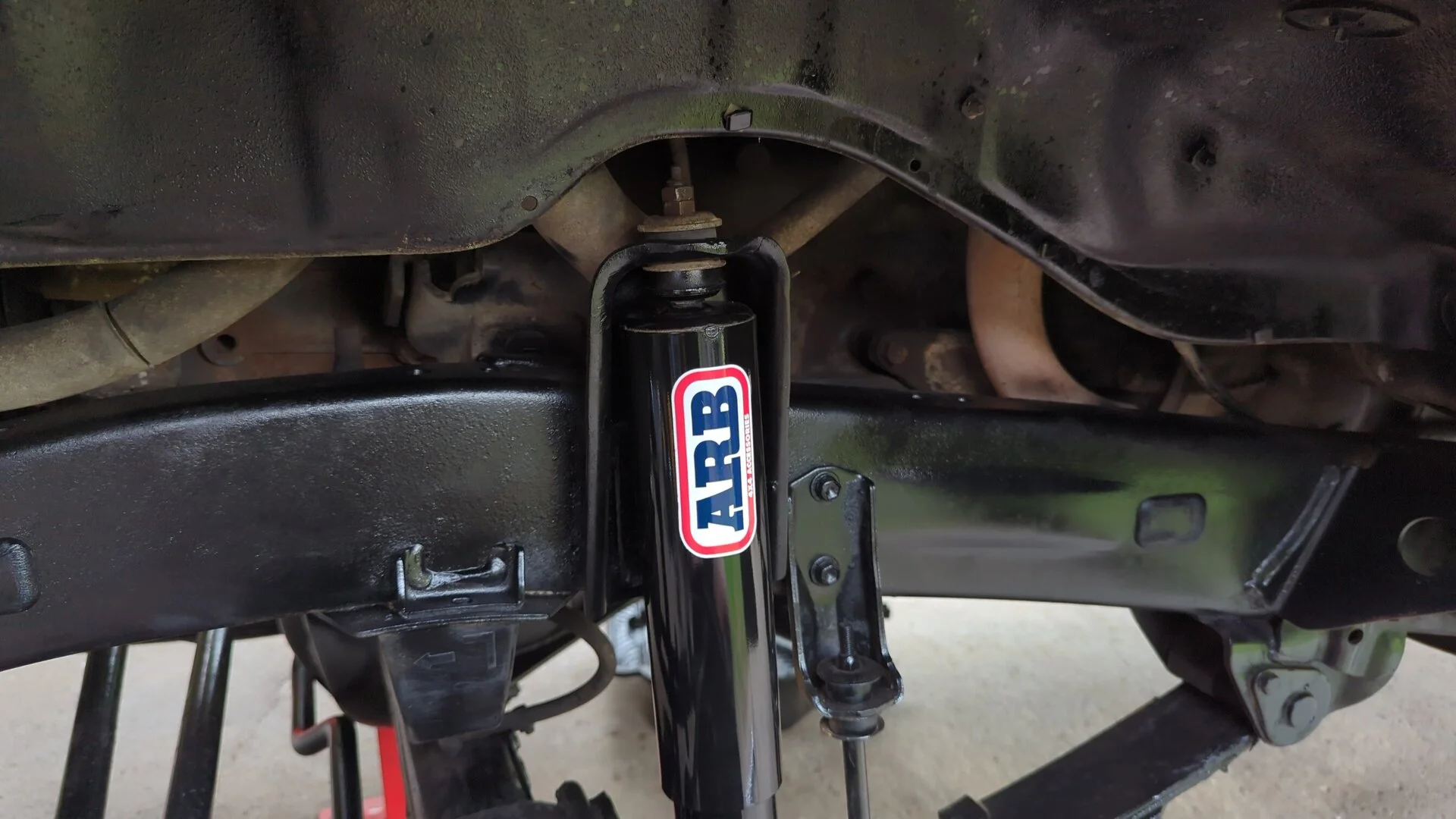

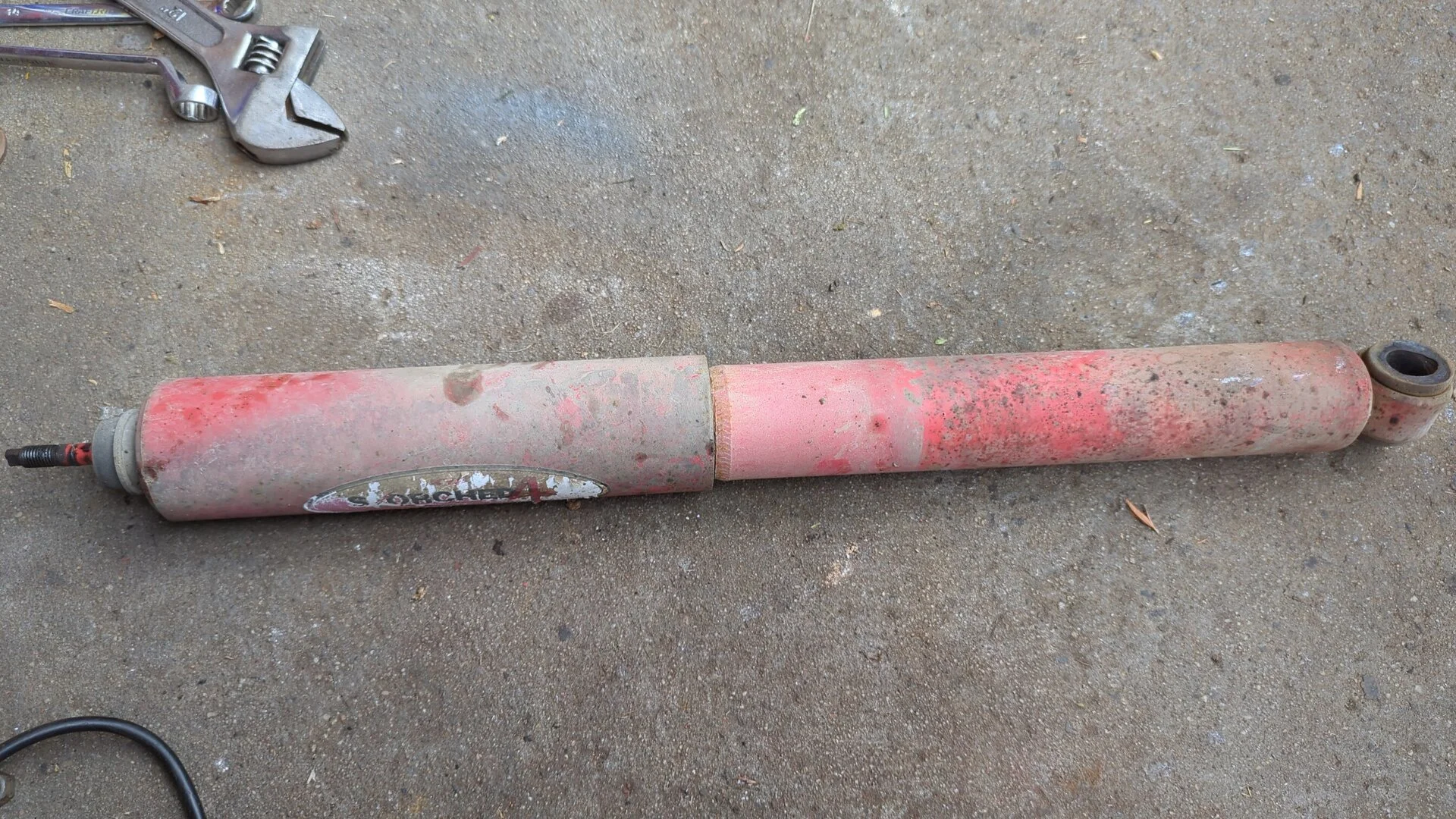

For the Diff I will use normal Enamel black to maintain a glossy factory look. I tried it on the shocks and it gives nice thick coverage. But takes a really long time to dry
