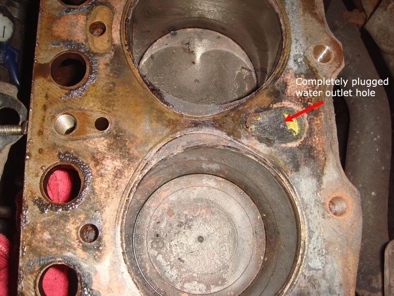

Overheating is not always caused by bad fan clutches, clogged radiators or malfunctioning thermostats.
The water inlet openings at the junction of the head gasket on the head and block can plug up with a clay like gummy substance that blocks the water flow completely. The slightly ferrous "clay" can grow over time and can seal off coolant openings on the block and head completely.. blocking the flow of coolant to the head.
[Edit - The plugged coolant opening shown below developed in only 5 years.]
